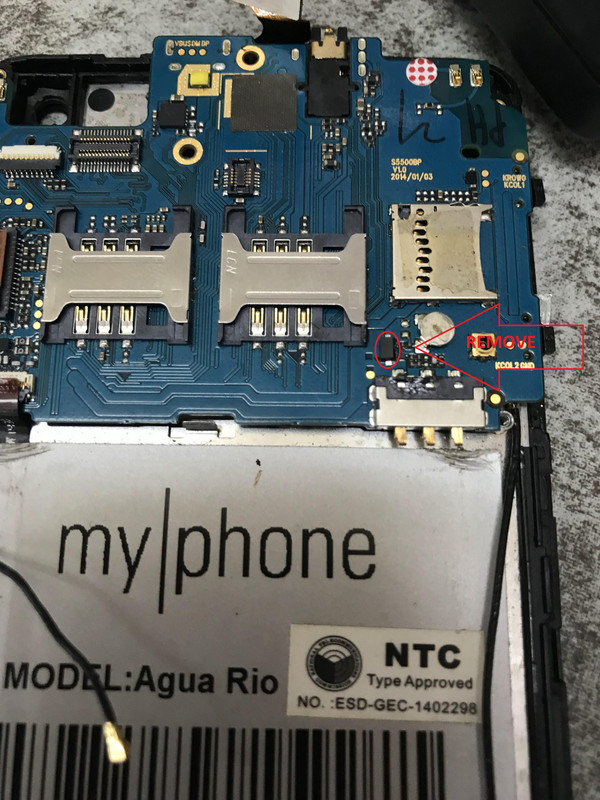

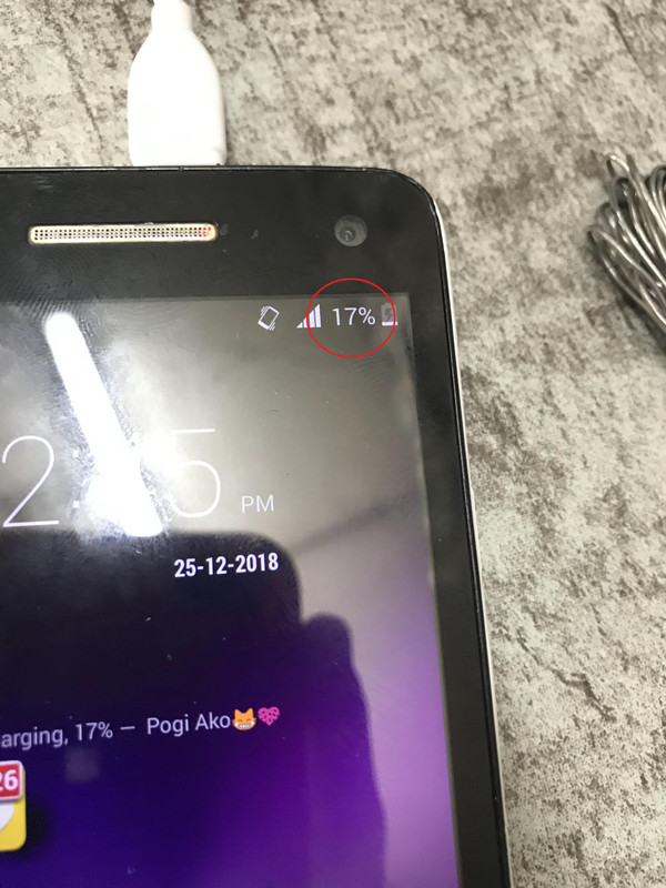

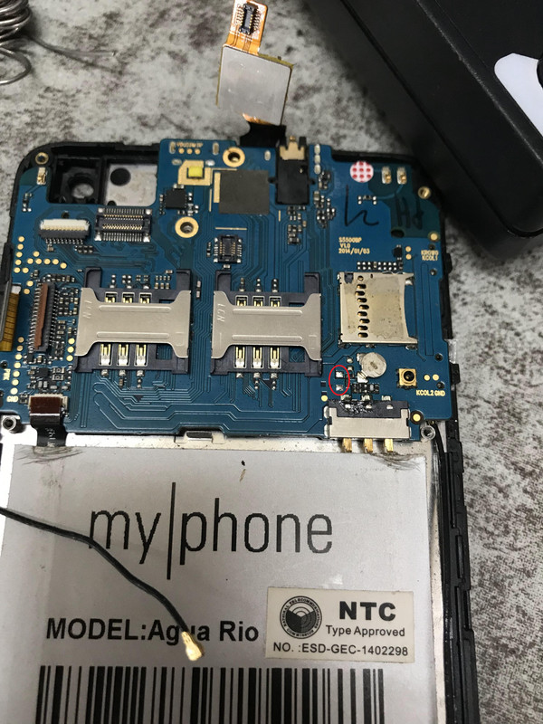

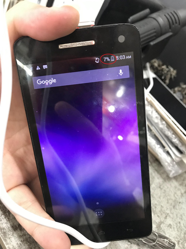

HISTORY: MARAMI NANG PINANGGALINGAN NA SHOP BOARD NA DAW SIRA KC KAHIT
ILANG BESES NILA PINALITAN AYAW PA DIN MAG CHARGE
ACTION: SINILIP KO AT MUKHANG OK NMN LINYA AT BAGONG BAGO UNG PIN KAYA
D NA AKO NAG DALAWANG ISIP NA TANGGALIN UNG DIODE NA MALAPIT SA
BATTERY TIRMINAL AT D NMN PO AKO NABIGO NAG SUCCES NMN..
