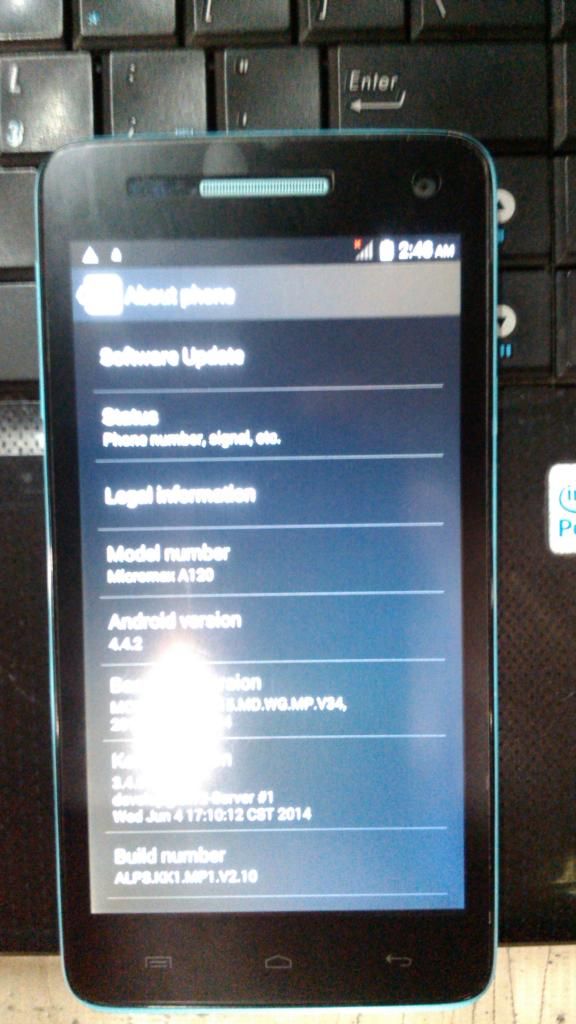

myphone agua rio v1 update to kitkat 4.4.2
procedure
1.download firmware Micromax Canvas 2 Colours A120
2.dowload latest SP flash tool and mtk usb driver
3.open SP flash tool

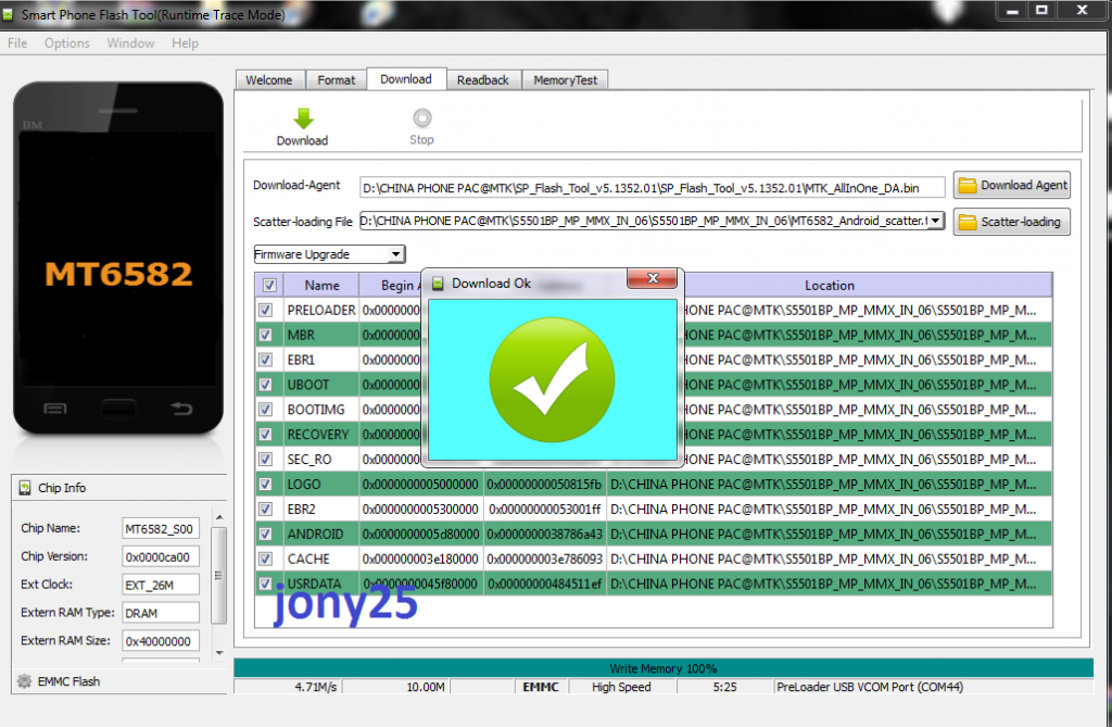

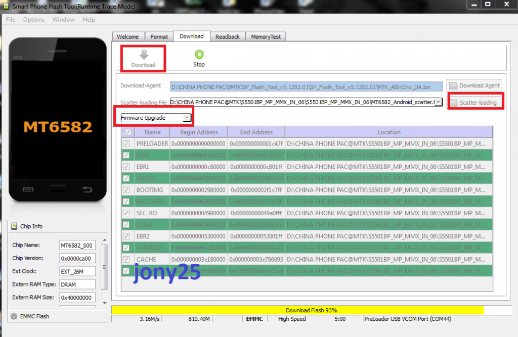

4.click scatter file
5.set firmware/upgrade
6.click download

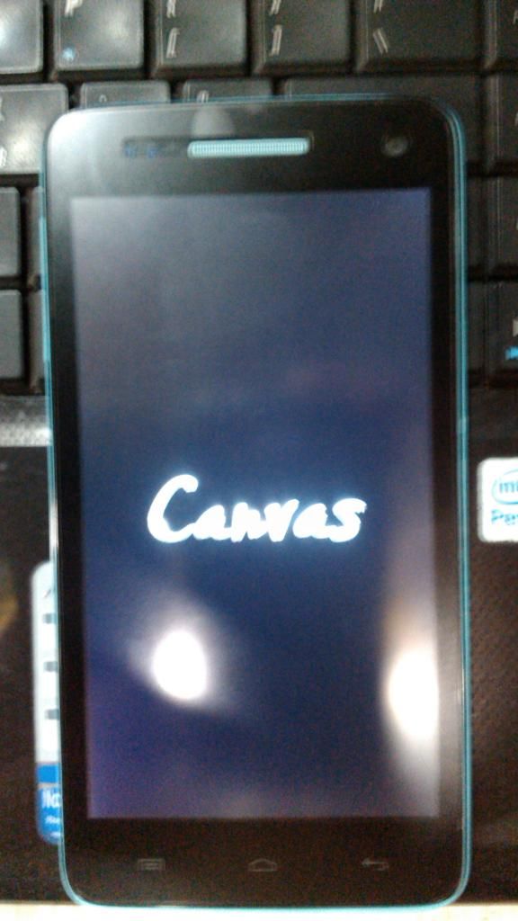

7.wait until finish flashing
8.done..............
follow screenshot
finish
