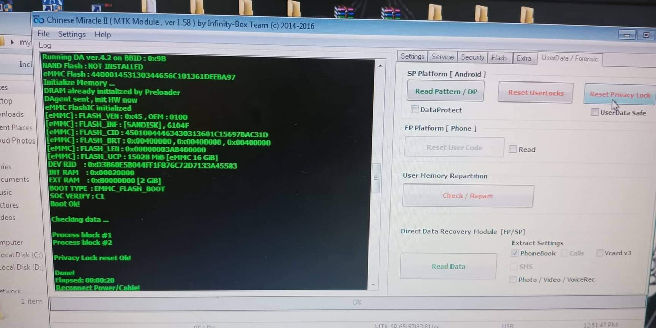

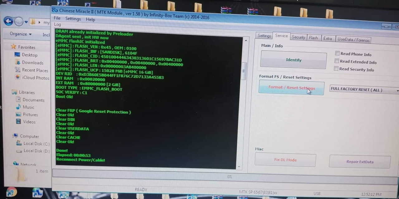

ACTION:
OPEN CM2 MTK...
BACK UP KO MUNA BEFORE RESET..
TAPOS MA BACK UP SELECT FORMAT/RESET SETTINGS...
PERO MY PRIVACY PARIN...SORRY WALANG PIC D KU NA KUNAN...
BALIK ULIT SA CM2 SELECT RESET LOCK PRIVACY ...
YUN WALA NA SI PASSWORD TANGGAL NA..
PACENXA PO WALANG PIC NAG MAMADALI KASI C COSTUMER...

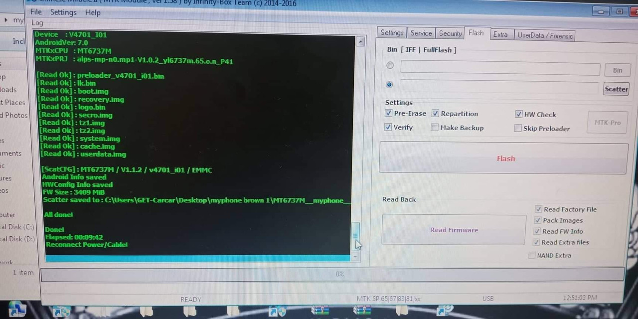

ITO PO FW...
https://www.4shared.com/rar/sdOkPH3-da/MT6737M__myphone__brown_1__V47.html
MY PASS PO YAN TATSULOK NLNG PO...MARAMING SALAMAT PO...
