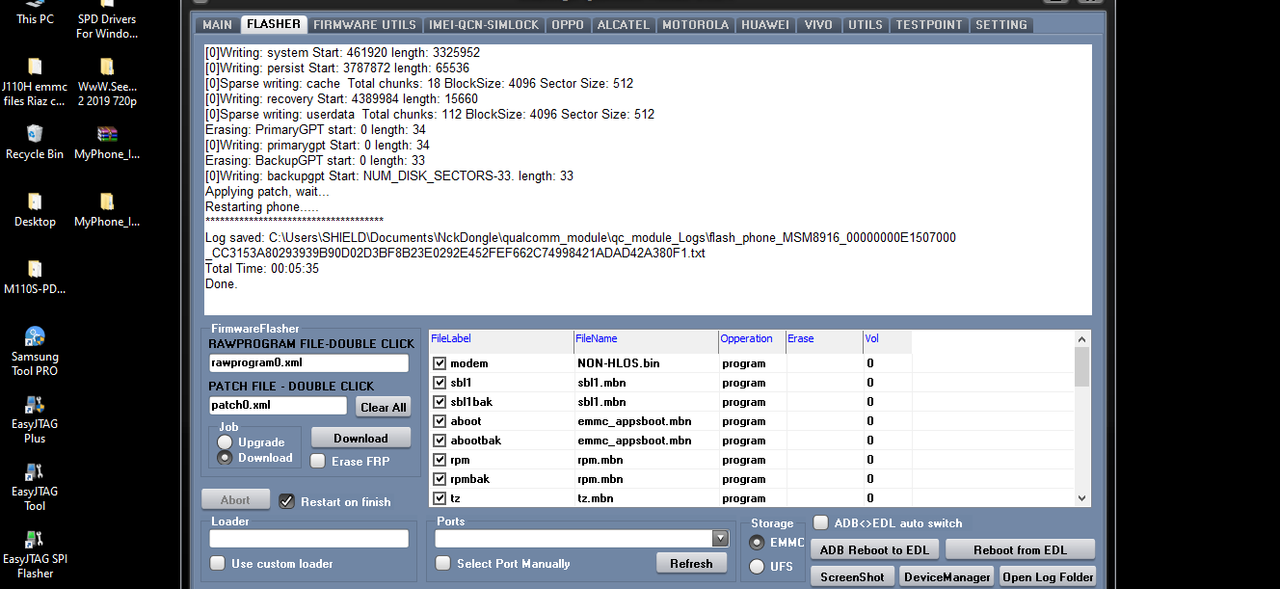

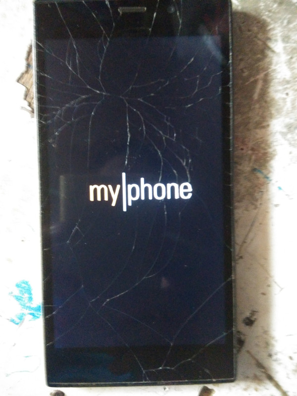

Hello...share ko po itong myphone infinity LTE problem "Logo" Only
try ko format sa cm2 no good kya try ko sa nckdongle flashing at success naman...
step 1. Open nck dongle/box qualcom
step 2. Load files for flashing in flasher tab area.
step 3. Use EDL cable or hold vol+ and vol-.
back-up files credits sa ngupload ng files....Thanks!!

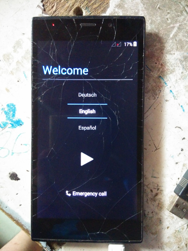

Infinity LTE Good Backup...
DONE...............
