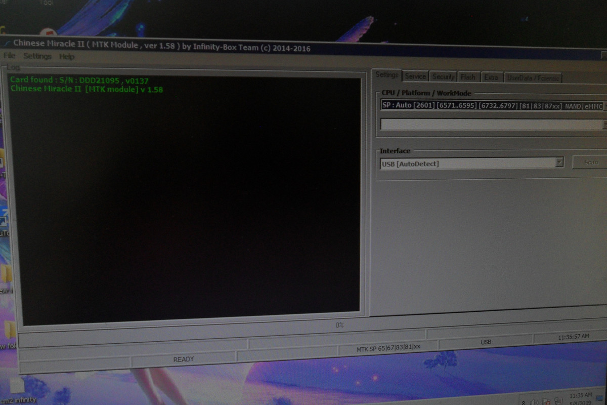

open cm2 mtk 1.59
sundan lang ang procedure
tick mtk chips
tick service
tick format
hold volume down salpak usb cord

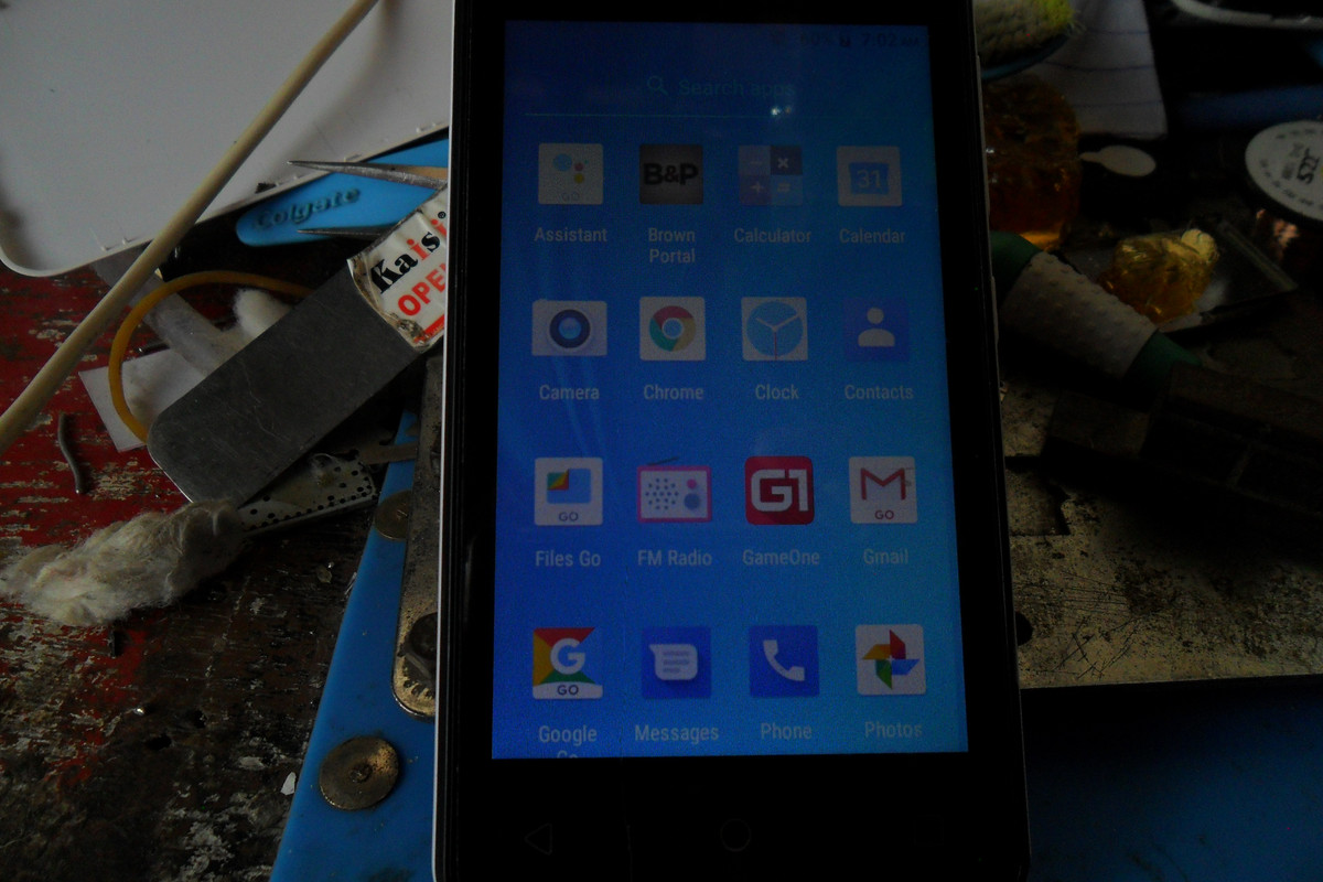

open ang phone

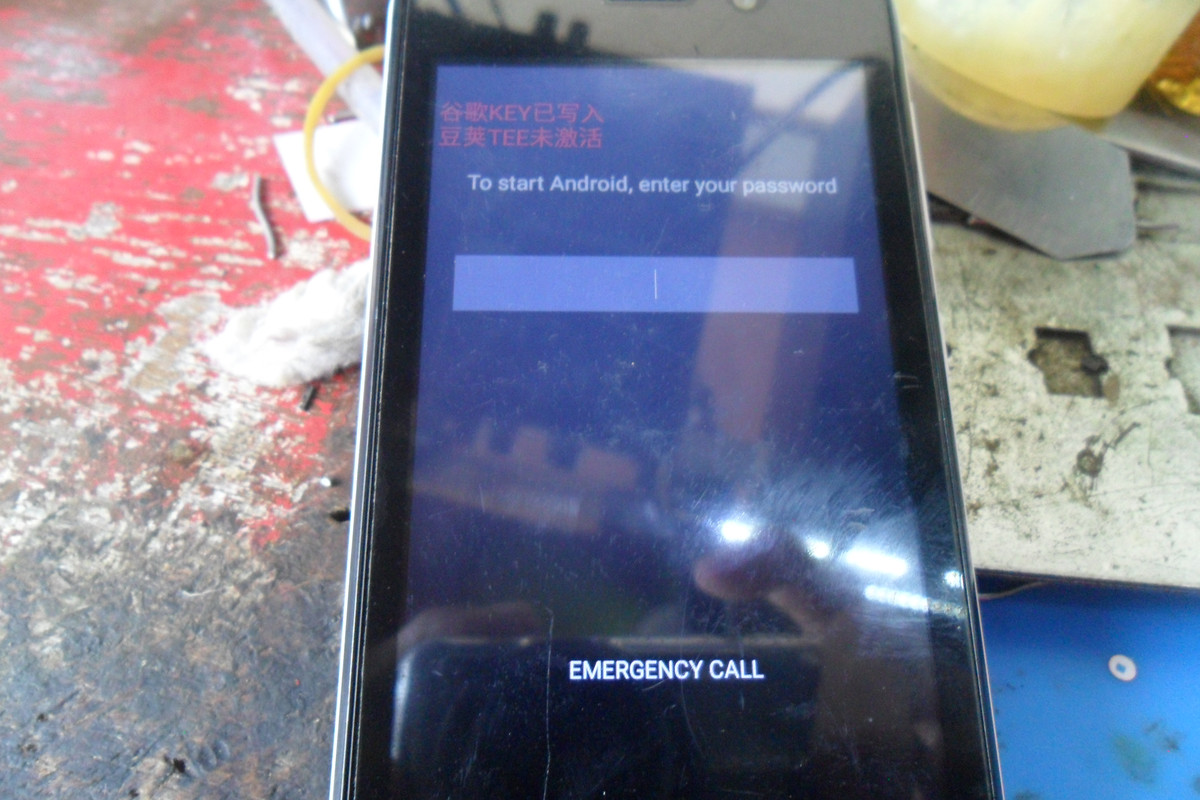

ito ang lumabas
start menu enter password
ito ang gagawin

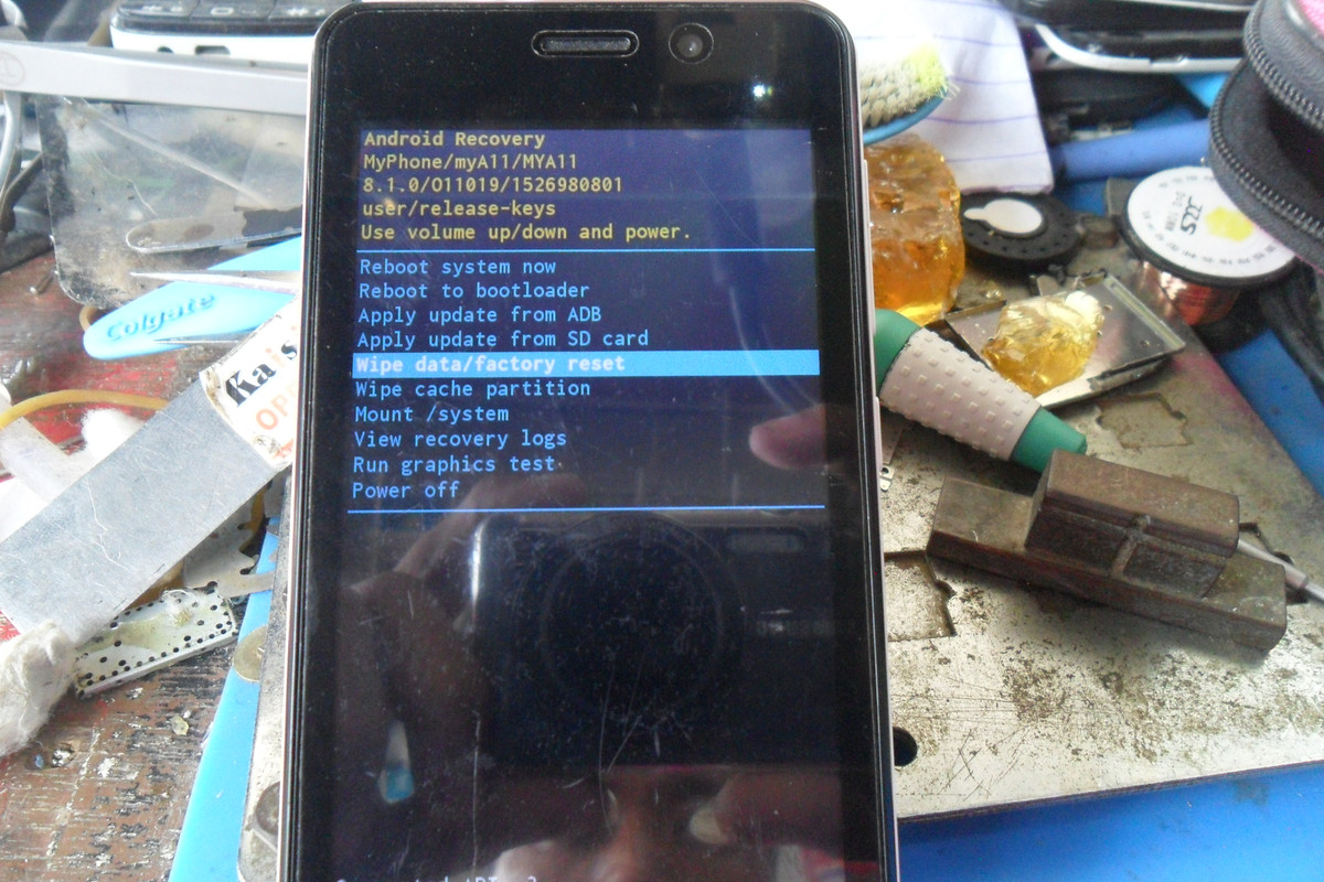

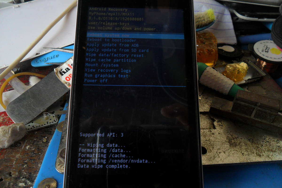

hard reset to magic finger
turn off the phone
hold power button in 2 second + volume up
press volume down for ok

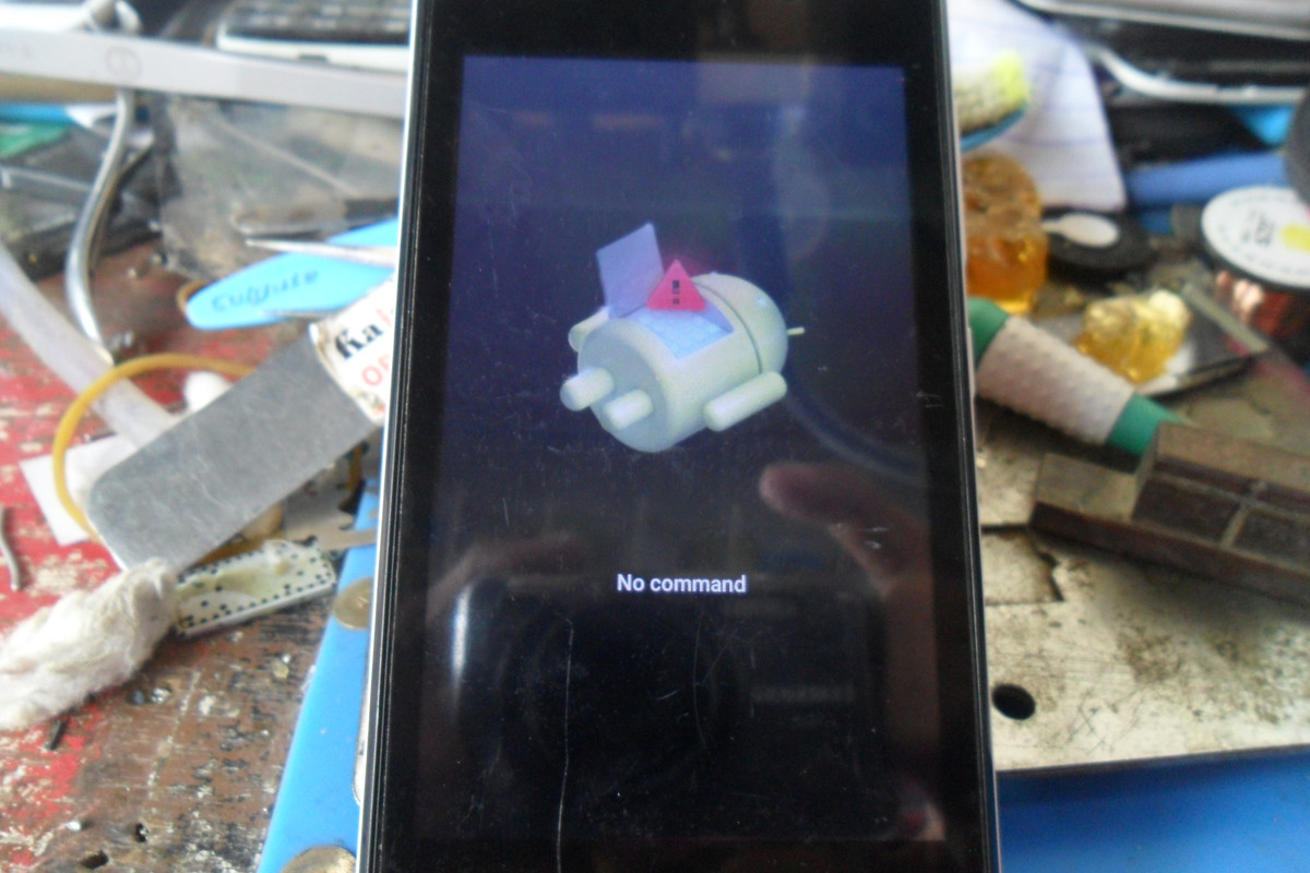

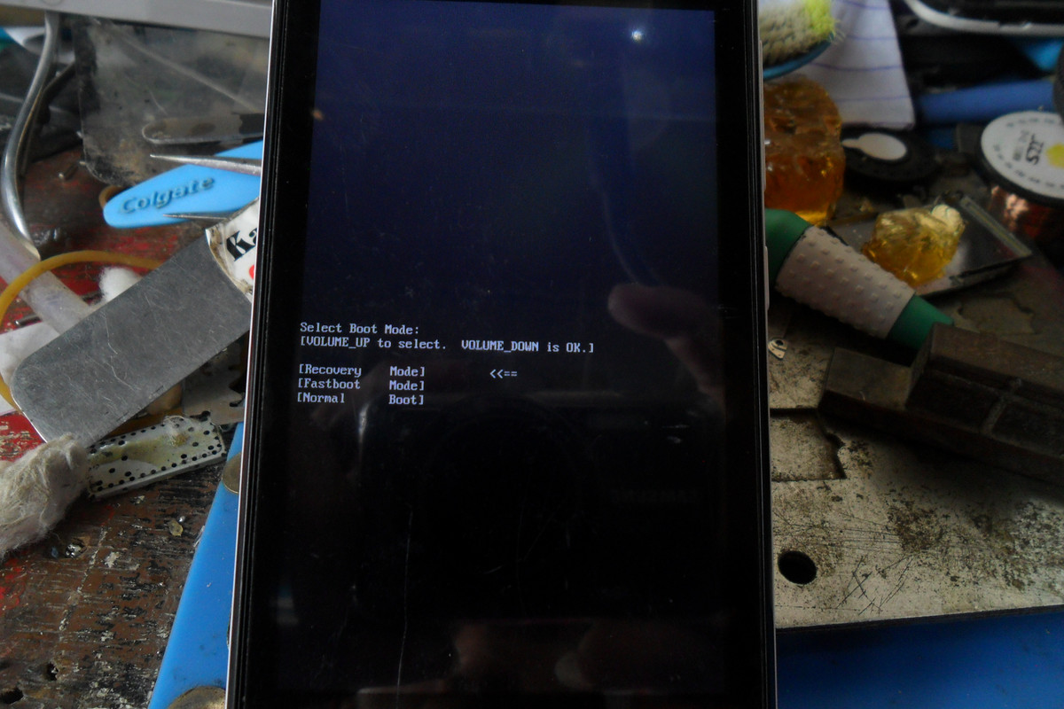

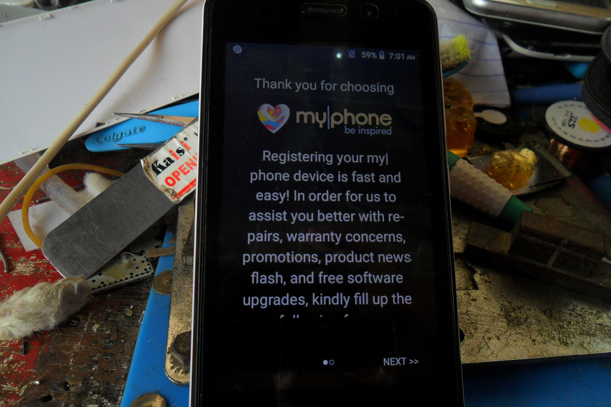

para maka punta sa recovery
hold power button pindutin ang volume up

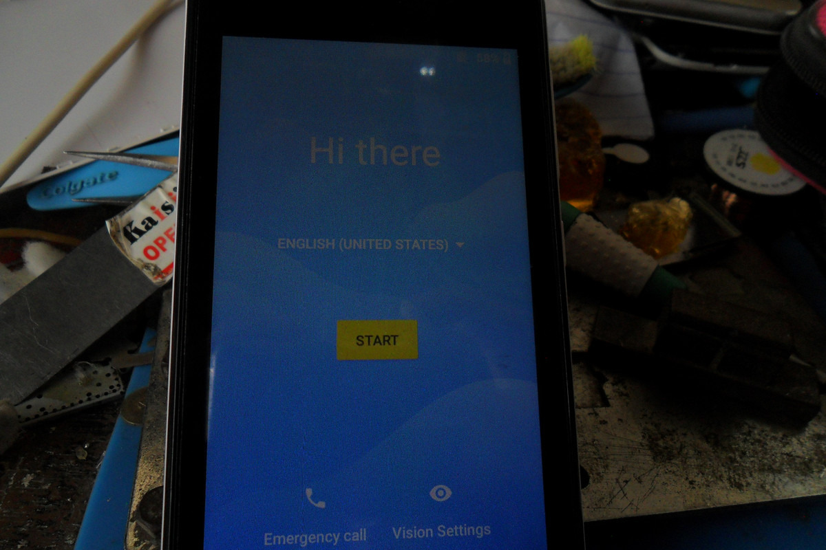

done
turn off the phone
service station near me open
done
TESTED FOR ME SIR TNX SA SHARE
