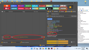

Share ko lang po ito mga boss dala ni tumer myphone myA18 naka Frp lock.
Una try ko muna sa crack tools pero hindi na kinaya, andriod version 9
Kaya try salang sa UnlockTool at hindi nMn nabigo
FRP or Google Account Problem
Process
1.Open UnlockTool
2.Select: SPREADTRUM
3.Select:Brand: SPRD GENERIC
4.Select: Model: Unisoc SC7731E V1 [Spreadtrum SC7731E_1]
5.Click: ERASE FRP
6.boot key: Press and hold Volume down and Connect Usb cable, antayin lang matapos
Settup done
Nawa'y makatulong maraming salamat po
