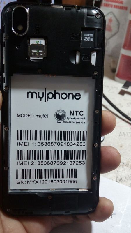

MyPhone MyX1 Back Up via CM2 sa mga may need pwede nyo po try
ito po....... MyX1 Download link

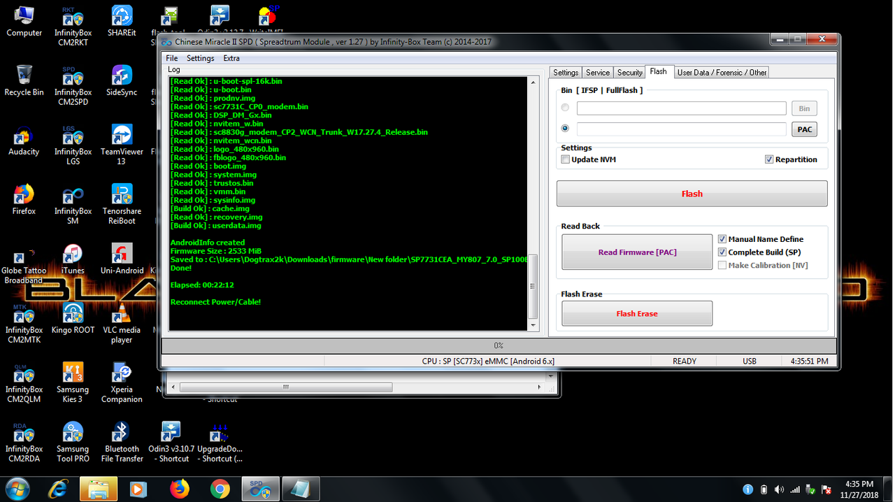

Card found: S/N : DCAC1948 , v0137
Chinese Miracle II [SPD module] v 1.27
Set mode to : SP [SC773x] eMMC [Android 6.x]
Operation : Read FullFlash [ v1.27 ]
1. Remove battery. Insert battery back
2. Press and hold 'VolumeUp' and 'VolumeDown' keys
-> Alternative : just ONE 'VolumeUp' or 'VolumeDown' key
3. Insert cable
- > Wait phone connected ...
Phone found! [ 29 ]
Port Opened
Sync...
InitBoot Done [ 0x81 ] , Ver : SPRD3
Sync...
Sending FDL
[Info] : If SW freeze here more, than 15 seconds - remove cable
FDL Ready!
Boot Ver : SC7731 Crev eMMC Loader v2.0
Sending FLASH FDL
FLASH FDL Ready!
Boot Ok!
Model Name : myX1
Model Brand : MyPhone
Model Device: MY807
AndrVersion : 7.0
BaseBand CPU: SP7731CEA
Project Ver : SP100B_MY807_MYX1_20180112_V1.06
Model Ext : MY807
[Read Mode] : HSUSB : 0x3000
[FW_READER] : Reading Firmware Now ...
[Read Ok] : u-boot-spl-16k.bin
[Read Ok] : u-boot.bin
[Read Ok] : prodnv.img
[Read Ok] : sc7731C_CP0_modem.bin
[Read Ok] : DSP_DM_Gx.bin
[Read Ok] : nvitem_w.bin
[Read Ok] : sc8830g_modem_CP2_WCN_Trunk_W17.27.4_Release.bin
[Read Ok] : nvitem_wcn.bin
[Read Ok] : logo_480x960.bin
[Read Ok] : fblogo_480x960.bin
[Read Ok] : boot.img
[Read Ok] : system.img
[Read Ok] : trustos.bin
[Read Ok] : vmm.bin
[Read Ok] : sysinfo.img
[Build Ok] : cache.img
[Read Ok] : recovery.img
[Build Ok] : userdata.img
AndroidInfo created
Firmware Size : 2533 MiB
Saved to : C:\Users\Dogtrax2k\Downloads\firmware\New folder\SP7731CEA_MY807_7.0_SP100B_MY807_MYX1_20180112_V1.06_MY807\
Done!
Elapsed: 00:22:12
Reconnect Power/Cable!
