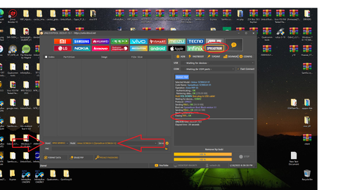

share ko lang ito mga boss FRP Problem Done in UnlockTool
ito po procedure ginawa ko
1.Open UnlockTool
2.Select: SPREADTRUM
3.Select: Brand: SPRD GENIRIC
4.Select: Mode: Unisoc SC9863A V1 [Spreadtrum SC9863A V1]
5.Click: ERASE FRP
6.boot key: press and hold volume up and down and connect Usb Cable and wait until it done
View SS
nawa;y makatulong maraming salamat po
1.Open UnlockTool
5.Click: ERASE FRP
View SS
