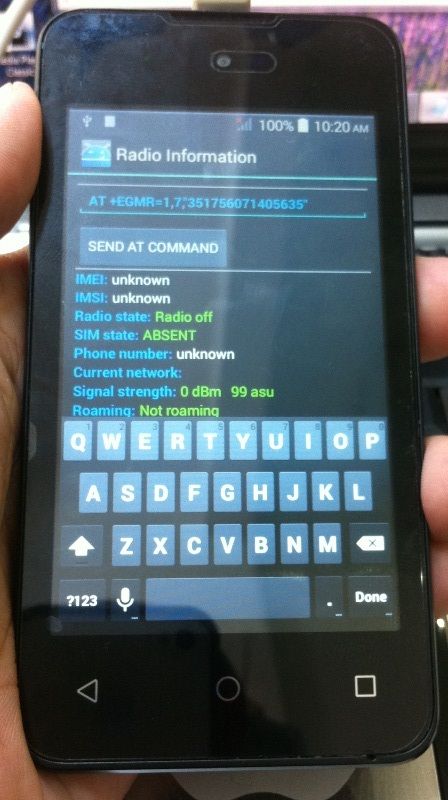

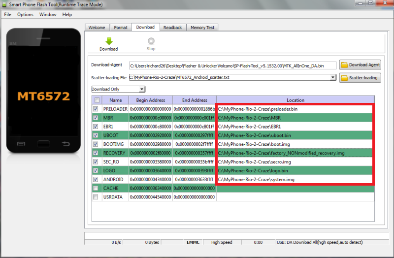

* Flash via SPFT ( Format All + Download )
* After Flashing Rebuild IMEI via Engineering Mode
* Type ( *#*#84666364#*#* )

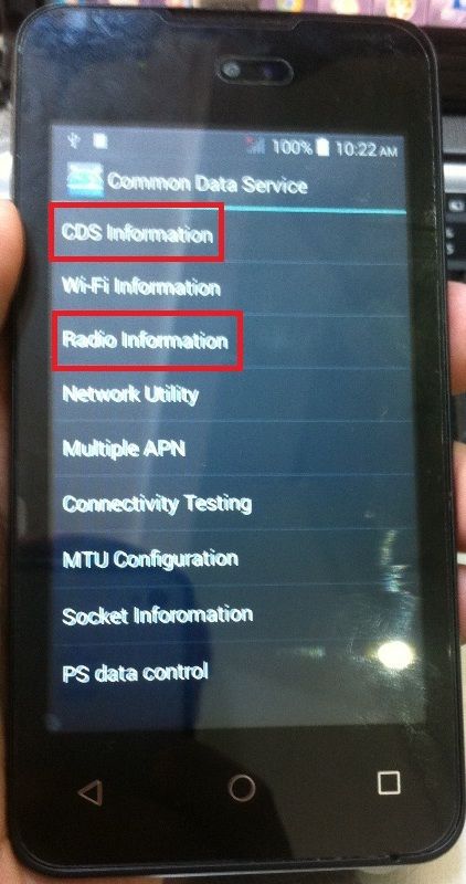

* Go to Connectivity
* Select CDS Information
* Select Radio Information
* Select Phone 1 ( IMEI 1 )
* Type ( AT +EGMR=1,7,"IMEI 1 HERE" ) or ( AT +EGMR=1,10,"IMEI 1 HERE" )
* Click SEND AT COMMAND
* Click back, Next Phone 2 ( IMEI 2 )
* Type ulit ( AT +EGMR=1,7,"IMEI 2 HERE" ) or ( AT +EGMR=1,10,"IMEI 2 HERE" )
* Reboot phone ( Check IMEI if ok na )
* Done...

Flashing muna sa SFPT ( select exact firmware manually for Recovery & Uboot )
FIRMWARE HERE Credit to Dongxkiee21

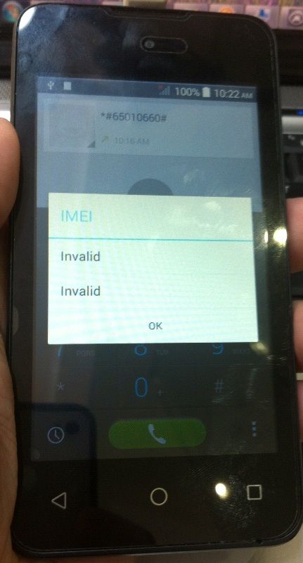

After Format & Flashing Invalid IMEI ang unit

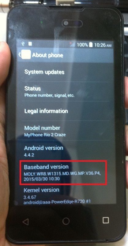

Ok naman ang Baseband kaso Invalid IMEI

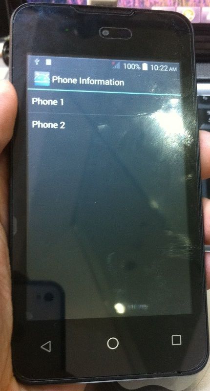

kaya try ko itong Engineering Code *#*#84666364#*#* ayun pasok
working on MTK CPU ( rio craze, rio junior, rio 2 craze )
follow srceenshot for procedure...

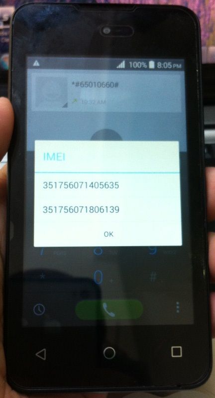

Finish Product:
Done...

Reboot and check kung Ok na ang IMEI, if Invalid pa din ulitin lang po
ang procedure...
Finish Product:
Done...
