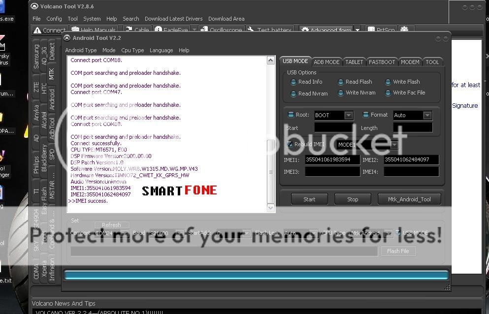

MyPhone Rio Craze invalid IMEI Done...
Reference lang po..
> Open volcano
> Android
> USB MODE/check Rebuild IMEI (MODE1) ilagay ang imei
> CPU Mtk android check USB MODE
> Then Start
> Wait lang mag-success OK..
ts baka meron ka jang solution na d gumagamit ng volcano?
