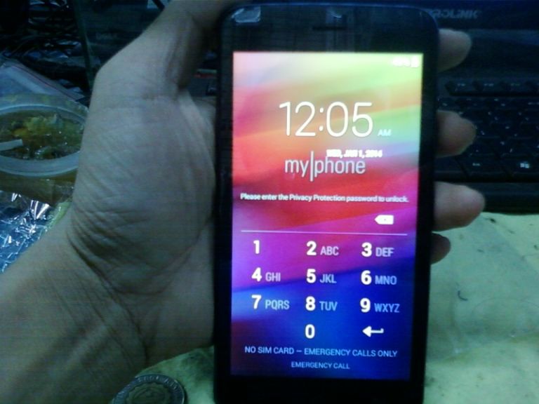

MyPhone Rio FuN V2 privacy locked done

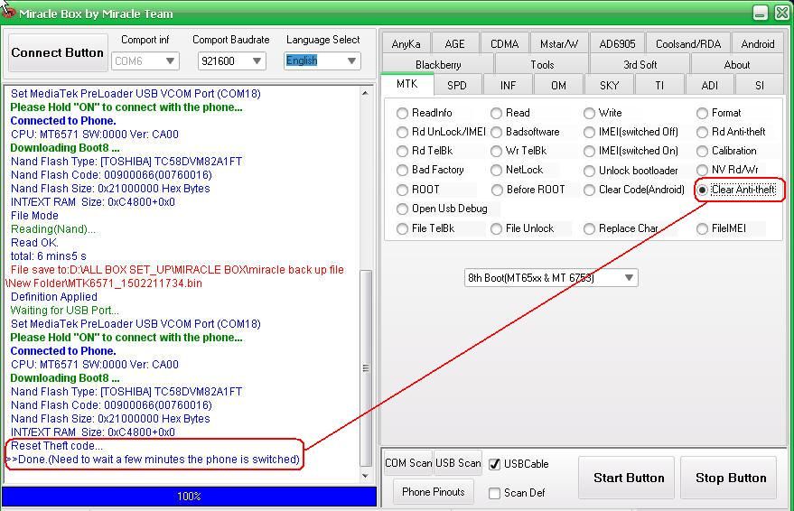

1.step open miracle box and select CLEAR ANTI -THEFT
power off ang unit, press vol - or vol + wait lng po magreboot
2.step Pag nag reboot na po ang unit, mag hung logo,kaya kailangan po natin manual format. (hold vol- and vol + kasabay ng power key) lalabas ang recovery mode wipre lng po.

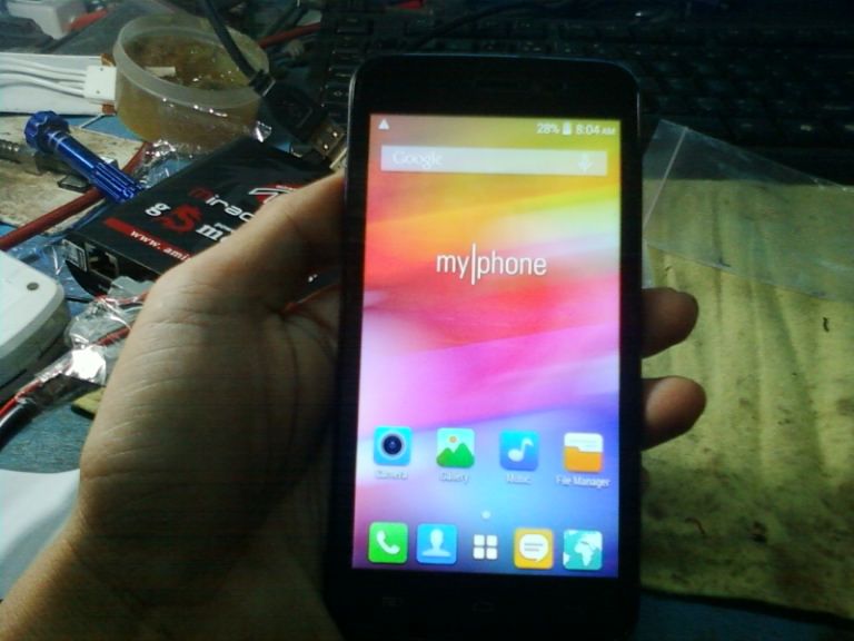

3. steps WAla na po ang privacy code

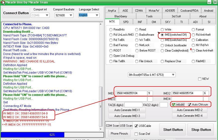

pero invalid IMEI po , need to rebuiled ang IMEI nya, (power off, hold vol_ or Vol +, insert USB DONE napo
