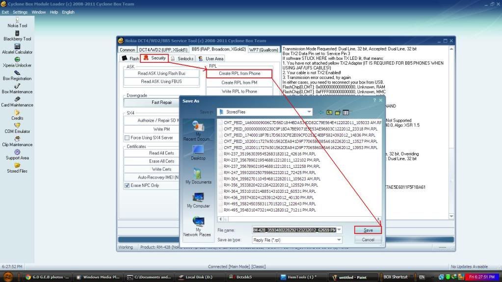

nagbaka sakali sakin ung customer ko, kulang daw ung budget niya
kc galing na siya ibang shop P1,800 ang singil sa kanya at 2days pa raw bago makuha
kaya check ko sa HWK kung SL2
Code:
1ST BOOT : C0,07 [Rm-428] [2.2.0.3] CMT ASICID: 000000010000022600010006400C192101031103 EM 1 ID : 00000296 EM 2 ID : 00000B22 CMT PUBID : 09E00109AD7A00528416E2A6322A556FB8115AD4 CMT MODE : 00 CMT HASH : CAEEBB65D3C48E6DC73B49DC5063A2EE CMT ROMID : 4B9B75103E691FF8 CMT 1ST Boot OK CMT 2ND Bt: RAPIDOv11_2nd.fg, Ver: 1.37.1 CMT FLID0 : 00EC0040-00800121, Sam OneNAND-2G CMT FLCNT : 00030000000000000000000000000000000000 CMT MCID0 : FFFF0000-00000000 CMT 2ND Boot OK CMT ALGO : RAPIDOv11_algo.fg, Ver: 1.40.0 CMT KSIG0 : 76A20187051C30162EE91C77AE5E6011F5F1BA61 CMT VPP : Internal DUAL LINE : True CMT ALG Boot OK PASUBTOC : PA_SL2 Rebooting Mobile
aba! SL2 nga
matagal ng tulog ang cyclone kya sa cyclone tinira
First Read PM files
and back up RPL

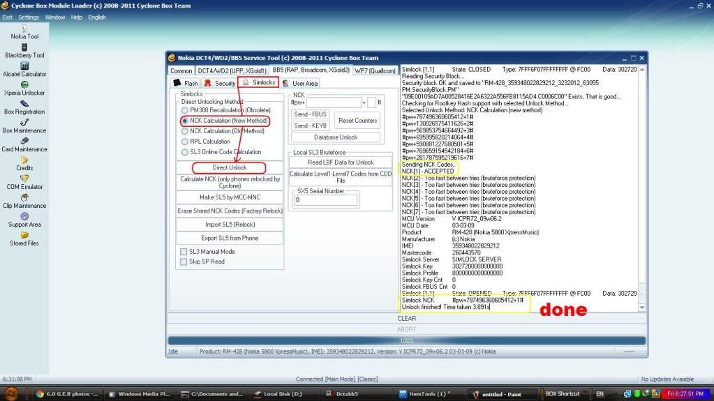

Proceed to unlocking

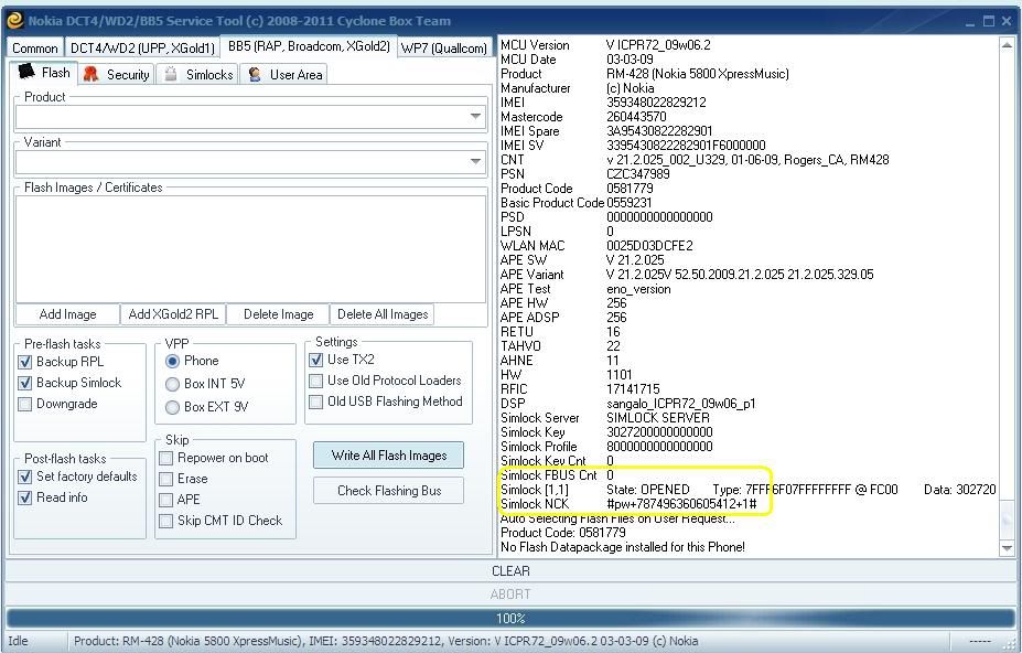

info after unlock
