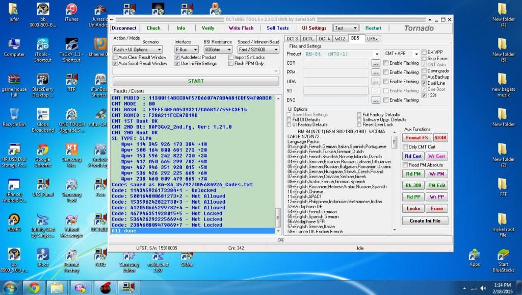

Good day mga ka ant :D
N70-1 rm-84 lock sa SMART
tools-
HWK
Dolphine Clip
tick check tab,info at locks :D
CPU: AuthenticAMD, Sp: 12
Platform: Windows NT 6.1 (Build 7600 )
Versions: Ufs2xx.dll 3.2.7, Ufs2xx.sys 2.8.30
Current Paths:
EXE : C:\Program Files\Nokia\Phoenix
TESLA: C:\Wintesla\
DCT3 : C:\Program Files\Nokia\Phoenix\Flash3\
DCT4 : C:\Program Files\Nokia\Phoenix\Flash\
BB5 : C:\Program Files\Nokia\Phoenix\Flash\
UFSx Devices not Found
UFST Boot v1.2 (c)SarasSoft 2012 Id: 54 4D 1 0
UFST Core v1.3 (c)SarasSoft 2013 Sn: 15918005
HID: 2FC312044160009C, HWK: A1.04-PRO1
SID: 083E2CE0EFE94F75503428ED80718F8BFDEB7253
XID: 92787BB842E449896493116777A397C1001EBE20
Licence: True
LogFile: .\_!_LOG\15918005_21820151_21011_LOG.txt
CMT 1ST Boot Err: Bad Resp RAPx, 03 00 72
Rebooting Mobile
Rebooting Mobile
1ST BOOT : C0,0C [] [2.3.0.3]
APE ASICID: 17100701
APE MODE : 00
APE PUBID : D75D03A93A0DF8747878846A7B8DA01220971BF4
APE HASH : 2C05369F57CC3C4CF9E783E83D9B512B
APE ROMID : AB5E4ADB27A06946
CMT ASICID: 000000010000022600010006000C192101002200
EM 1 ID : 00000232
EM 2 ID : 00000341
CMT PUBID : 11300114BCCB4F57D660747AB4A81CDF9470ABC0
CMT MODE : 00
CMT HASH : E9EFF4BFAA5393217CA6B17755FC3E14
CMT ROMID : F28A211FCEA7B19D
CMT 1ST Boot OK
Rebooting Mobile
1ST BOOT : C0,0C [Rm-84] [2.3.0.3]
APE MODE : 00
EM 1 ID : 00000232
EM 2 ID : 00000341
CMT MODE : 00
CMT 1ST Boot OK
CMT 2ND Bt: RAP3Gv2_2nd.fg, Ver: 1.21.0
00000000: 01 00 00 00 00 BD 72 ......r
ERR: CMT 2ND Boot UNKNOWN Response
Rebooting Mobile
Rebooting Mobile
Rebooting Mobile
Rebooting Mobile
Licence: True
LogFile: .\_!_LOG\15918005_21820151_22445_LOG.txt
APE MODE : 00
EM 1 ID : 00000232
EM 2 ID : 00000341
CMT MODE : 00
CMT 1ST Boot OK
CMT FLID0 : 00EC22FA-00000011, Sam K8S6415ETA
CMT FLCNT : 00000000000000000000000000000000000000
CMT MCID0 : FFFF0000-00000000
CMT 2ND Boot OK
CMT ALGO : RAP3Gv3_algo.fg, Ver: 9.17.0
CMT KSIG0 : 0F72BF9DE5D6711B3B1133EBCAB5914FA419C78D
CMT VPP : Internal
DUAL LINE : True
CMT ALG Boot OK
APE 2ND Bt: helen3_2nd.fg, Ver: 1.35.0
ERR: APE 2ND Boot APE 2ND ACK
Rebooting Mobile
MCU SW : V 05wk07v48.1 28-08-07 RM-84 (c) Nokia.
APE Core:
APE Var :
Product : Nokia N70
Prd.Code: 0530332
Bpr.Code: 0522156
Prod.Sn : CPB998573
HW Vers : 6001
APE HW :
APE Adsp:
EM RETU : 32
EM TAHVO: 41
RFIC Ver: 150a160e
DSP Vers: rolf_05wk07v29p1
IMEI : 357927-00-568492-6
SL Serv : SIMLOCK SERVER VERSION 58
SL Conf : 515-03-00000000000
SL Prof : 0000000000000000
SL Count: 00 00
BLK1= L1: CLOS
BLK2= L1: CLOS
Provider: Smart Communications;Philippines
UI Defaults Ok, Time: 00:05
Set UI Factory Defaults Ok, Time: 00:00
Set Full Factory Defaults Ok, Time: 00:00
Set Software Upgrade Defaults Ok, Time: 00:21
IMEI: 357927-00-568492-6
APE MODE : 00
EM 1 ID : 00000232
EM 2 ID : 00000341
CMT MODE : 00
CMT 1ST Boot OK
CMT 2ND Boot OK
SL TYPE: SLPA
#pw+ 114 345 926 173 384 +1#
#pw+ 500 164 800 681 273 +2#
#pw+ 153 596 242 822 730 +3#
#pw+ 412 050 665 299 782 +4#
#pw+ 467 946 351 928 015 +5#
#pw+ 536 426 292 225 669 +6#
#pw+ 238 460 809 479 869 +7#
Codes saved as Rm-84_357927005684926_Codes.txt
Code: 114345926173384+1 - Unlocked
Code: 500164800681273+2 - Not Allowed
Code: 153596242822730+3 - Not Allowed
Code: 412050665299782+4 - Not Allowed
Code: 467946351928015+5 - Not Locked
Code: 536426292225669+6 - Not Locked
Code: 238460809479869+7 - Not Locked
All done
