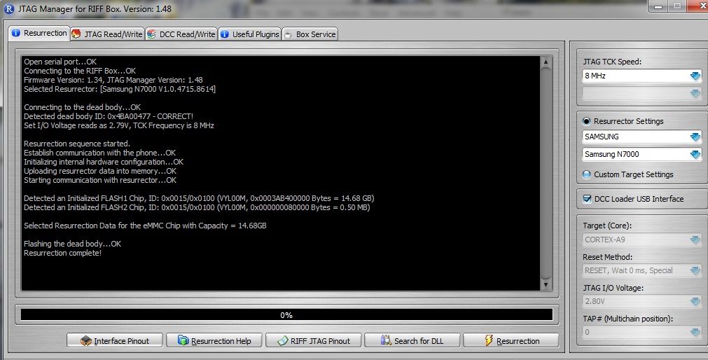

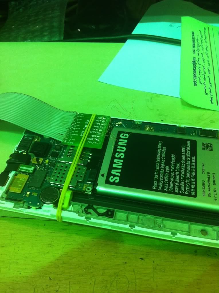

pinout is already provided in the riff box sw (you have to solder the pinout)

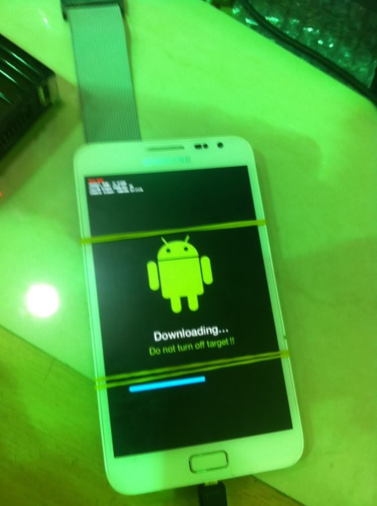

open riff box sw, select correct model and do the resurrection process >>>>RESURRECTION COMPLETE

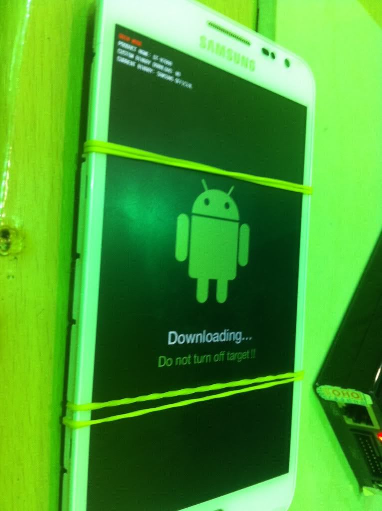

download mode----ready to flash in odin

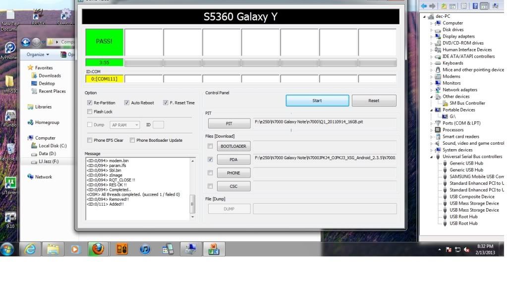

screenshot during flashing
flashing is completed

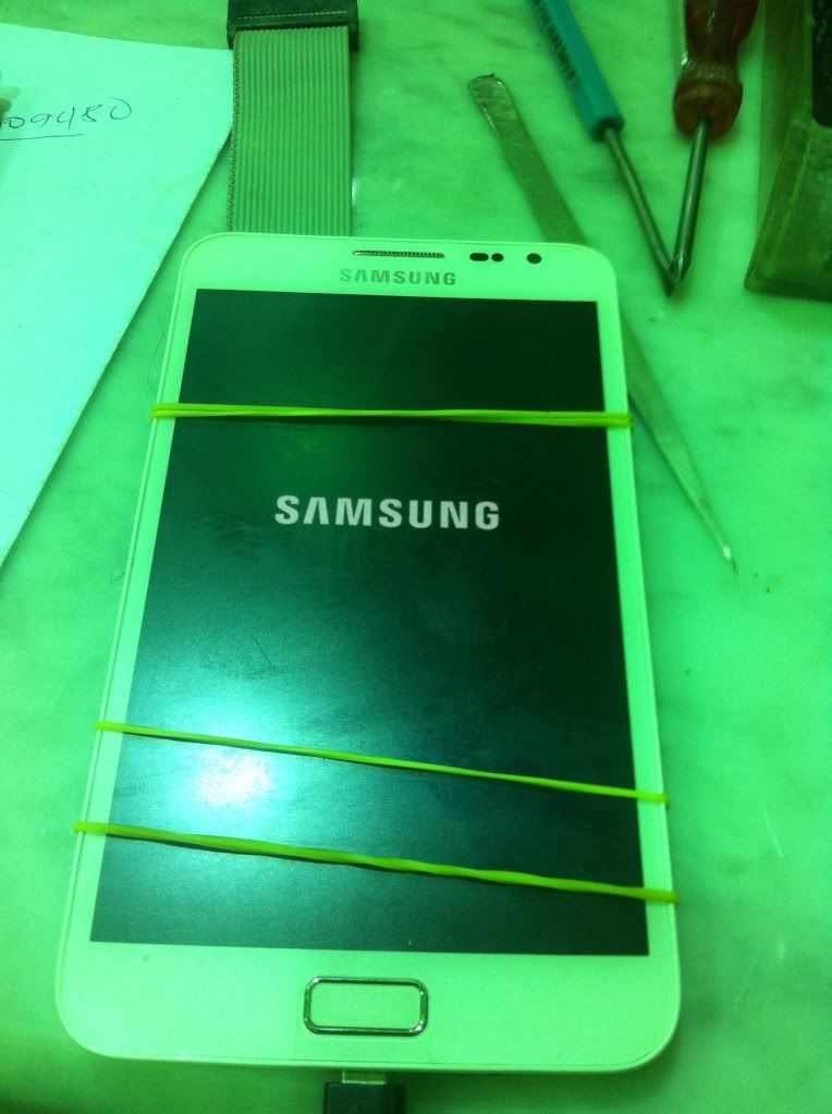

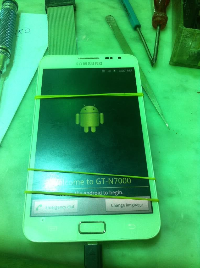

unfortunately, logo only (hangup)
try to flash with lower version 2.3.5
i can see this one

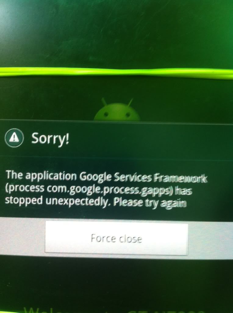

but i cannot continue in tapping the android logo>>>>.force close appears on the screen

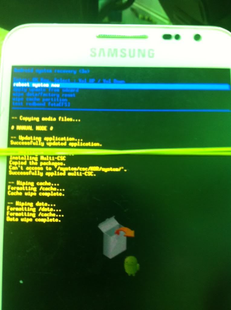

then i try to wipe data/ wipe cache partitioning

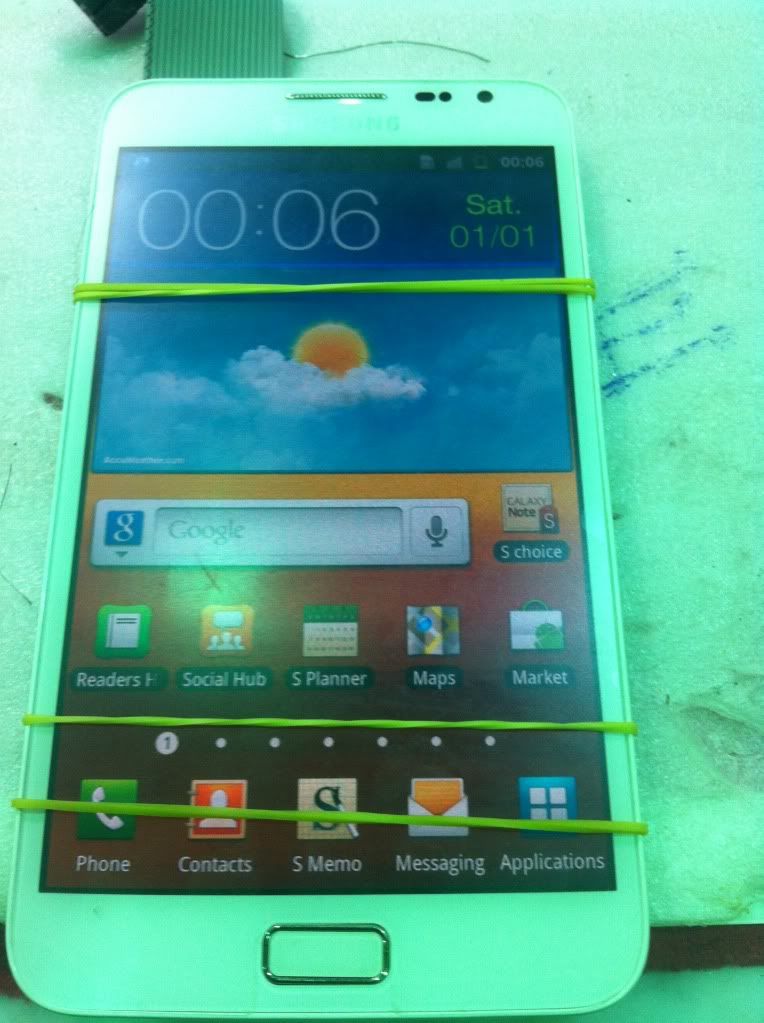

force close problem is being disappeared, here is the finished product

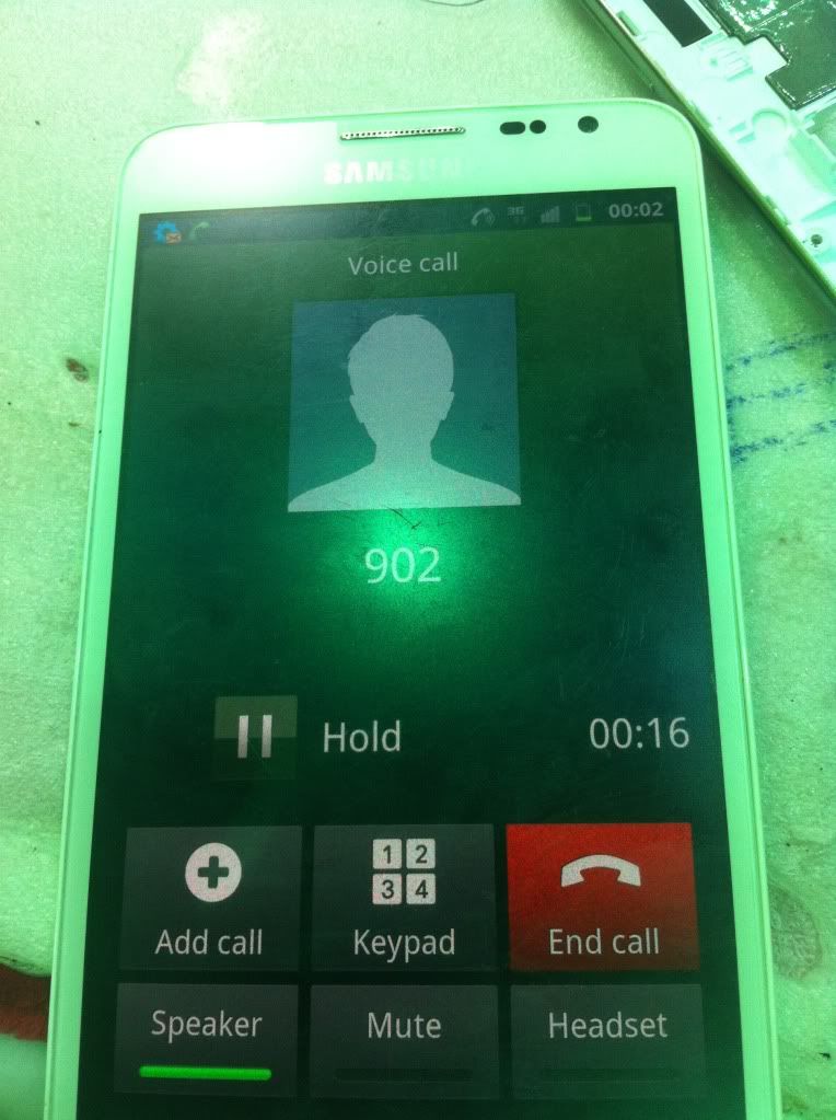

calling is ok
