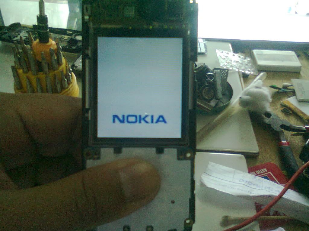

mga boss ito ginawa ko n70 no light sa keypad board....
<textarea style="width: 500px;" readonly="readonly" class="ncode_imageresizer_warning" id="ncode_imageresizer_warning_1">Click here to view the original image of 769x577px.</textarea>
1sy na genawa ko,,,,,,

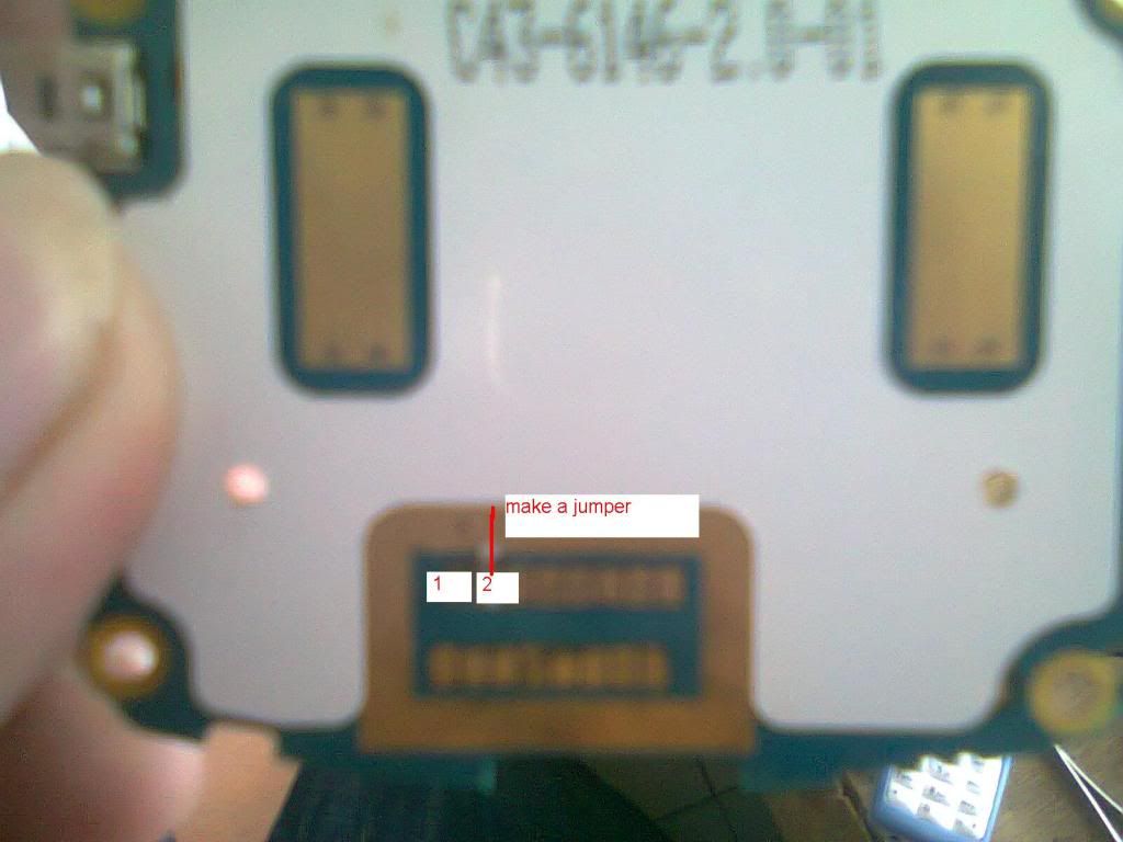

<textarea style="width: 500px;" readonly="readonly" class="ncode_imageresizer_warning" id="ncode_imageresizer_warning_2">Click here to view the original image of 769x577px.</textarea>
2nd jumper ko sa ground..............

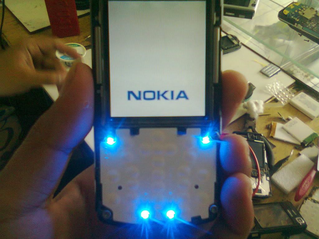

<textarea style="width: 500px;" readonly="readonly" class="ncode_imageresizer_warning" id="ncode_imageresizer_warning_3">Click here to view the original image of 769x577px.</textarea>
