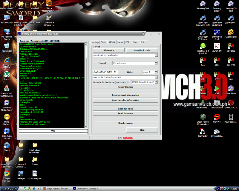

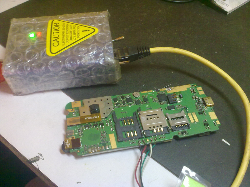

n82i Format Done via INFINITY With STORY
n82i Restart When Sim Inserted Done via Infinity
Procedure
1. open infinity shell
2.click Chinese Miracle
3.Read Full Backup
4.Format
5Write IMEI
6.Testing
FORMAT
LOGS
COM16 [VCP0] selected
module v3.26
Action: reset settings ("format ffs")
Model: Autodetect 6205-6239 NOR
Checking data, wait...
Phone should be Switched OFF !
Press and HOLD Power button now !
19200 autodetect
Initializing [6225:8A05:8A00]...
CPU: MT6225
high speed boot On
chip: 0001:F903:000C
status: FF
Connecting at 19200, wait...
Release Power button now !
Phone detected, wait...
Hardware: MT6225,E05
Date: 2006.06.14
Version: 1.0
Version: H626_MIC1_SET_TV1_FM1_BT1_EN_SP_PR_ITA_GE_MA_VI_RU _TH_V2.01
Version: H626_HW_V00
detecting structure #2...
5 11 done
67 byte(s) read
imei: 13579024681122
warning: current phone imei is incorrect !
It's need to repair imei for correct phone functionality !
connection Ok
building list...
done
items to clear: 134
warning: wrong packet cs
items cleared: 134 of 134
building list...
done
items remains: 0
Finished, time used: 1 min 29 sec
Remove/Install battery now !
Screenshot
