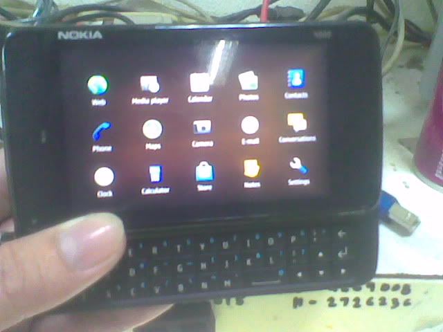

status of phone : nokia only with 5 dots on the screen only

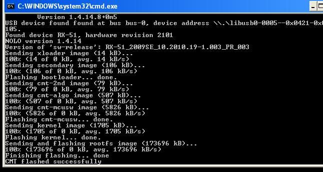

* in CMD exe..Run the following command: type this one
flasher-3.5.exe -F RX-51_2009SE_10.2010.19-1.
003_PR_COMBINED_003_ARM.bin -f -R
hit enter key on your keyboard to flash your phone...
here is the log during the flashing operation

C:\Program Files\maemo\flasher-3.5>
then you can smile now....finished product

Version 1.4.14.8+0m5
Image 'secondary', size 109440 bytes
Valid for RX-51: 2301, 2302, 2303, 2304, 2305, 2306
Image '2nd', size 14848 bytes
Valid for RX-51: 2401, 2402, 2403, 2404, 2405, 2406
Image 'xloader', size 14848 bytes
Image '2nd', size 14720 bytes
Valid for RX-51: 2104, 2105, 2106, 2107, 2108, 2109, 2110, 2111, 2112, 2
113, 2114, 2115, 2116, 2117, 2118, 2119
Valid for RX-51: 2501, 2502, 2503, 2504, 2505, 2506
Valid for RX-51: 2607, 2608, 2609, 2610
Valid for RX-51: 2507, 2508, 2509, 2510
Valid for RX-51: 2201, 2202, 2203, 2204, 2205, 2206, 2207, 2208, 2209, 2
210, 2211, 2212, 2213, 2214, 2215, 2216
Valid for RX-51: 2601, 2602, 2603, 2604, 2605, 2606
USB device found found at bus bus-0, device address \\.\libusb0-0005--0x0421-0x0
105.
Found device RX-51, hardware revision 2101
NOLO version 1.4.14
Version of 'sw-release': RX-51_2009SE_10.2010.19-1.003_PR_003
Sending xloader image (14 kB)...
100% (14 of 0 kB, avg. 14 kB/s)
Sending secondary image (106 kB)...
100% (106 of 0 kB, avg. 106 kB/s)
Flashing bootloader... done.
Sending cmt-2nd image (79 kB)...
100% (79 of 0 kB, avg. 79 kB/s)
Sending cmt-algo image (507 kB)...
100% (507 of 0 kB, avg. 507 kB/s)
Sending cmt-mcusw image (5826 kB)...
100% (5826 of 0 kB, avg. 5826 kB/s)
Flashing cmt-mcusw... done.
Sending kernel image (1705 kB)...
100% (1705 of 0 kB, avg. 1705 kB/s)
Flashing kernel... done.
Sending and flashing rootfs image (173696 kB)...
100% (173696 of 0 kB, avg. 173696 kB/s)
Finishing flashing... done
CMT flashed successfully
