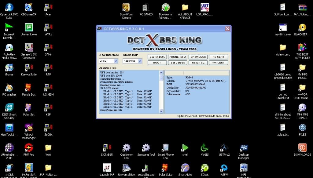

share ko lang, may naligaw dito na n91 mga boss..error sa zulea kaya sa dctx bb5 king ko na tinira
ayos!!may pananghalian na kami....1k petot
eto po logs:
UFS box version: 208
UFS box SN: 1xxxx
Searching for phone ...
Phone found on FBUS interface
Reading phone info ...
SP LOCK status:
Block 1: CLOSED Type 5 Data: 50506F
Block 2: CLOSED Type 5 Data: 50599F
Block 3: CLOSED Type 5 Data: 50506F
Block 4: CLOSED Type 5 Data: 50599F
Block 5: CLOSED Type 5 Data: 00101F
Block 6: CLOSED Type 5 Data: 00101F
Read Phone Info OK
Reading PM Field 308 Subfield 1 with length 8192 bytes
Saving to file: RM-43_3583910007xxxxx_Locked_Keycnt_0_Fbuscnt_0__V_w33_06w24v2_24-07-06_RM-43_(c)_Nokia.__18_05_2009__10_59_11.bin
PM308 backup OK
Searching for ATMEGA! ...
UFS box detected
UFS box SN: 10497
UFS box UFSBOX_BB5_FLASH_bb5challenge ...
ASIC ID: 000000010000022600010006000C192101002200
HASH: E9EFF4BFAA5393217CA6B17755FC3E14
ROM ID: F28A211FCEA7B19D
Sending loader...
Rap3Gv2 selected.
BB5_FLASH_CMTbootload
UFSx CMT Boot Ready
Hello ok
start
ok
Hello ok
Hello ok
PM send.
Test call...
cpsr - 0x0000001F
p15_1 - 0x0005307F
p15_2 - 0x0005117F
p15_3 - 0x0005317F
esn_init ret - 0x00000001, <tmp_buff2> - 0x00000027
esn_read ret - 0x00000001, <tmp_buff2> - 0x00000001
Normal BB5 found - 0x006E1D30
LR - FFFF2C68, param - 0x03, size - 0x00
UpdSLock - 0x00000001
ret - 0x01, <tmp_buff2> - 0x23
PM_308 CRC - 0x0018288B
Reciving PM
Hello ok
PM buff recived
After unlock.
UFS box SN: 10497
Writting PM Field 308 Subfield 1 with length 8192 bytes
Reset phone ...
PM Field 308 Subfield 1 written OK
Operation time: 01:20.
Successfully done.
Thread phone exit.
