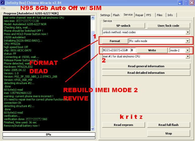

Problem :
Auto Off (when sim insert)

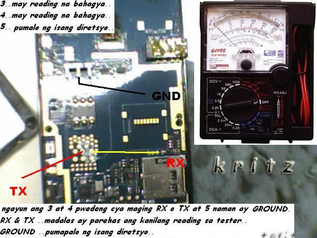

Procedure :
Search Button (Pinouts) no luck
Search Pin Out using Tester Done !!!
Format then Rebuild imei using mode 2
Done !!!
