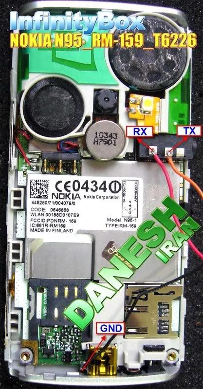

N95 china - single sim
Problem - reboots with sim
here's the pinout

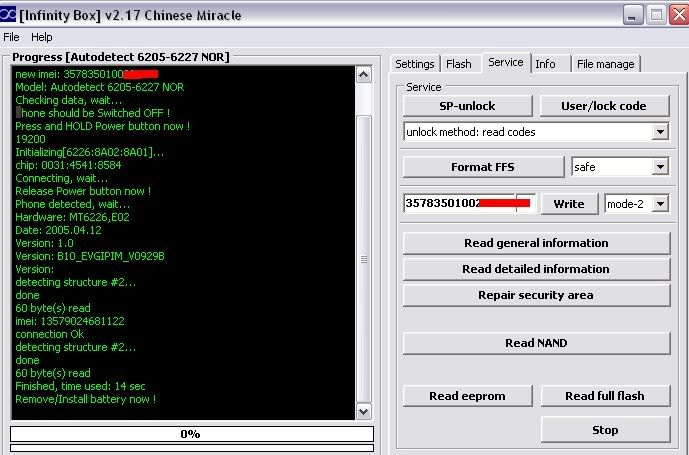

RESTORE ORIGINAL IMEI
COM3 [VCP0] selected
Action: imei
imei write method: mode-2
new imei: 3578350100?????
Model: Autodetect 6205-6227 NOR
Checking data, wait...
Phone should be Switched OFF !
Press and HOLD Power button now !
19200
Initializing[6226:8A02:8A01]...
chip: 0031:4541:8584
Connecting, wait...
Release Power button now !
Phone detected, wait...
Hardware: MT6226,E02
Date: 2005.04.12
Version: 1.0
Version: B10_EVGIPIM_V0929B
Version:
detecting structure #2...
done
60 byte(s) read
imei: 13579024681122
connection Ok
done
60 byte(s) read
Finished, time used: 14 sec
Remove/Install battery now !

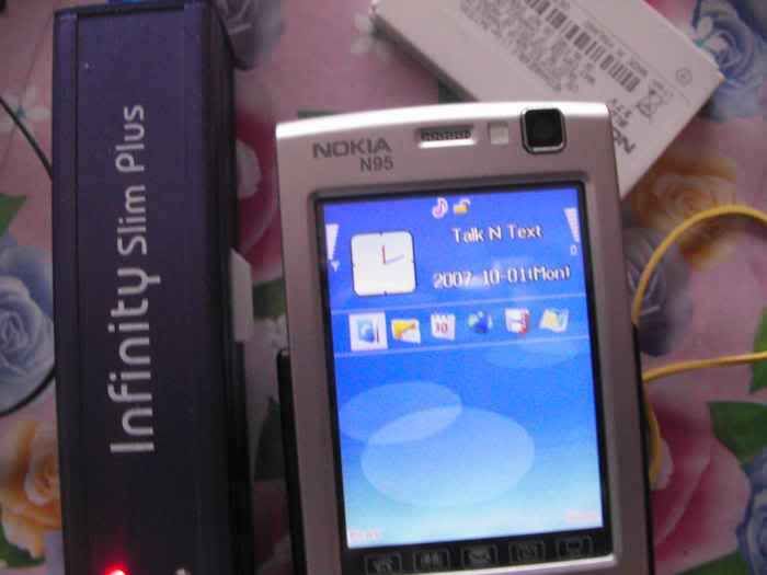

here's a screenshot
solved
