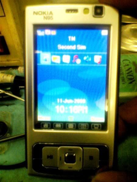

again.....share ko lang for reference
problem
hone shuts off when sim inserted then restart
action taken:

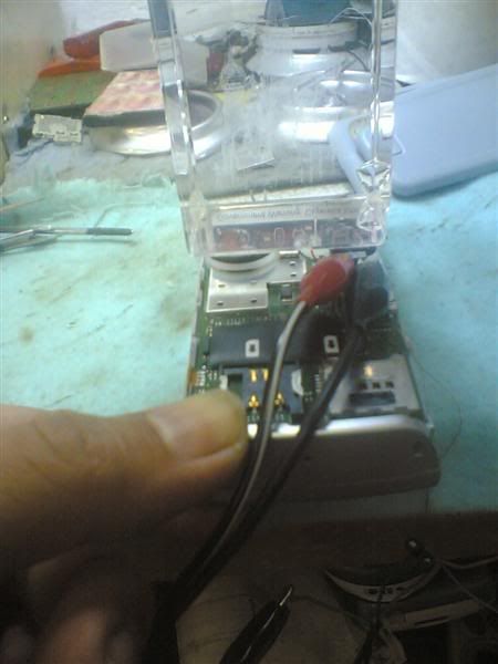

(this is my simple steps made in infinty box)

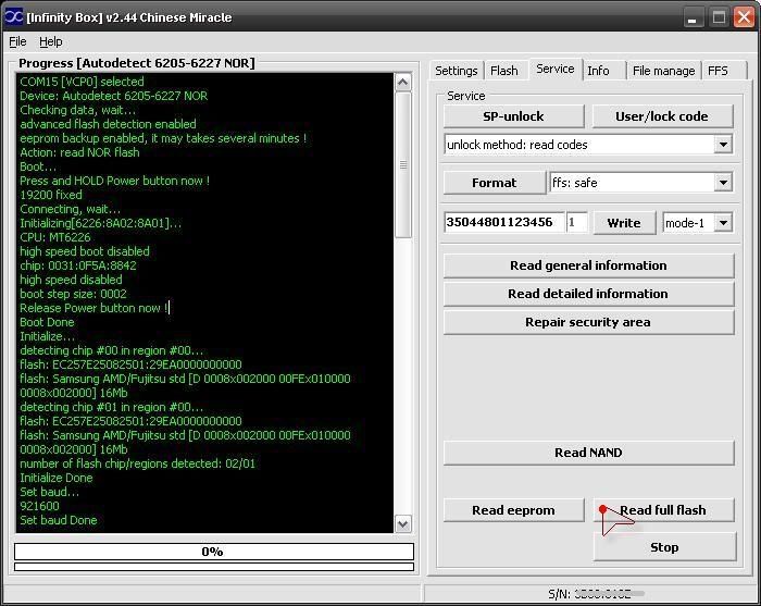

1.back-up phone read full flash:

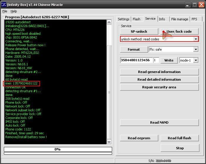

3.read codes:
(pag nakadefault na yung imei niya like this imei: 13579024681122 meaning format success
no need na magtest para malaman kung ok na ang phone)

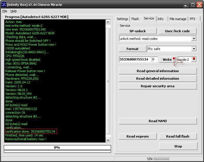

4.last restore imei:
verification done: 35336800755134

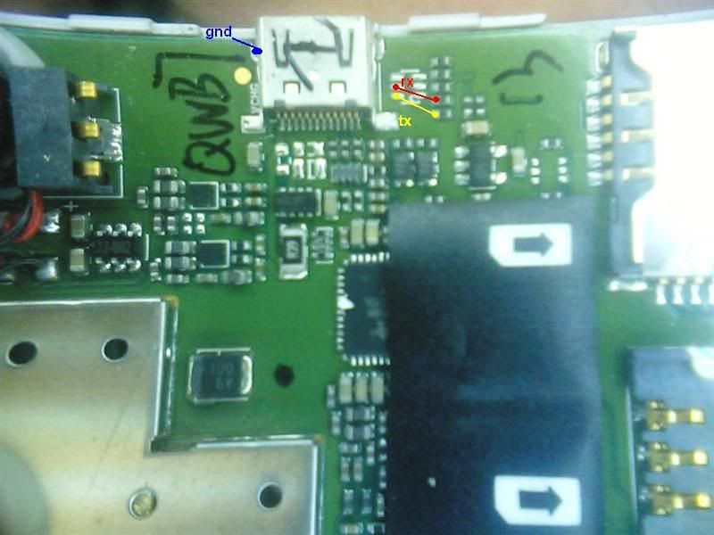

pin-out:
done;
