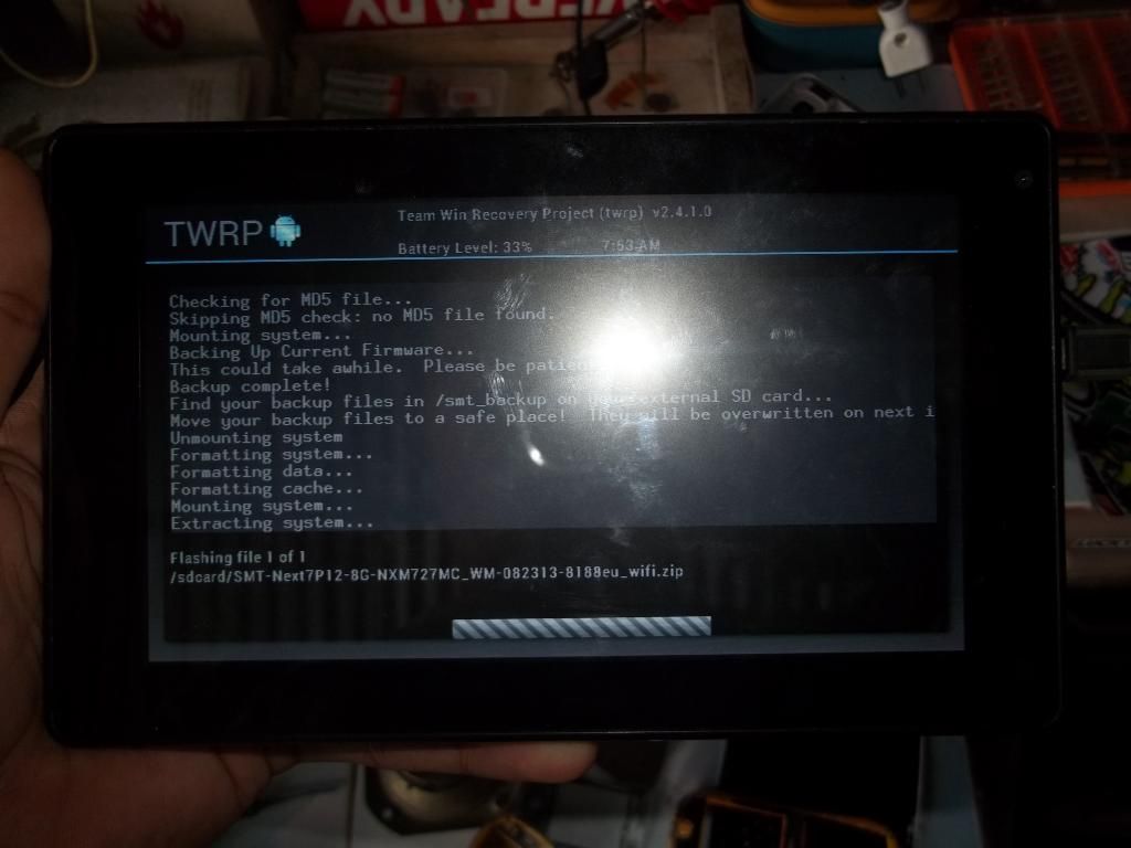

CWM/TWRP recovery: http://www.freak-tab.de/ShaunMT/TWRP_Amlogic/SMT_TWRP_Next7P12-8G-NXM727MC_WM.zip
note: kailangan po ung cwm recovery para ma flash yan faild kac pag wala faild to verify at sabihin kai tomer na not working wifi pag na fix na.

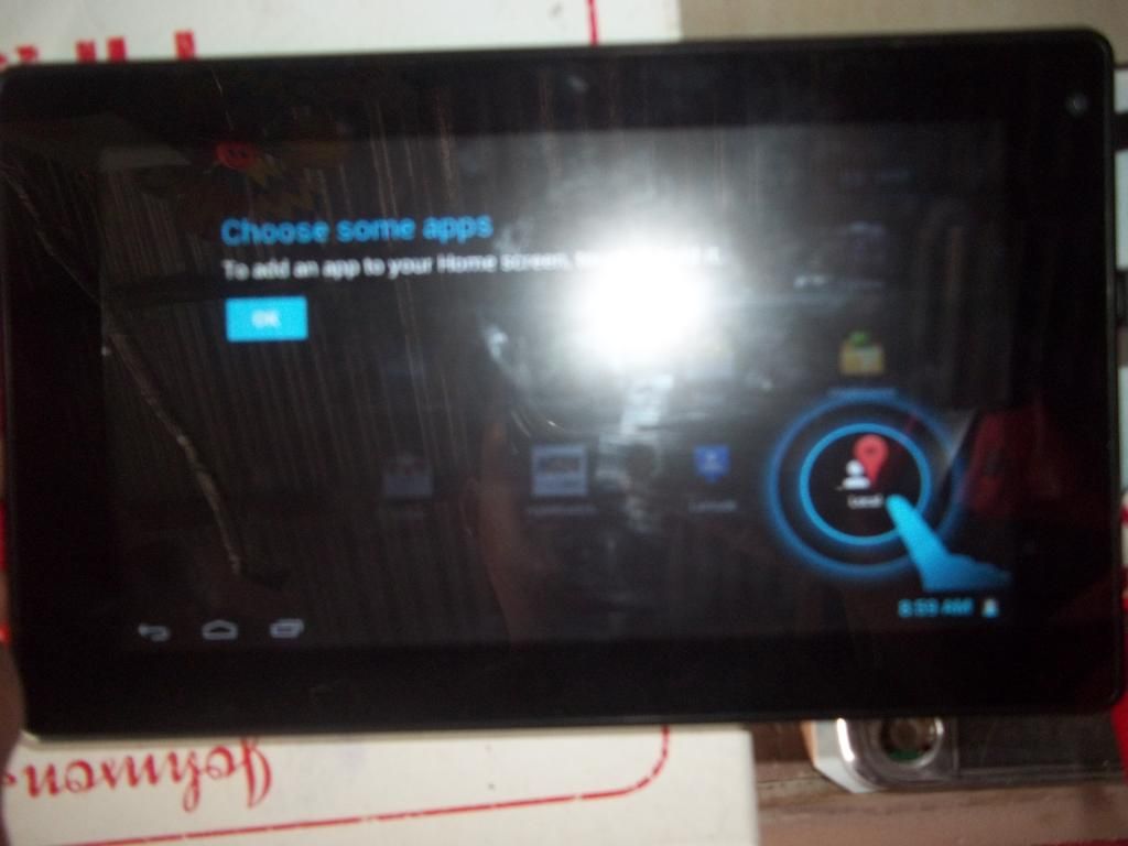

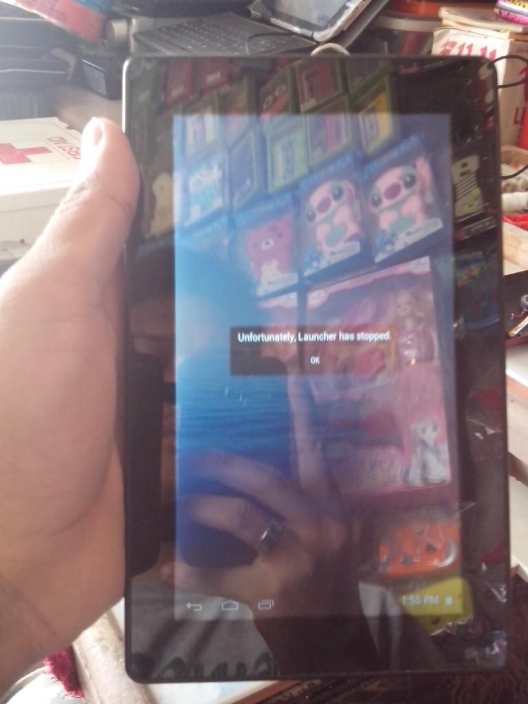

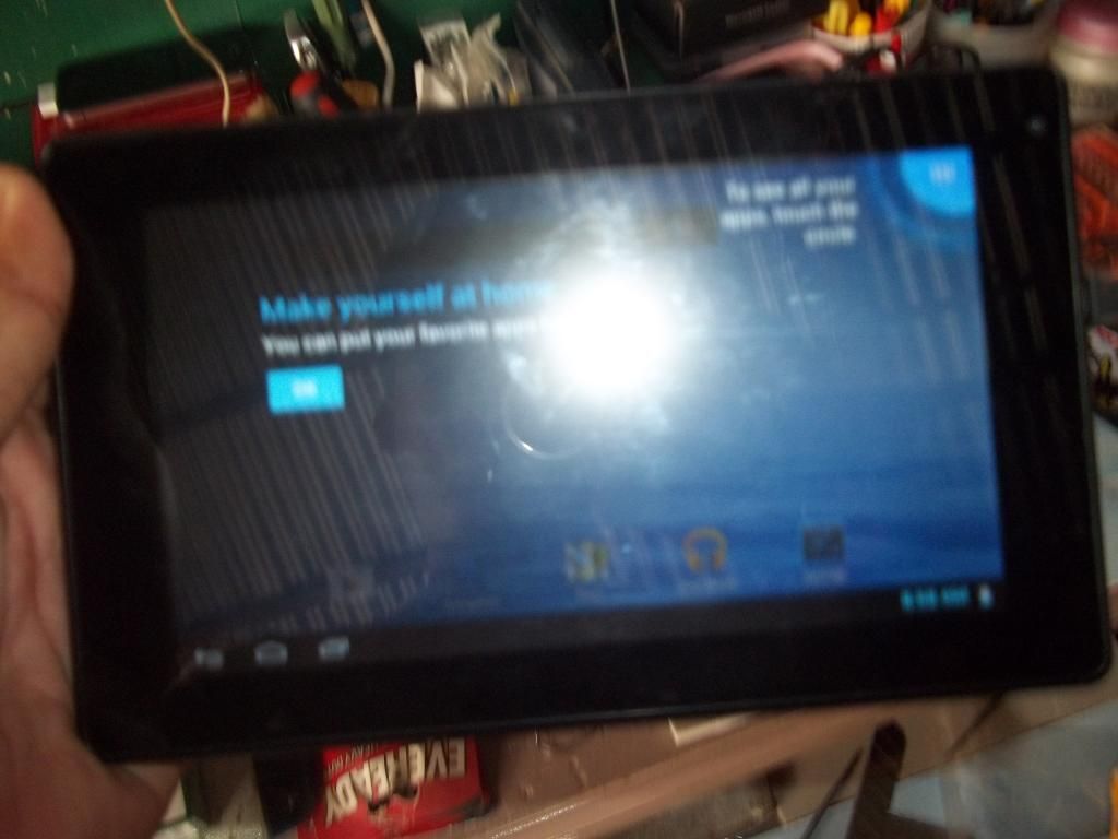

ito po screenshot
problem
flashing on process

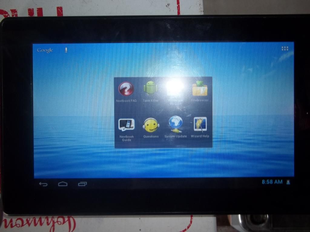

finish product
DONE
