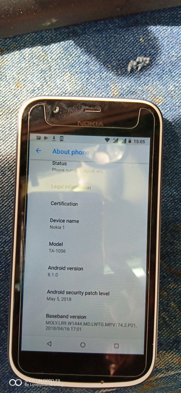

Nokia 1 (Nokia TA-1056) Frp Done sa CM2
eto ung unit nakaFRP

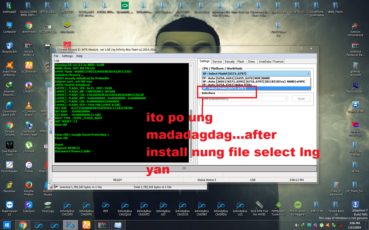

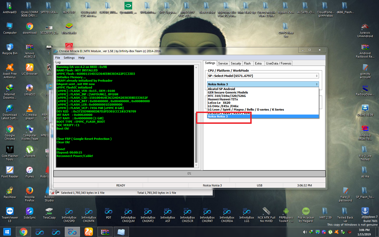

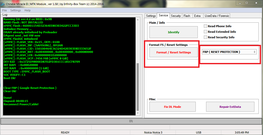

after po madownload ung file install lang
tapos refer nlng po sa picture below
where to post picture
Done...
