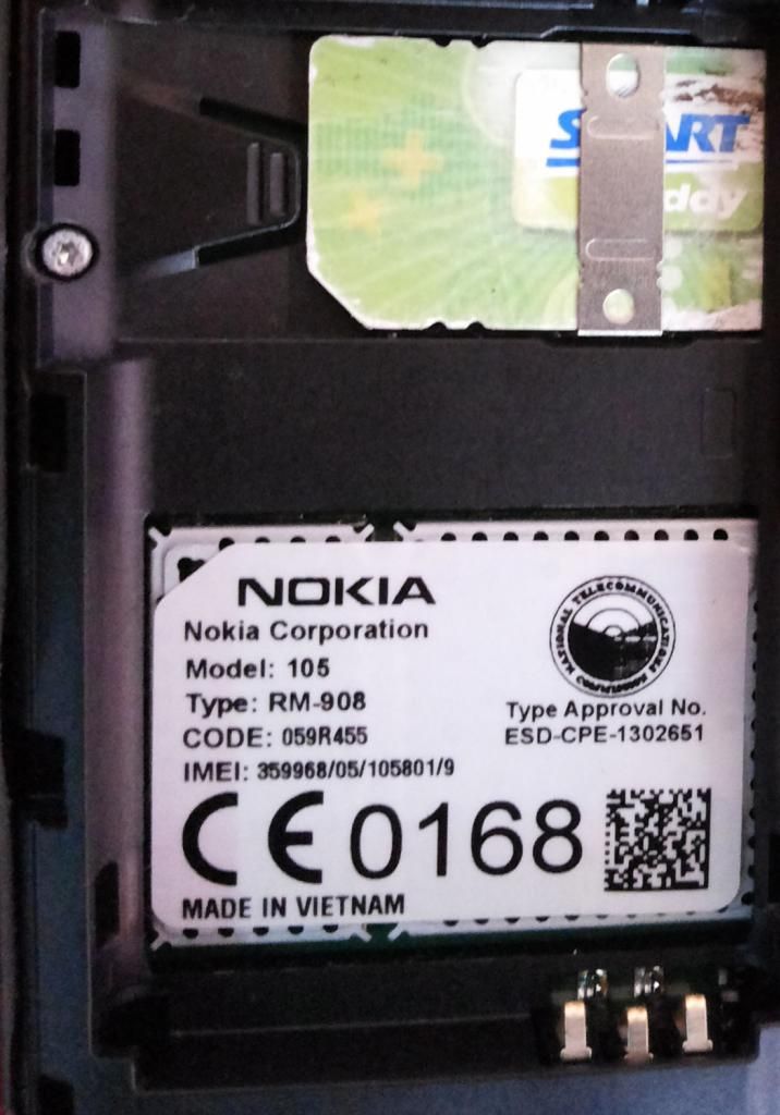

gud evening mga mate share q lang itong tangap q
MODEL:Nokia 105
PROBLEM
assword
HISTORY:Nakalimutan daw ng asawa

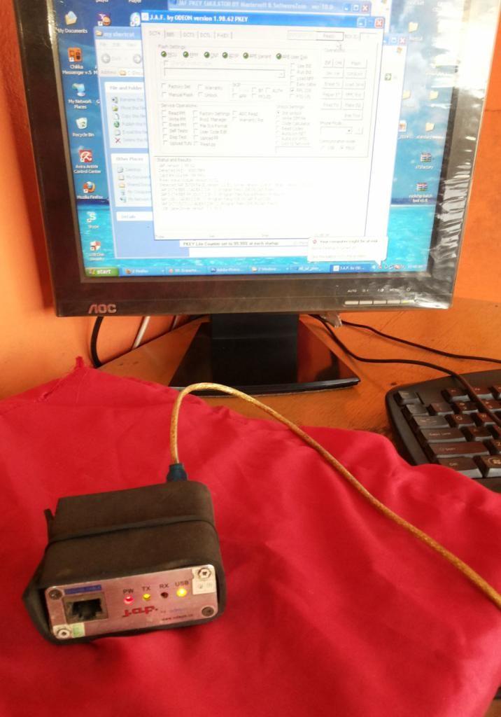

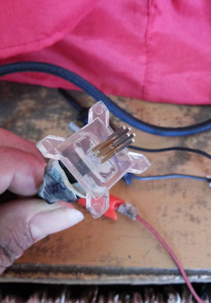

TOOLS:
JAF BOX
UNIVERSAL CABLE
OPEN JAF AND SUNDAN LANG PO SAFE AND EASY MONEY
SET UP
UNIVERSAL CABLE
UNIT MODEL
READY

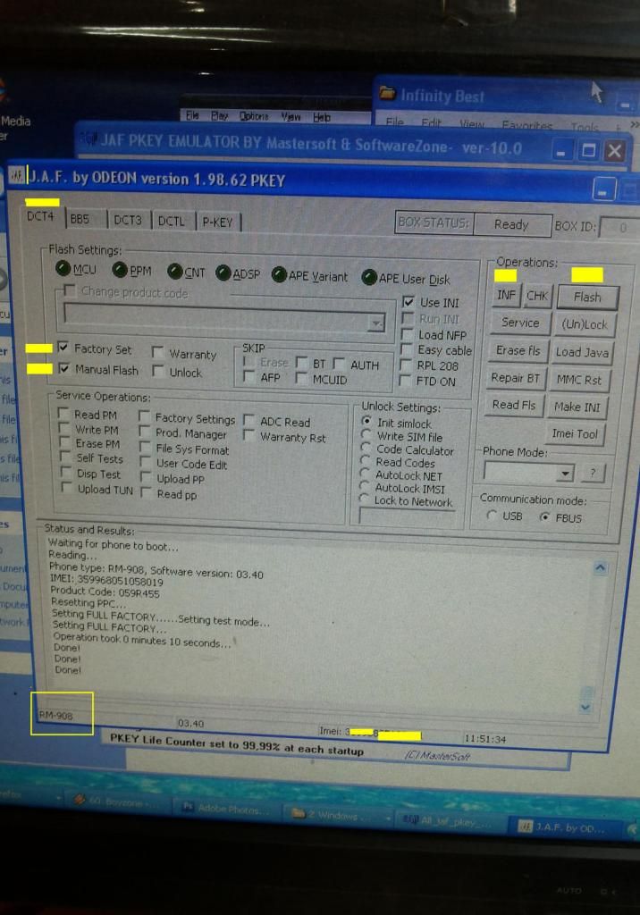

PAG NA COMPLETO NA ANG SET UP NG JAF
CLICK DCT4 CHECK FACTORY SET AT MANUAL FLASH
THEN CLICK INFO PAGKALABAS NG INFO MANG HINGI NG FIRMWARE IGNORE NYO LANG

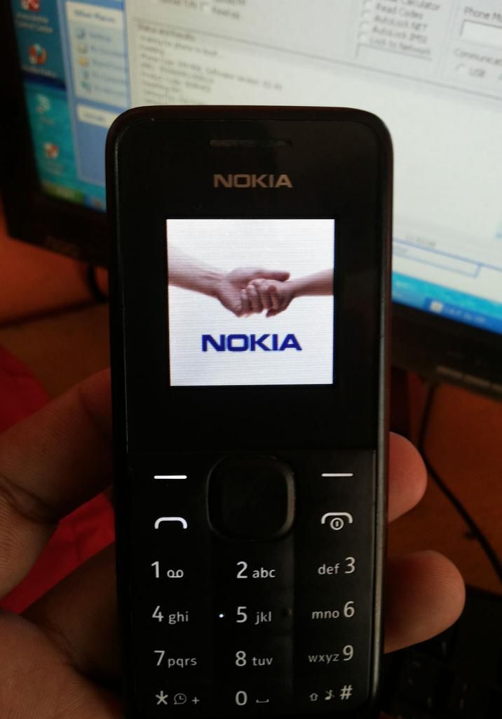

AT CLICK FLASH

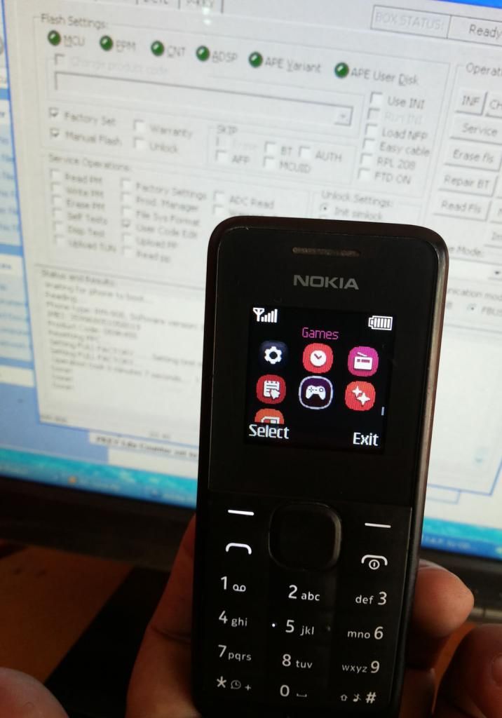

W8 NA MAG DONE AT PERA NA 250 Lng nga singil ko
yan na po
yan done sana hndi na kayo mahirapan mga walang HTI kaya pala ni jaf hehehe
