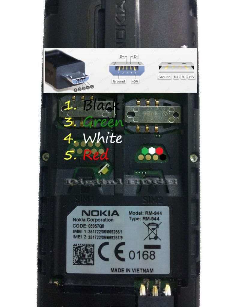

Nokia 108 Flashing with BEST | Drivers and Pinouts

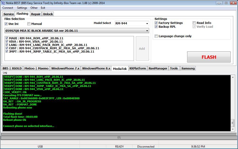

Flashing Procedure:
UI Command
Insert Battery
Connect USB

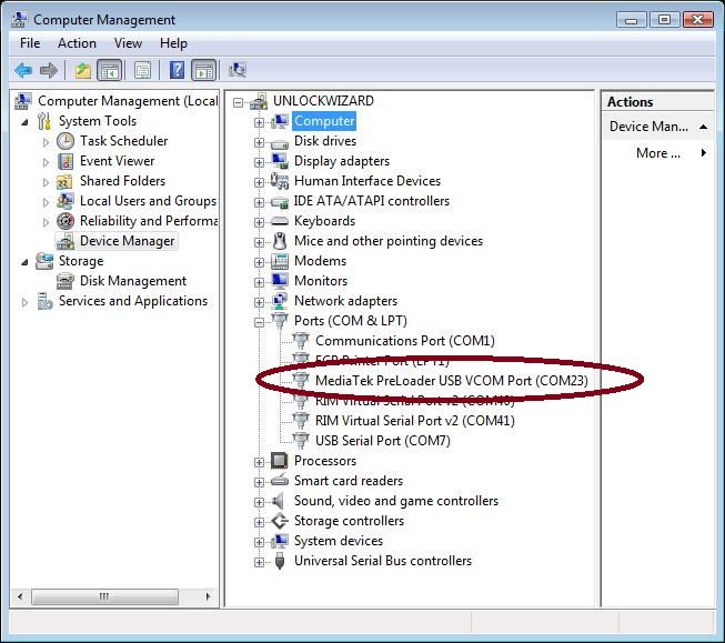

Drivers:
XP-Win7-Vista
