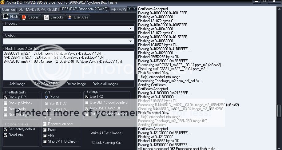

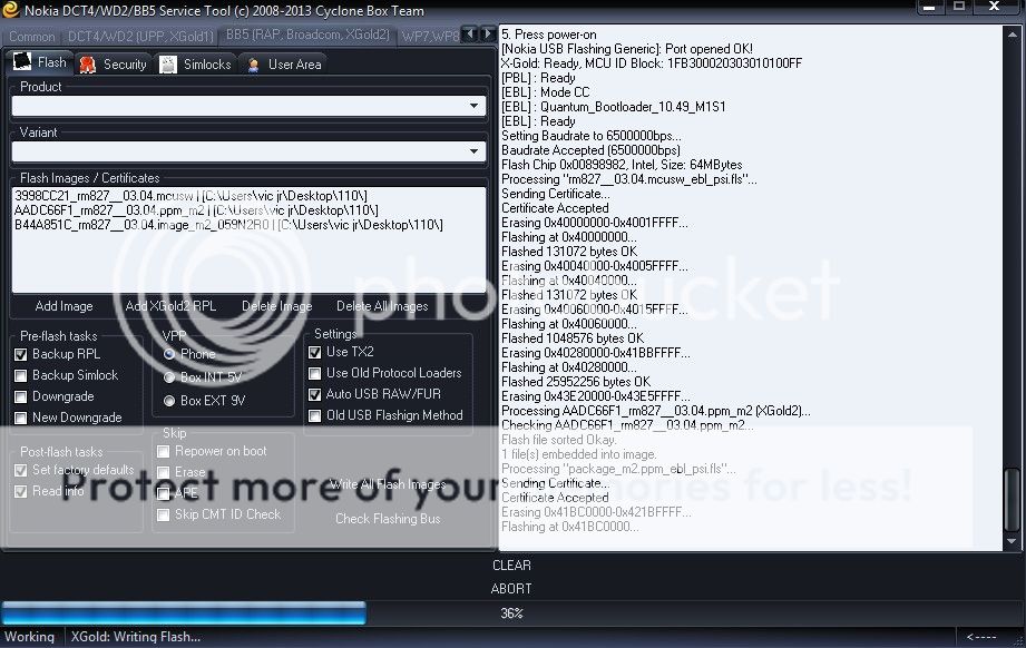

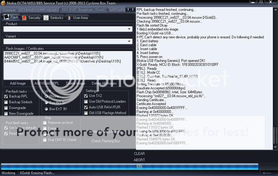

itong unit na ito ay naghahang po sa start up logo....
kaya need po nating reprogram, wala pong short at malinis po ang board...
para mareprogram natin kailanga nating pin out..
procedure;
open cyclone software...
click common and set usb for connection...
ilagay ang firmware...then click write flash image...
wait to finish to flash...
