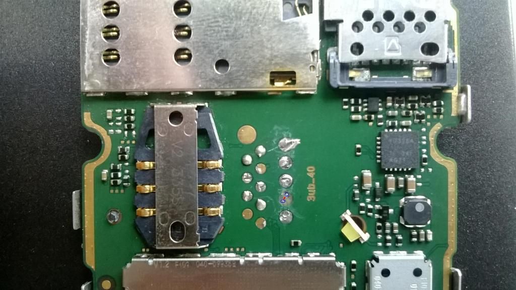

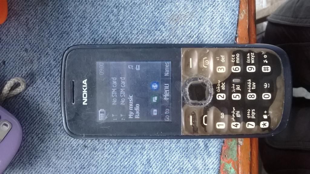

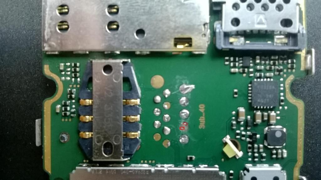

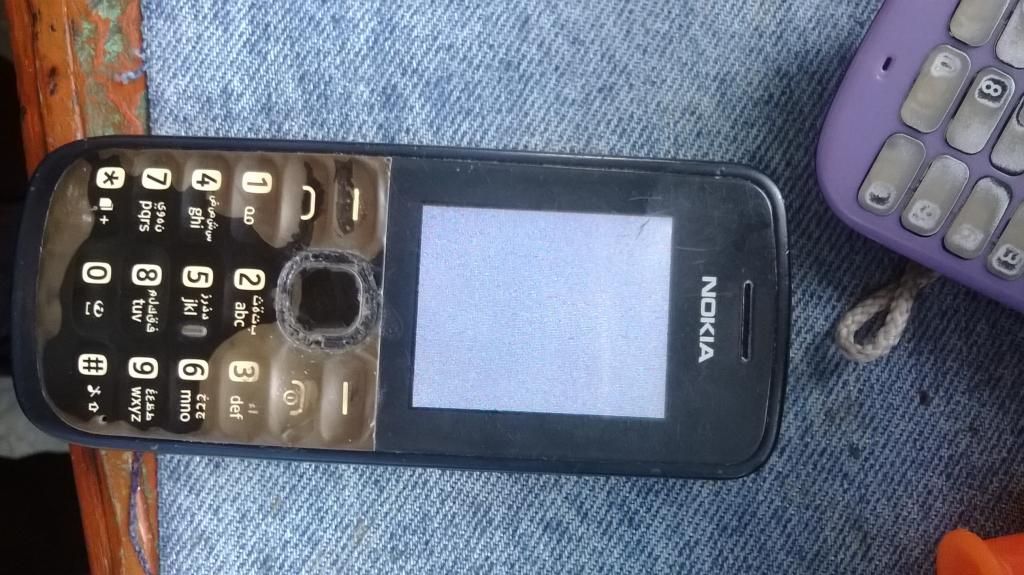

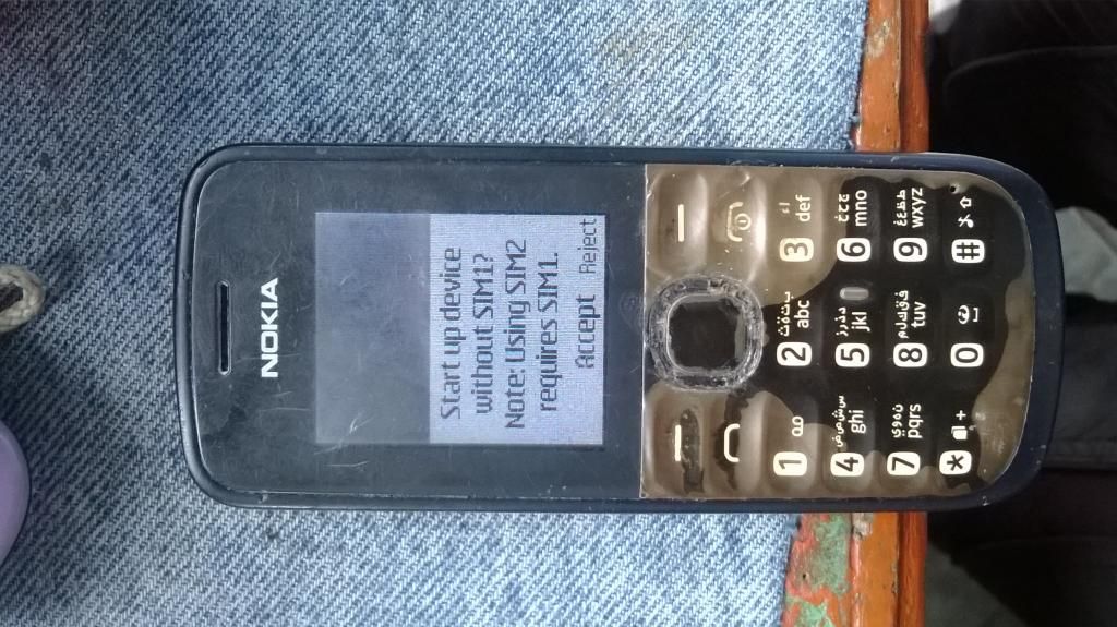

magandang araw po manga boss,,, gusto ko po ibahagi sa inyo itong gawa ko na nokia 110 galing po sa ibang shop,,,
eh nang na tingnan ko open pattern pala yong usb nya kaya d daw nkaya,,,

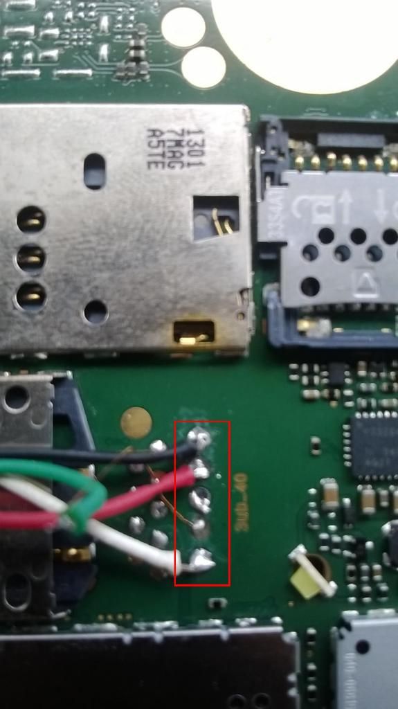

at kaagad ko nman po binuksan,,, at hinanap ko po kng meron pabang linya ito,,,, at d naman po ako na bigo,,, sa halos 2 oras na pag hahanap,,,
nakita ko nga itong dalawang linya na ito,,, na kala ko po isa lang pwede sa kanya,,,, pero hinpo ma program,,,sinubukan ko dn yng isa at gnon padin ang nang yari,,,, napag isip-isip ko png subukang itong dalawa na isasabay ko at ayon nga gumana,,,,

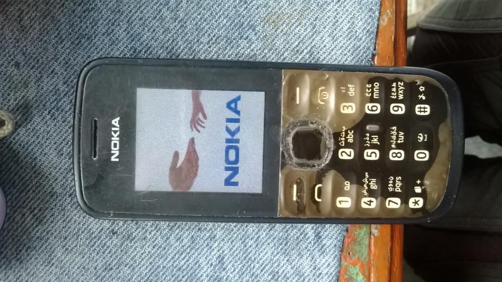

at ito po yng gnawa ko matapos kng nilagay ang usb
at natapos dn naman yng pag program,,,
at done na nga po,,,, sana po mka tulong...
ito po yng info nya po,,,card found: A1B5CCE8
registered to: MUKESH RAJ

Flashing done!
Total flash time : 00:07:57
Reboot phone now...
- > AfterFlash Failed!
Reason : Downgrade try or HW Error
Anyway - try reinsert battery and PowerUp phone manualy
Connect phone on selected interface...
Done!
Elapsed: 00:10:08

Speed accepted, use 6.500.000
FLASHID : 89008289
FLIC conf set, RST set
Boot done!
Backup enabled, will read all certificates
Reading CCC
Reading HWC
Reading NPC
IMEI 1 : 356687059288385
IMEI 2 : 356687059288393
PCcode : †éQJFÕÂ
NPC Certificate saved...
CCC Certificate saved...
HWC Certificate saved...
RPL saved : D:\cellphone tools\Cellphone Installer\best new\Backup\Cert\356687059288385_356687059288393_XG213_CRT.rpl
===Flashing [MCU]===
File : rm827__03.04.mcusw
Image : rm827__03.04.mcusw_ebl_psi.fls
Cert block found, sending....
Cert sent
Found 5 region(s)
Processing Region 1/5
Erase , Start : 0x40000000 , Len : 0x00020000
Erasing, wait ...
Erase done, time : 00:00:00
Write , Start : 0x40000000 , Len : 0x00020000
Flashing , wait ...
Region flash done, time : 00:00:00
Processing Region 2/5
Erase , Start : 0x40040000 , Len : 0x00020000
Erasing, wait ...
Write , Start : 0x40040000 , Len : 0x00020000
Flashing , wait ...
Processing Region 3/5
Erase , Start : 0x40060000 , Len : 0x00100000
Erasing, wait ...
Erase done, time : 00:00:04
Write , Start : 0x40060000 , Len : 0x00100000
Flashing , wait ...
Region flash done, time : 00:00:01
Processing Region 4/5
Erase , Start : 0x40280000 , Len : 0x01940000
Erasing, wait ...
Erase done, time : 00:02:00
Write , Start : 0x40280000 , Len : 0x018C0000
Flashing , wait ...
Region flash done, time : 00:00:48
Processing Region 5/5
Erase , Start : 0x43E20000 , Len : 0x00040000
Erasing, wait ...
No write data, skip
===Flashing [PPM]===
File : rm827__03.04.ppm_m1
Image : package_m1.ppm_ebl_psi.fls
Cert sent
Found 1 region(s)
Processing Region 1/1
Erase , Start : 0x41BC0000 , Len : 0x00600000
Erasing, wait ...
Erase done, time : 00:00:23
Write , Start : 0x41BC0000 , Len : 0x003DF0A4
Flashing , wait ...
Region flash done, time : 00:00:05
===Flashing [CNT]===
File : rm827__03.04.image_m1_059N416
Image : package_m1_059N416.image.fls
Cert sent
Found 2 region(s)
Processing Region 1/2
Erase , Start : 0x421C0000 , Len : 0x01C60000
Erasing, wait ...
Erase done, time : 00:03:54
Write , Start : 0x421C0000 , Len : 0x00E40000
Flashing , wait ...
Region flash done, time : 00:00:29
Processing Region 2/2
Erase , Start : 0x43E60000 , Len : 0x000E0000
Erasing, wait ...
Erase done, time : 00:00:07
No write data, skip
Flashing done!
Reboot phone now...
Reason : Downgrade try or HW ErrorAnyway - try reinsert battery and PowerUp phone manualy
Done!
Elapsed: 00:10:08
