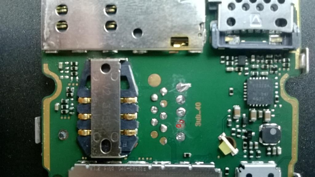

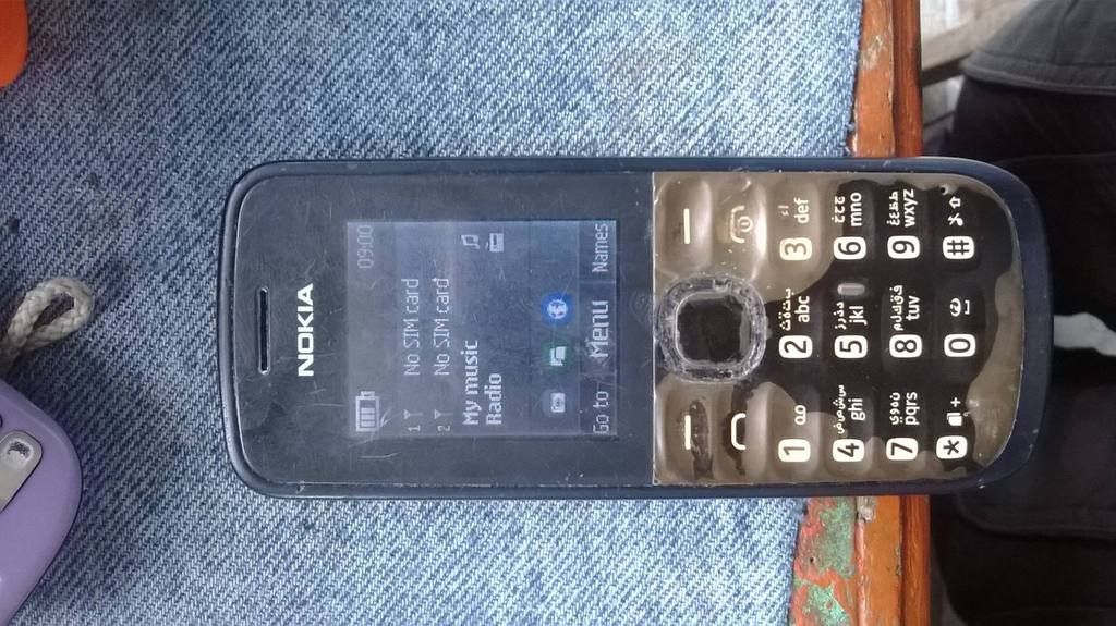

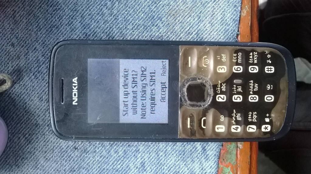

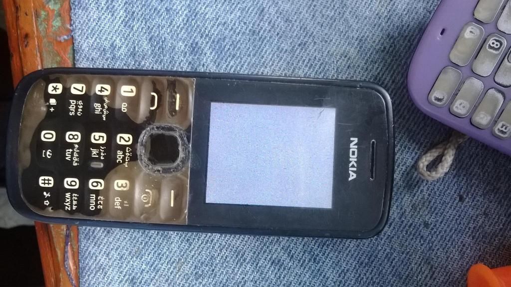

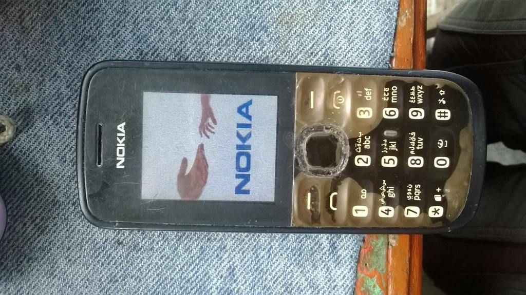

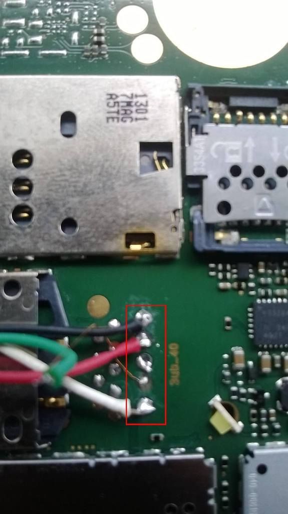

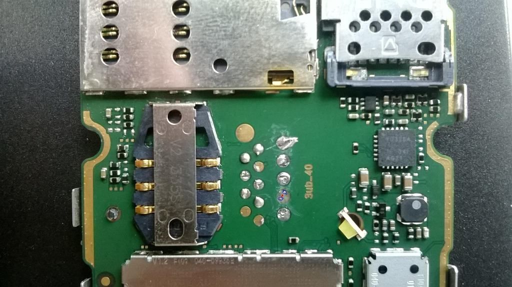

good day manga boss,,, gusto ko sana ibahagi sa inyo itong munting gawa ko
nokia 110 open pattern yong green na usb,,,
nong tanggap ko mula sa ibang shope,
sinubukan daw programin nang iba ngunit bigo sila,,, dahil nga may open pattern ito,,,,
ang nag sinimulan ko mag hukay nang pa kunti2x sa bord nito e may na pansin ako na bilog pag minamasdan mo mabuti,,,, at kiniskis ko itong dalawa na to,, sinubukan ko yong isa lang ang lagyan eh ayaw,,,, at nang sinubukan ko olit yng isa pa ganon parin,,,,,,napag isip2x ko na sabayin itong dalawa na to
aba gumana nga,,,,at nang natapos sinubukan ko ito,,,,
at done na po,,, ito po yng info nya po,,,card found: A1B5CCE8

sana maka tulong,,,,

Reading CCC
Reading HWC
Reading NPC
IMEI 1 : 356687059288385
IMEI 2 : 356687059288393
PCcode : †éQJFÕÂ
NPC Certificate saved...
CCC Certificate saved...
HWC Certificate saved...
RPL saved : D:\cellphone tools\Cellphone Installer\best new\Backup\Cert\356687059288385_356687059288393_XG 213_CRT.rpl
===Flashing [MCU]===
File : rm827__03.04.mcusw
Image : rm827__03.04.mcusw_ebl_psi.fls
Cert block found, sending....
Cert sent
Found 5 region(s)
Processing Region 1/5
Erase , Start : 0x40000000 , Len : 0x00020000
Erasing, wait ...
Erase done, time : 00:00:00
Write , Start : 0x40000000 , Len : 0x00020000
Flashing , wait ...
Region flash done, time : 00:00:00
Processing Region 2/5
Erase , Start : 0x40040000 , Len : 0x00020000
Erasing, wait ...
Write , Start : 0x40040000 , Len : 0x00020000
Flashing , wait ...
Processing Region 3/5
Erase , Start : 0x40060000 , Len : 0x00100000
Erasing, wait ...
Erase done, time : 00:00:04
Write , Start : 0x40060000 , Len : 0x00100000
Flashing , wait ...
Region flash done, time : 00:00:01
Processing Region 4/5
Erase , Start : 0x40280000 , Len : 0x01940000
Erasing, wait ...
Erase done, time : 00:02:00
Write , Start : 0x40280000 , Len : 0x018C0000
Flashing , wait ...
Region flash done, time : 00:00:48
Processing Region 5/5
Erase , Start : 0x43E20000 , Len : 0x00040000
Erasing, wait ...
No write data, skip
===Flashing [PPM]===
File : rm827__03.04.ppm_m1
Image : package_m1.ppm_ebl_psi.fls
Cert sent
Found 1 region(s)
Processing Region 1/1
Erase , Start : 0x41BC0000 , Len : 0x00600000
Erasing, wait ...
Erase done, time : 00:00:23
Write , Start : 0x41BC0000 , Len : 0x003DF0A4
Flashing , wait ...
Region flash done, time : 00:00:05
===Flashing [CNT]===
File : rm827__03.04.image_m1_059N416
Image : package_m1_059N416.image.fls
Cert sent
Found 2 region(s)
Processing Region 1/2
Erase , Start : 0x421C0000 , Len : 0x01C60000
Erasing, wait ...
Erase done, time : 00:03:54
Write , Start : 0x421C0000 , Len : 0x00E40000
Flashing , wait ...
Region flash done, time : 00:00:29
Processing Region 2/2
Erase , Start : 0x43E60000 , Len : 0x000E0000
Erasing, wait ...
Erase done, time : 00:00:07
No write data, skip
Flashing done!
Total flash time : 00:07:57
Reboot phone now...
- > AfterFlash Failed! Reason : Downgrade try or HW Error
Anyway - try reinsert battery and PowerUp phone manualy
Connect phone on selected interface...
Done!
Elapsed: 00:10:08
