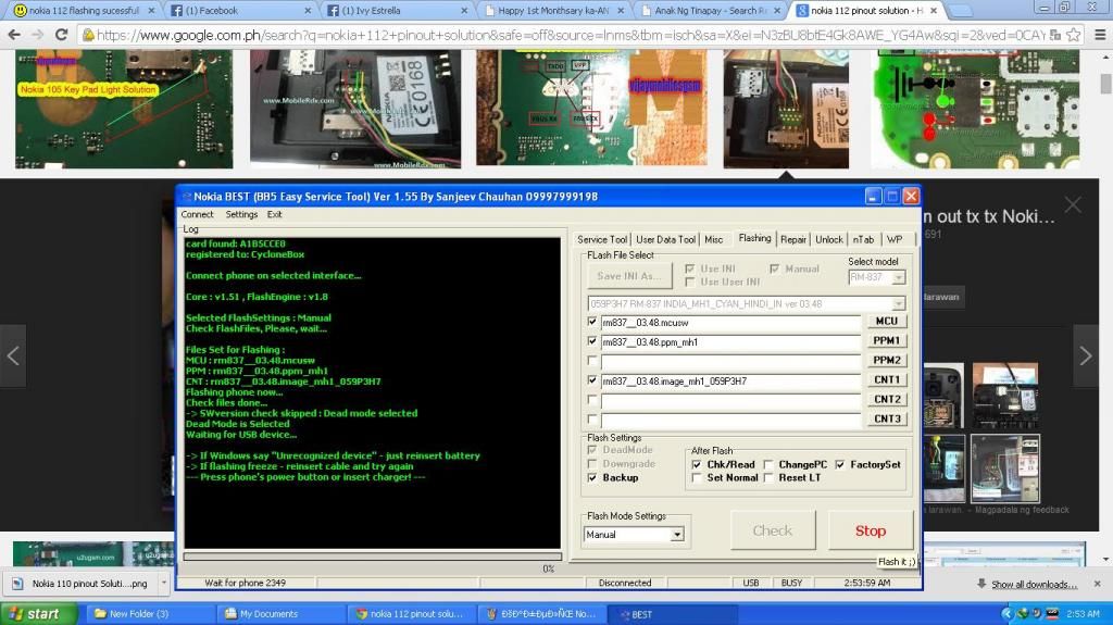

hanap ako dito satin meron kay anakngtinapayII.. http://www.anakngtinapay.com/showthread.php?t=14969&highlight=nokia+112+security kaso pagpindot ko ng power on shortly..
SWversion check skipped : Dead mode selected
Dead Mode is Selected
Waiting for USB device...
-> If Windows say "Unrecognized device" - just reinsert battery
-> If flashing freeze - reinsert cable and try again
--- Press phone's power button or insert charger! ---
-> Phone not found..
-> Boot fail...
Flashing failed...
hanap kay google... :fishing: ump marami.. kaso pareho din procedure kay anakngtinapayII

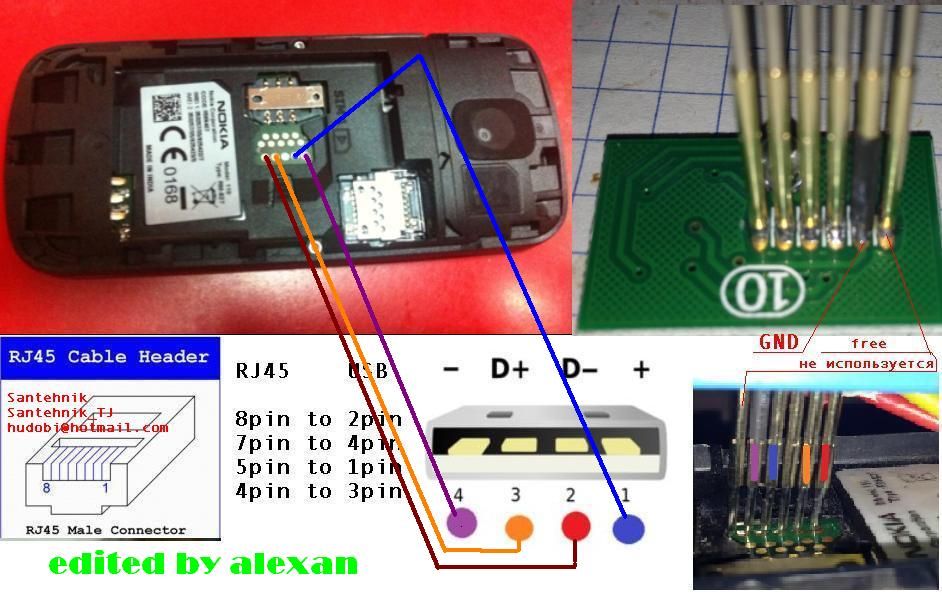

naisip ko ung ibang bb5 direct usb.. minsan ginagawa ko pagsalpak ng usb babasahin at magra run agad ang Infinity BEST.. kaya isip isip at ito ang natuklasan ko..
procedure muna
tools: ca-101 cable at putulin ang dulo

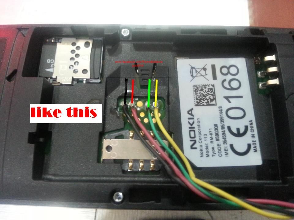

ito ang sampol
ito naman po ang tamang linya ng paghinang ng connection.. edit ko lang po yan

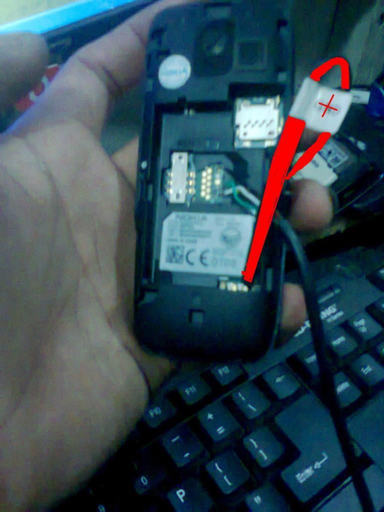

ngaun po tanggalin ang positive (red) at lagyan ng alligator clip....
SALPAKAN NA RIN NG CHARGER.. standby..........:fishing:

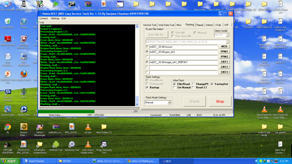

dito naman tayo sa InfinityBox BEST
download mo muna itong file na to kung wala ka pa
http://files.gsmmobilecare.com/Download/Nokia_MCU,PPM,CNT/112_RM-837/Nokia 112 (RM-837) 3.48.zip
set up infinityBEST
factorySET == chick
deadMODE == chick
then FLASH
SALPAK NG alligator clip SA POSITIVE TERMINAL NG BATTERY..
AUTO RUN NA PO YAN.. WAITING LANG........

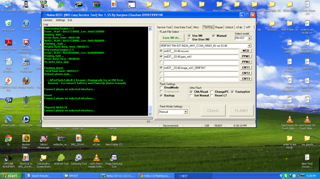

PARANG GANITO
at ito ang huli.. kala mo nakapatay ka na ng unit pero pagtiningnan mo ang screen
naka TESTMODE
TANGGAL ANG LAHA NG HINAN AT OK NAPO YAN..
