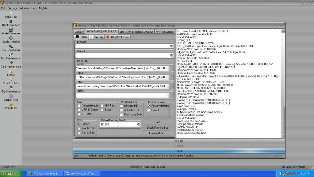

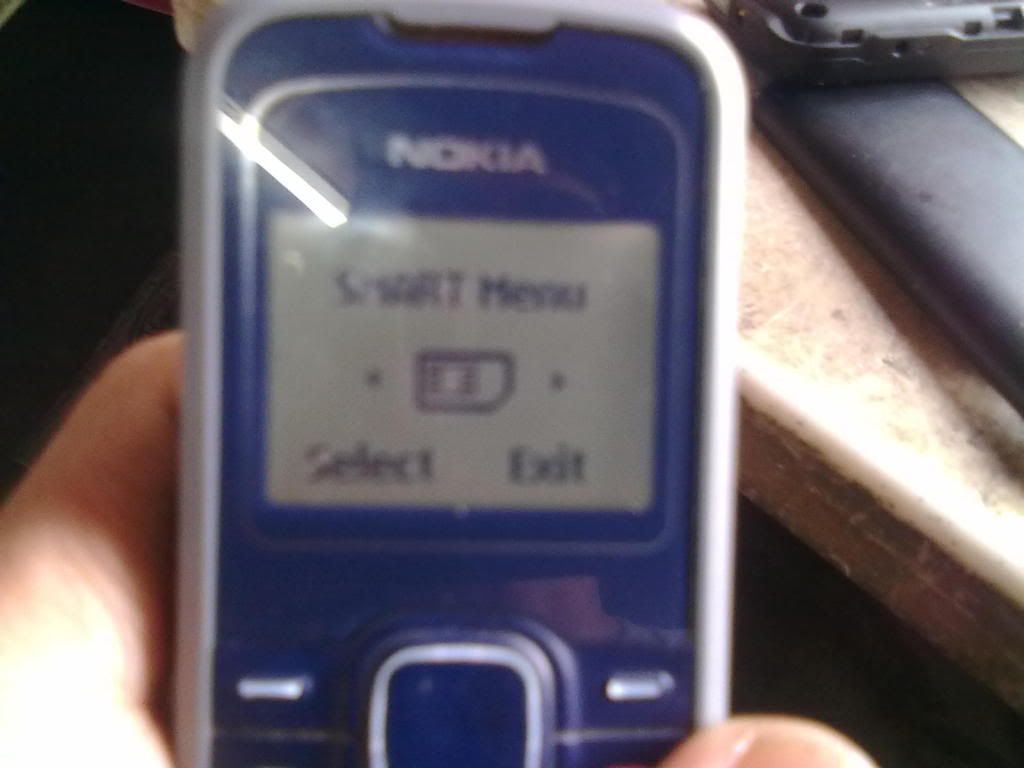

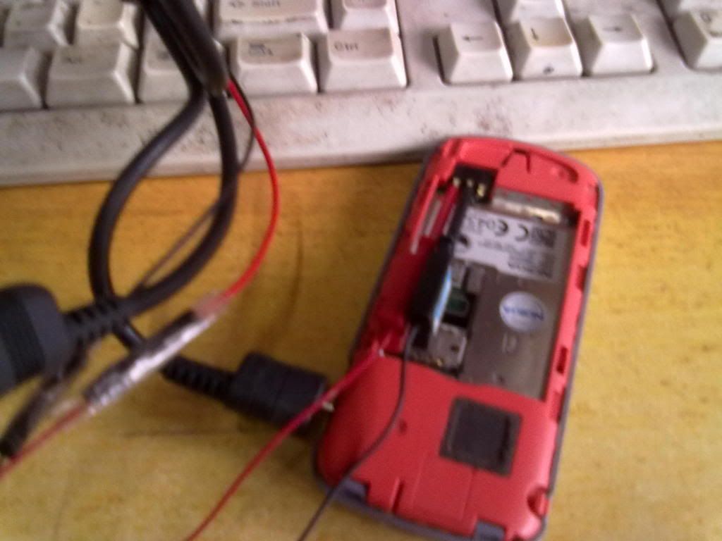

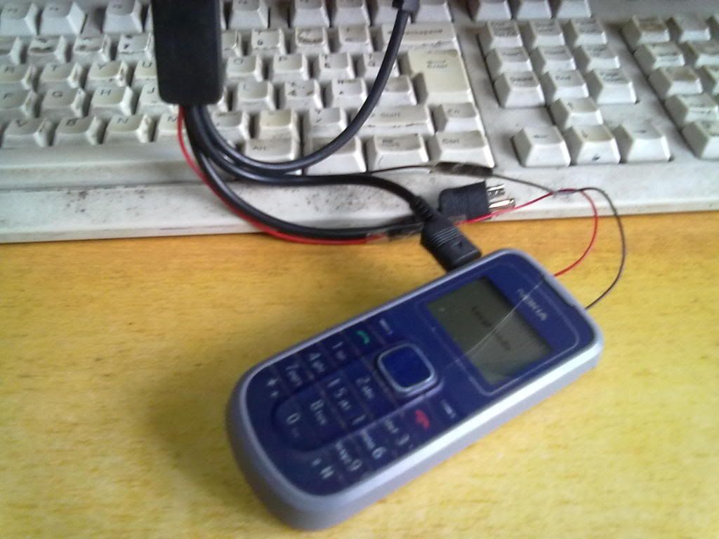

Procedures
1. Open cyclone software
2. Go to dct4 tab
3. Add mcu, ppm &cnt flashfiles of Nokia 1202 rh-112
4. Use easy cable ,rj45 1202 cable or ufc cable
5. Click Flash
6. Done
Logs:
Handling device: [Cyclone Team], [Cyclone Bootloader], [Platform: Classic]
Handling device: [Cyclone Team], [Cyclone Box], [Platform: Classic]
Initializing box...
Box Firmware: Cyclone Nokia/Blackberry Application v01.88, (Feb 14 2012 01:59:38, gcc v4.3.3, RTOS V6.0.1), Type: Signed Production Application, (C) KarwosSoft 2011
Hardware Platform: Cyclone Classic Flasher Interface (c) 2008,2009 KarwosLabs
Box Serial Number: C000xxxx
HW Revision: A, Suitable for: Production, Case: First Plastic Case, MCU Manufacture Time: 2009, wk19
Initializing security card...
Card Serial Number: D0000xxx
Card Firmware Revision: 0109
Card is activated
Box is activated
Started box selftests procedure
USB Voltage 4.84v PASSED
MCU Voltage 3.30v PASSED
Core Voltage 1.77v PASSED
VBAT Voltage 0.01v PASSED
VBAT Voltage 4.78v PASSED
Box VPP disabled
VPP Voltage 0.02v PASSED
Internal Box VPP Enabled
VPP Voltage 4.92v PASSED
Box VPP disabled
External Box VPP Enabled
VPP Voltage 0.02v FAILED - IGNORED - Probably power supply is not connected
Box VPP disabled
All box selftests passed!
Super DCT4 Activation: TRUE
XGold/Blackberry Service Running, Credits Left: 100
Avaiable Physical Memory: 205.40MB
Avaiable Virtual Memory: 1.481GB
Avaiable Pagefile: 1.253GB
Initializing FBUS...
All initialized - Ready to work
Processing pre-flash tasks...
Pre-flash tasks finished
Booting UPP...
UPP ID: 2293 [HW_UNKNOWN]
rh112_004.030, Type: Flash Image, Algo: DCT4, DCT4 ALGORITHM
Flashbus Write baud set to 100Kbits
u3_2nd.fia, Type: 2nd Boot Loader, Rev: 7.4.79.0, Algo: DCT4
Box VPP disabled
Internal Phone VPP Selected
PLL Factor: 3
FlashChip[0]: 0x00EC2606 @ 0x01000000, Samsung, SectorSize: 64kB, Ext: 00000222
Signature: AD7EB61A23100340C605E40120A26514
Flashbus Write baud set to 1.0Mbits
Flashbus Read baud set to 51Kbits
u3_amd.fia, Type: Algorithm, Target: FlashChip[0] 0x00EC2606 (32Mbits), Rev: 7.4.79.0, Algo: DCT4 ALGORITHM
Nominal VPP Voltage: 9V, Detected: 0.02V
MSID-Crypted: 8479EBDF19C1E5F0EC788B8081
MSID-Plain: 3E4EBAE900C62115A9000000
FAID-Crypted: 6B57C7CC55443D82BFBCDA68
Flashbus Write baud set to 6.50Mbits
5 Region(s) to erase
Erasing NOR Region [0x01000000-0x0100FFFF]
Erasing NOR Region [0x01010000-0x013AFFFF]
Erasing NOR Region [0x013B0000-0x013EFFFF]
Erasing NOR Region [0x017C0000-0x017EFFFF]
Erasing NOR Region [0x01FC0000-0x01FEFFFF]
Erase taken 22.893s
Writing 148 blocks...
All blocks written OK! Time taken 28.711s
Terminating flash session
Box VPP disabled
Booting UPP...
rh1120_nai04.03el, Type: Flash Image, Algo: DCT4, DCT4 ALGORITHM
Box VPP disabled
PLL Factor: 3
Nominal VPP Voltage: 9V, Detected: 0.04V
Using MSID-FAID Cache, Not wasting card
1 Region(s) to erase
Erasing NOR Region [0x01380000-0x013AFFFF]
Erase taken 1.51s
Writing 8 blocks...
All blocks written OK! Time taken 1.742s
Extracting Content Package...
CP Server: File Server fake reply for CUI phone.
CP Extract Failed -> CP Not Extracted, Code: 1
WARNING: Failed to extract CP
Box VPP disabled
Booting UPP...
rh112_004.03el, Type: Flash Image, Algo: DCT4, DCT4 ALGORITHM
Box VPP disabled
PLL Factor: 3
MSID-Crypted: 84EA80552EAF7BC6DA6DA21BF8
MSID-Plain: 3E4EBAE900C62115A8000000
FAID-Crypted: B7CB3B8AE62E64C2F04F1A34
2 Region(s) to erase
Erasing NOR Region [0x01240000-0x0124FFFF]
Erasing NOR Region [0x01250000-0x0137FFFF]
Erase taken 7.0s
Writing 63 blocks...
All blocks written OK! Time taken 12.889s
Box VPP disabled
Processing post-flash tasks...
Setting Factory Defaults...
Factory defaults OK
Post-flash tasks finished...
Flash successfully finished!
