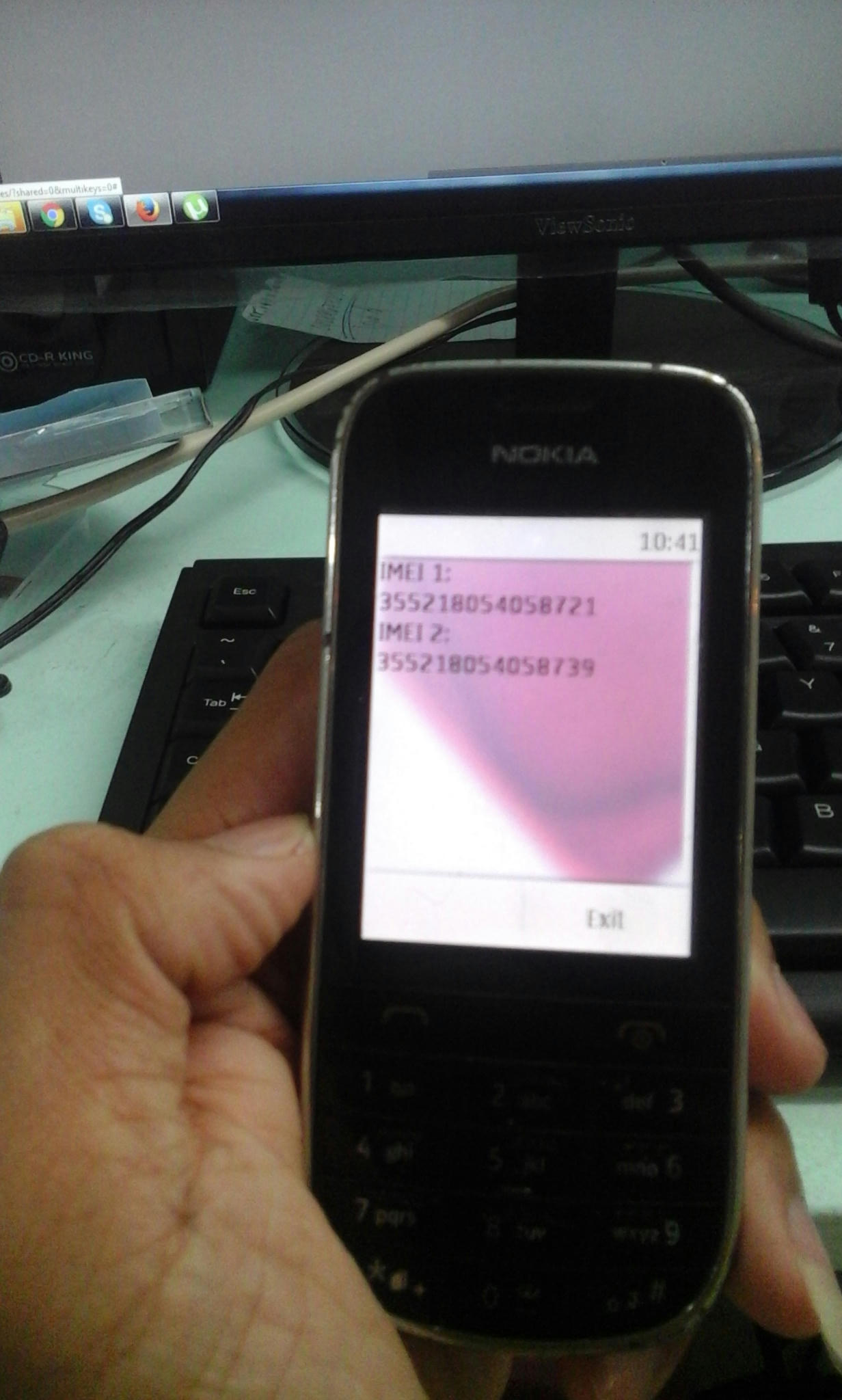

GANDANG araw ka ant..bahagi ko lang tong nagawa ko kahapon na NOKIA 202 RM-834..
STATUS: pag e power mo ang unit hanggang MENU lang at mag o off cia...
OPTION: PALITAN ng bagong battery o software na po cia..
pinalitan ng bagong battery hindi parin ..ganon parin mag o off po cia pagdating sa MENU
kaya na isip ko software na po...
itong ginawa ko ..
open po INFINITY BEST crack po gamit ko kasi alams na..
sundan lang po ang nasa larawan ..
http://www.mediafire.com/convkey/5f8b/aur36qa3dl3wre4zg.jpg
proced na po sa flashing..
http://www.mediafire.com/convkey/595c/efw5cbo718mx5z9zg.jpg
intay lang po hanggang matapos..
http://www.mediafire.com/convkey/40fc/cpb3mhpqgddm31vzg.jpg
DONE
http://www.mediafire.com/convkey/6e7e/f9c63xs6u856xdhzg.jpg
http://www.mediafire.com/convkey/d623/rycom0wju8k8jsczg.jpg
ok po yung IMEI
http://www.mediafire.com/convkey/a0f1/ae2z8bt37zbc3b4zg.jpg
DITO PO AKO KUMUHA NG FIRMWARE:http://gsmsony.blogspot.com/2015/04/nokia-asha-202-rm-834-latest-flash_1.html yung latest po yung ginamit ko....
thank you po ..sana makatulong ..
