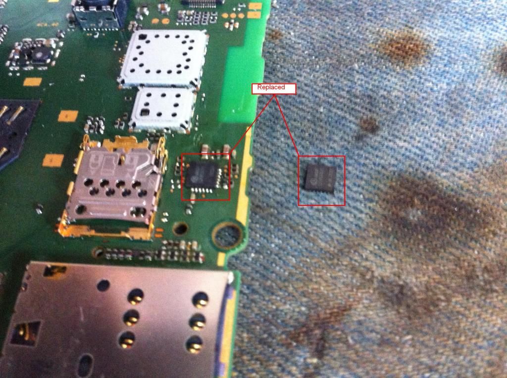

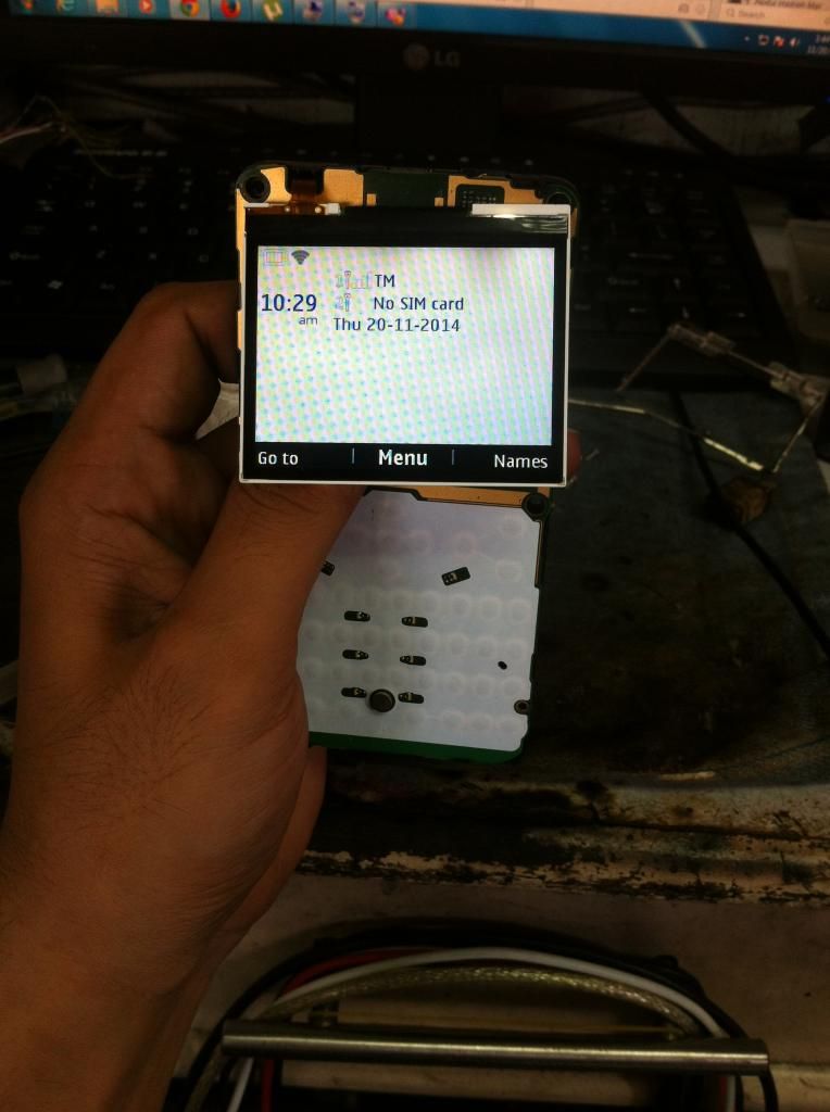

Seya Super Moderator Staff member Joined Jun 12, 2014 Messages 973 Reaction score 119 Points 81 Location quezon city Nov 21, 2014 #1 Problem Can't read simcard sim slot 1/2 kahit anong sim nabasa daw kasi Action Taken Dissamble unit then clean first check kung may corroded parts then check simways kung may putol na linya pero buo last replaced sim ic and done Done... Sana makatulong po
flame Registered Joined Jun 19, 2014 Messages 155 Reaction score 0 Points 1 Nov 21, 2014 #2 congrats boss
