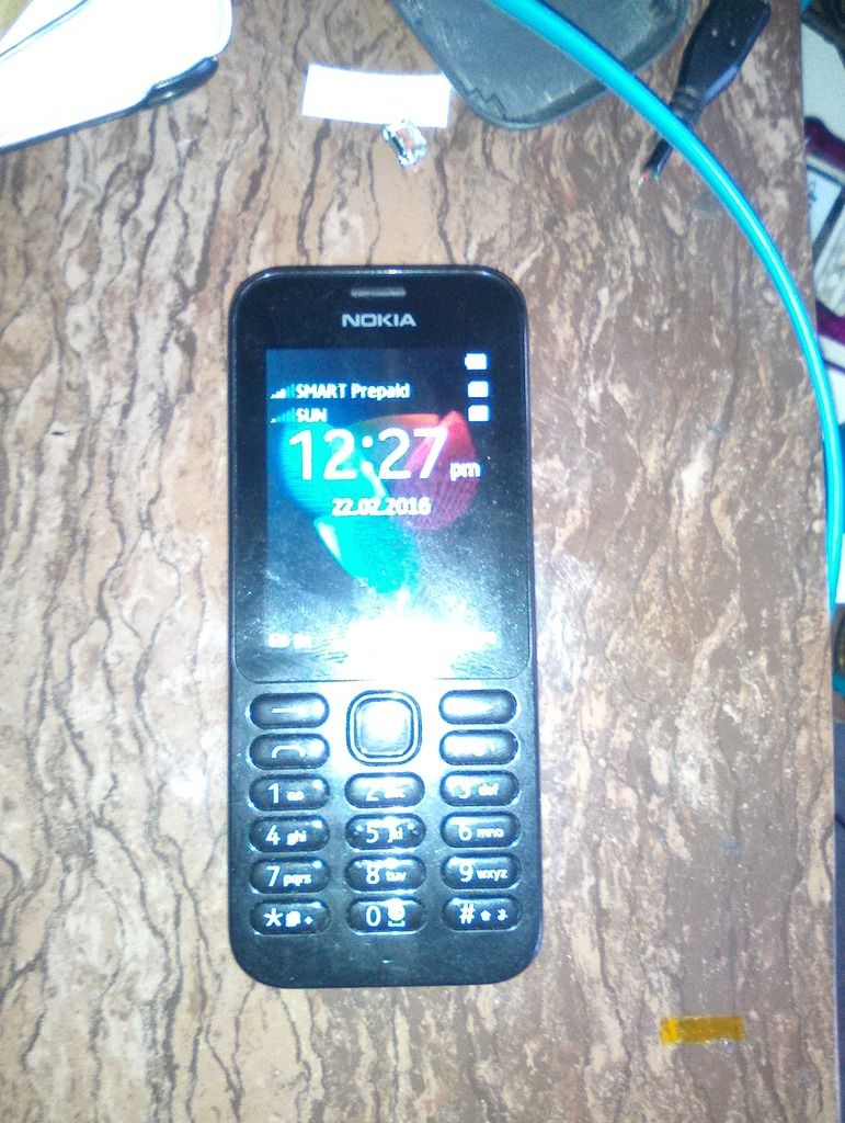

PROBLEM
Security Code

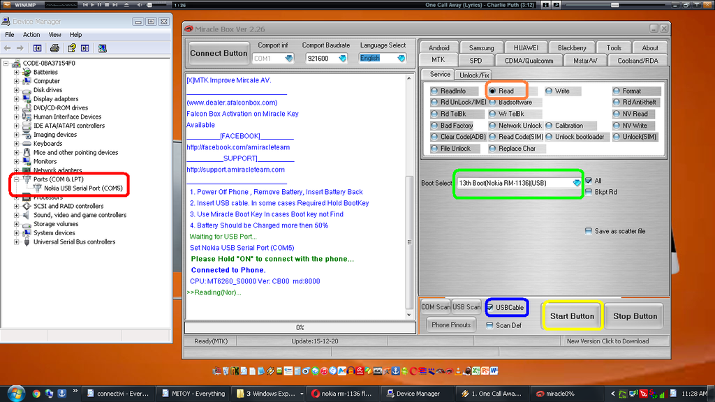

Open Miracle Crack V2.26
Tick Read
Select 13th Boot (Nokia Rm-1136)(usb)
Start Button
Off your phone
Insert your micro usb
Wait until device recognize..
(Auto Boot Mode)

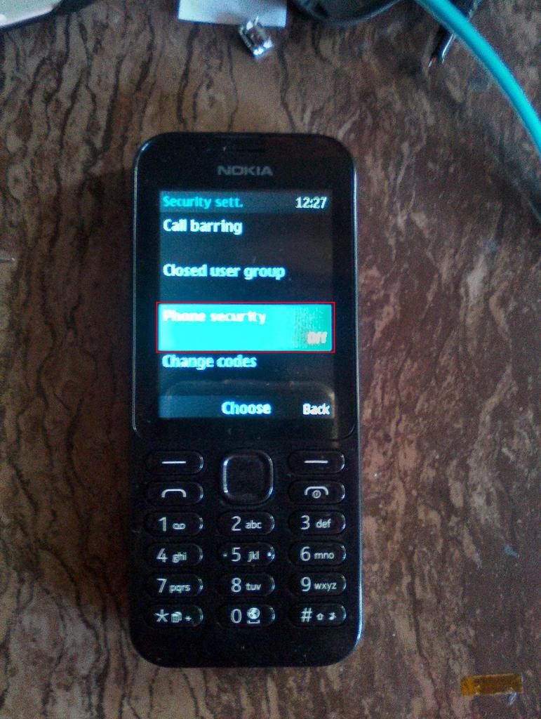

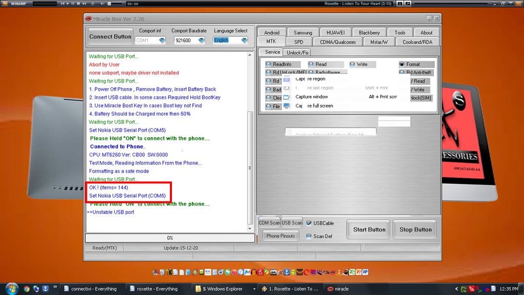

After finished to Back Up
Tick Format
Safe Mode
Click Start And Your Done!!!!
DONE!!!
