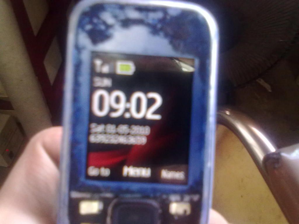

Nokia 2330c Hang done via Cyclone Flashing[Reference]
AltF4
Sep 3, 2014
1,285
7
181
Procedures:
1. Go to dct4 tab
2. Add mcu, ppm & cnt files

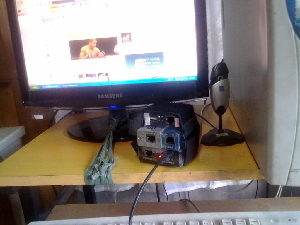

3. Attach easy cable & click flash
4. You’re all done
Establishing Connection with Box in Main Mode...
Handling device: [Cyclone Team], [Cyclone Box], [Platform: Classic]

Flash successfully finished!
