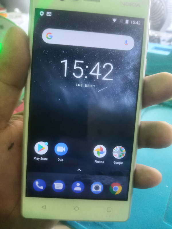

Nokia 3 TA-1028 nireset ng tumer d alam google acct, done via (mrt dongle)
FRP/Google Acct.

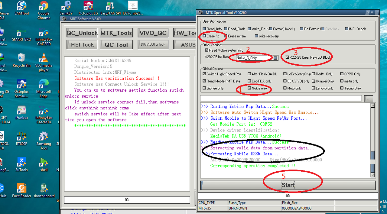

procedure
open MRT Software
1. select Nokia Only
2. Then, select Options Nokia_3_Only
3 and check Create New GPT Block.
4. Select Erase FRP
5. Click start.
6. off the unit..Hold Volume up then connect phone sa usb
wait until done....
done...
