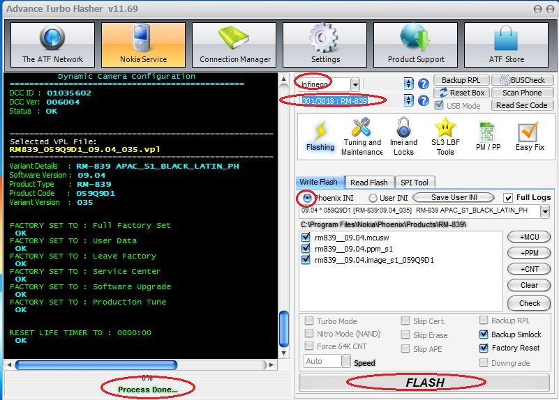

For reference po sa mga atf user lalo na sa mga newbei
unit : Nokia 301

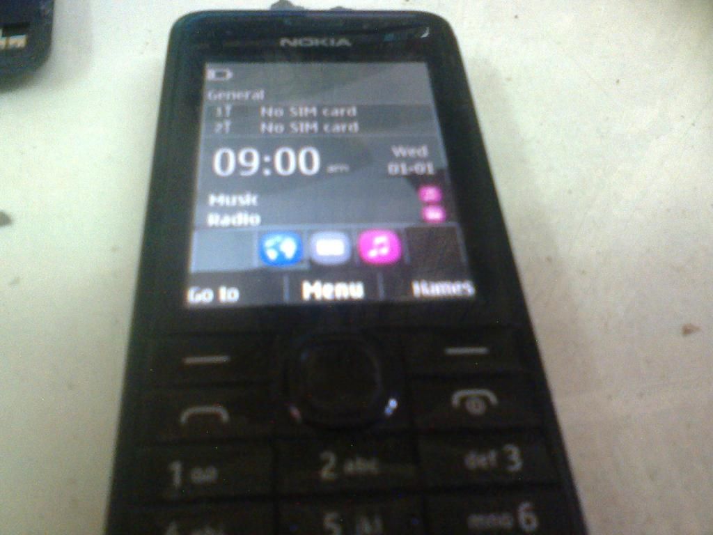

problem : auto shut off
solution : full flash
gadget : atf box
procedure:
*open atf software
*select infineon
*select correct model
*click phoenix ini(para po automatic mag load mcu,ppm,cnt)
*click flash

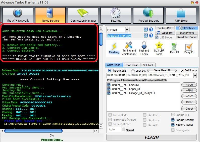

*insert usb install all driver

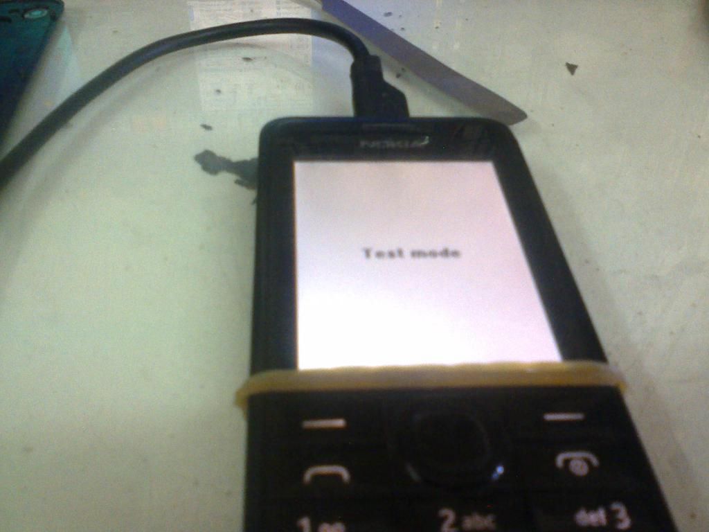

*wait all process done
kung di madetect ang phone sundin lang step by step
finish
tested firmware
