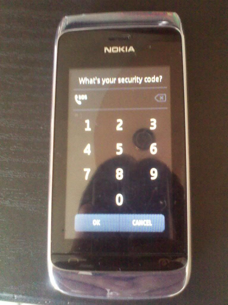

Nokia 310 Dual Sim Security Code Problem [SOLVED]
mga sir share ko lng po etong
nokia 310 security code.

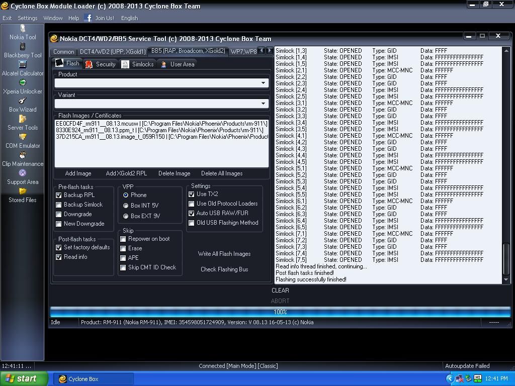

Tool's
* Cyclone box
* USB micro or kilala sa tawag na usb 5310
Action Taken:
1. Down Load Here firmware, type nyo lng product code sa sticker
2. open Cyclone Box, go to Nokia, and Common set USB conection.
3. click BB5 xgold2, and Click Add Image.
4. input MCU, PPM, Image, And Click Write Flash Image.
5. connect ang Unit sa PC, and Wait until finish

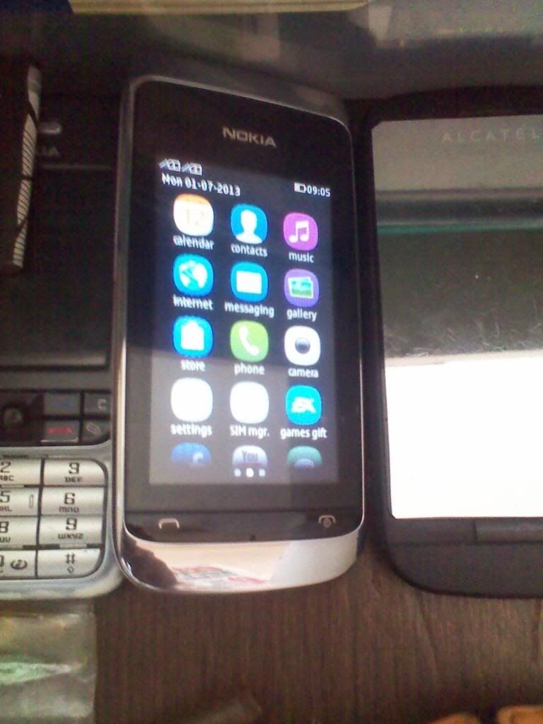

Done
