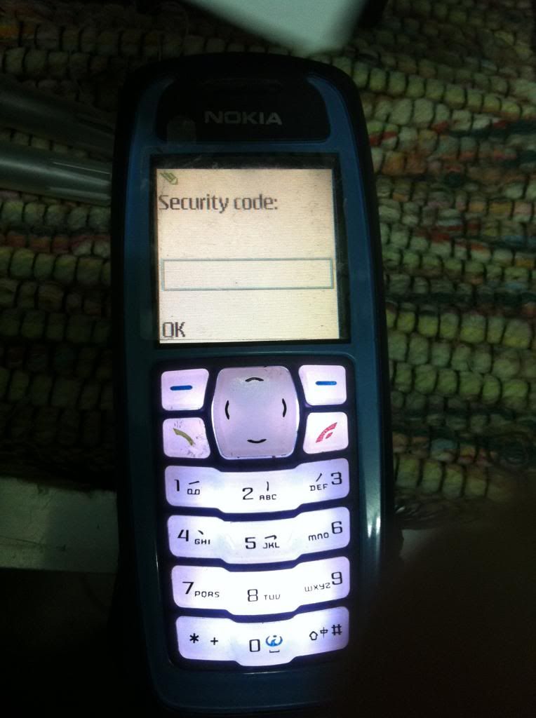

Nokia 3100 security code [Reference]
uwian time na sana pero may dumating pang
may mag papaalaala ng nakaraan
nakakamiss magrepair ng ganito..
pahirapan magconect pa tulad dati pa rin..
3100 security code done....
450 lang naman.....

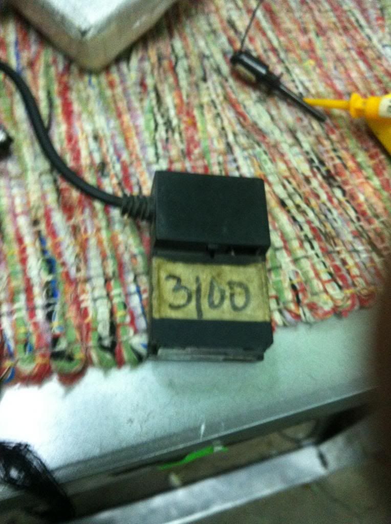

buhay pa cable ko....
Last 2003 ung price na yan..

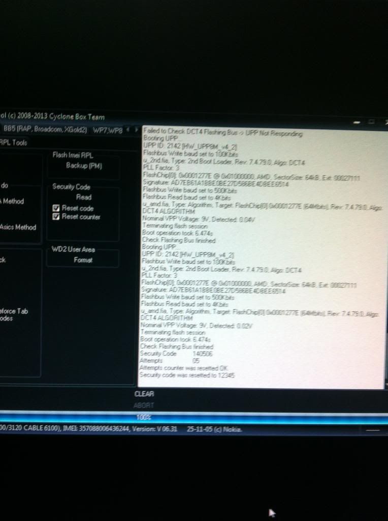

All initialized - Ready to work
Booting UPP...
Failed to Check DCT4 Flashing Bus -> UPP Not Responding
Booting UPP...
Sending User Abort Signal...
Booting UPP...
Booting UPP...
UPP ID: 2142 [HW_UPP8M_v4_2]
Flashbus Write baud set to 100Kbits
u_2nd.fia, Type: 2nd Boot Loader, Rev: 7.4.79.0, Algo: DCT4
PLL Factor: 3
FlashChip[0]: 0x0001277E @ 0x01000000, AMD, SectorSize: 64kB, Ext: 00027111
Signature: AD7EB61A1BBE0BE27D586BE4DBEE6514
Flashbus Write baud set to 500Kbits
Flashbus Read baud set to 4Kbits
u_amd.fia, Type: Algorithm, Target: FlashChip[0] 0x0001277E (64Mbits), Rev: 7.4.79.0, Algo: DCT4 ALGORITHM
Nominal VPP Voltage: 9V, Detected: 0.04V
Terminating flash session
Boot operation took 6.911s
Check Flashing Bus finished
Booting UPP...
PLL Factor: 3
Boot operation took 6.474s
CBUS Request Error -> User abort
Failed to Read Security Code -> Phone not detected
Booting UPP...
Booting UPP...
PLL Factor: 3
Nominal VPP Voltage: 9V, Detected: 0.02V
Booting UPP...
PLL Factor: 3
Booting UPP...
PLL Factor: 3
Boot operation took 6.458s
Booting UPP...
Booting UPP...
PLL Factor: 3
Booting UPP...
PLL Factor: 3
Security Code 140506
Attempts 05
Attempts counter was resetted OK
Security code was resetted to 12345
