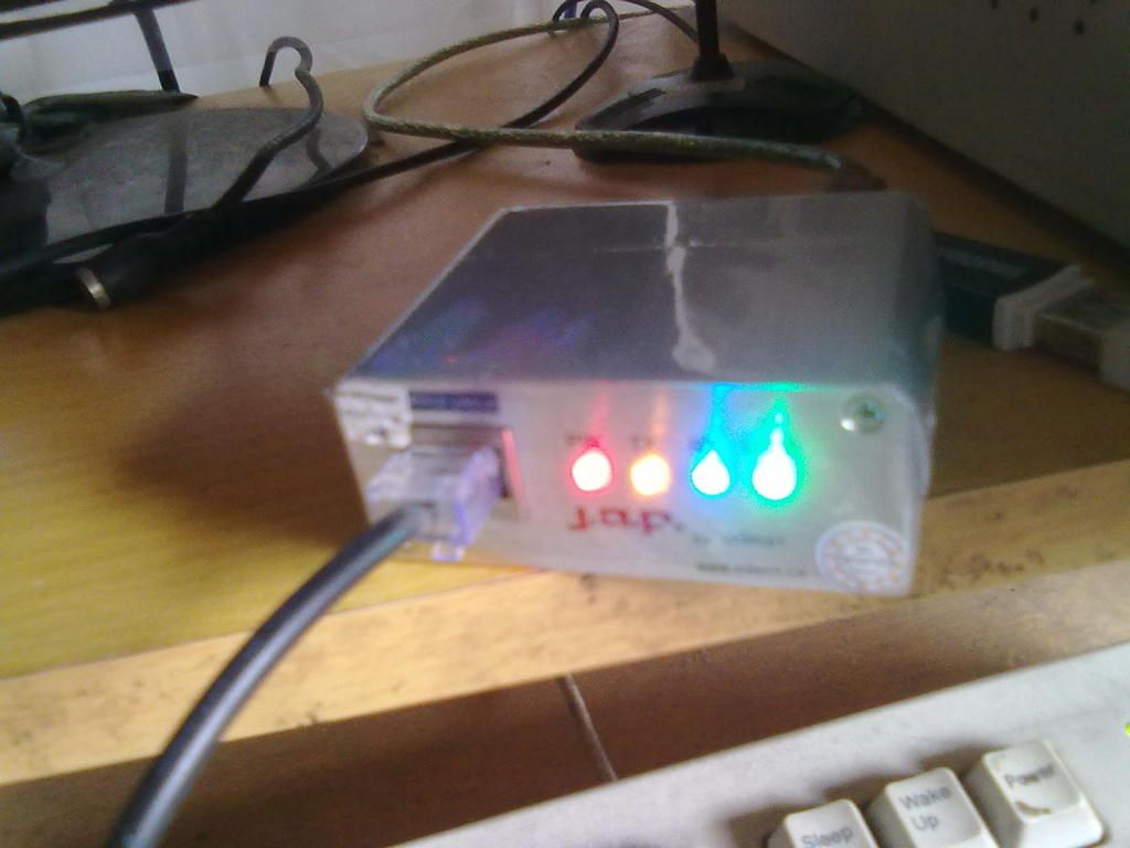

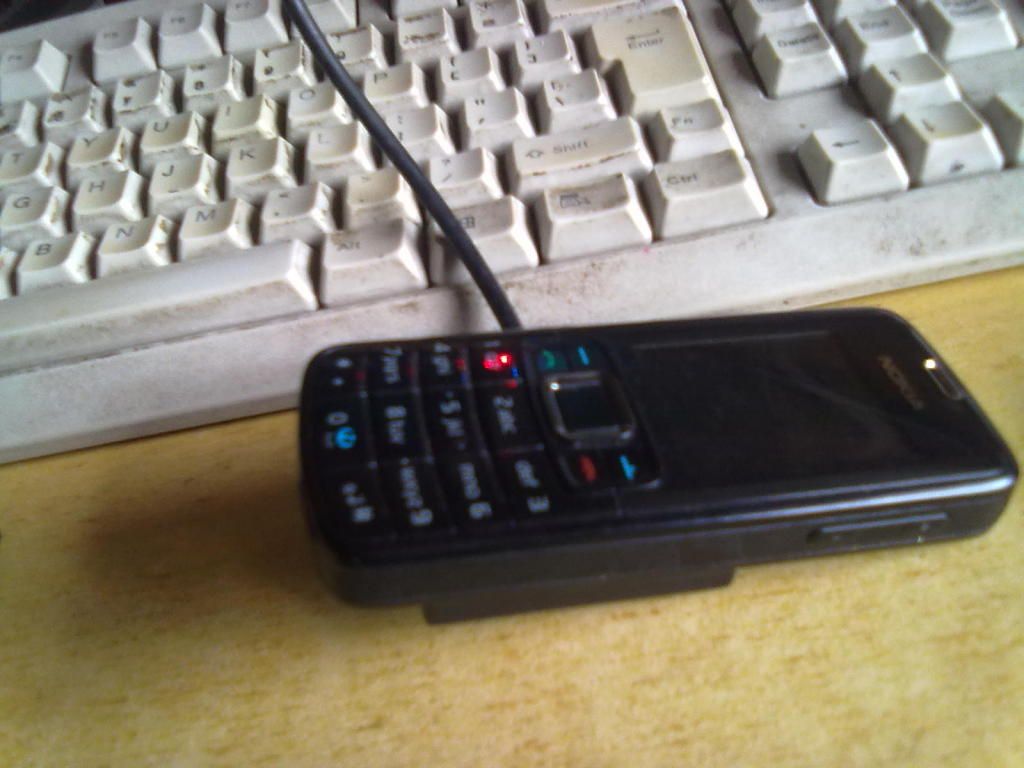

Procedures:
1. Go to bb5 tab
2. Select mcu, ppm & cnt files of rm-237
3. Click flash , wait till finished
4. Done!

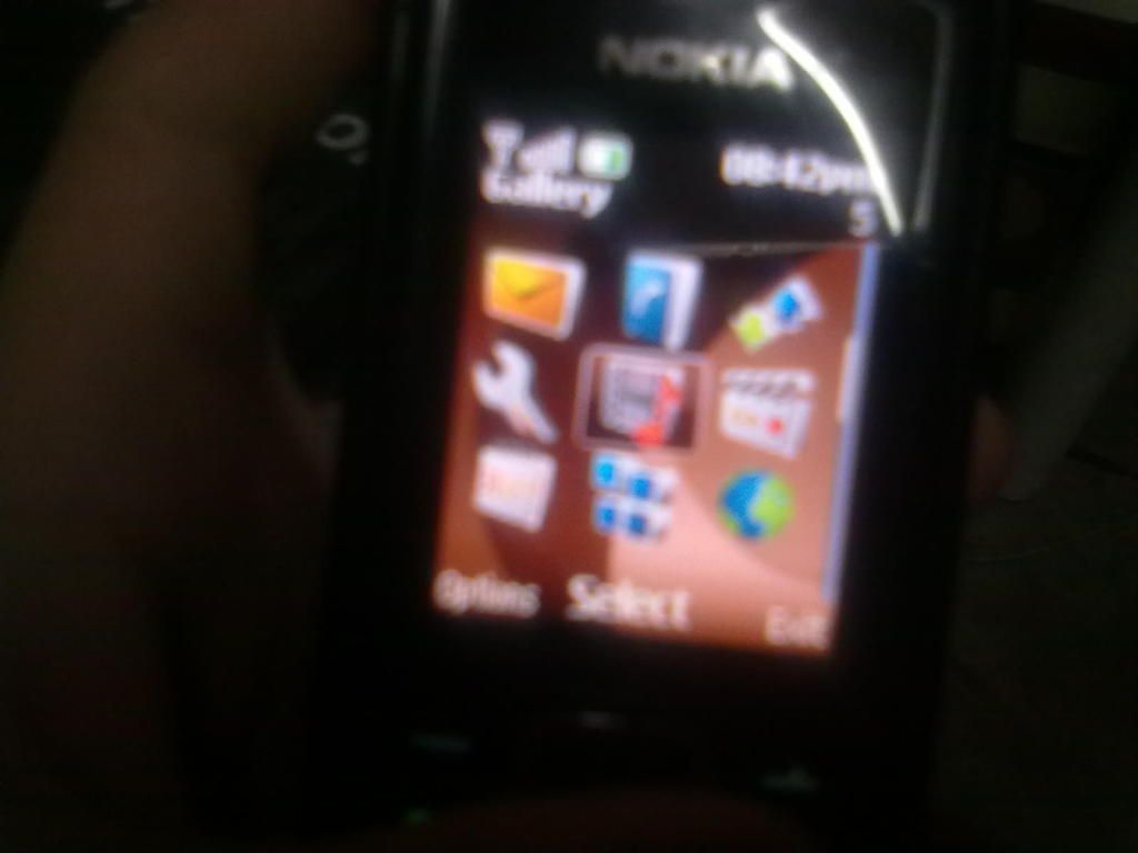

Reading...
Phone type: RM-237, Software version: 07.21
IMEI: 354161027108903
APE Ver: (null)
Variant Ver: (null)
Product Code: 0514947
Setting FULL FACTORY......Setting test mode...
Operation took 0 minutes 1 seconds...
Done!
