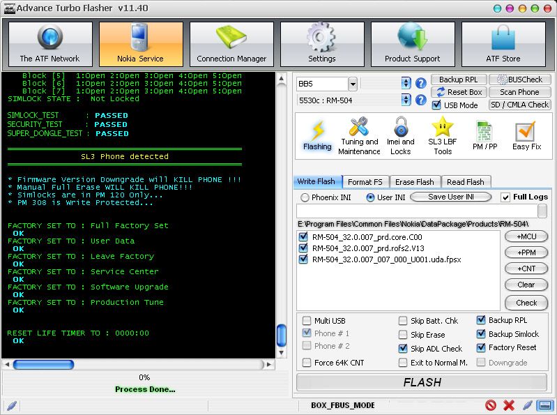

Nokia 5530c Flashing Done ATF
Tools : Micro USB cable
Procedure :
download Latest Firmware at the support
put designated file at the ATF flashing tab.
Tick Flash (wait a while till it finish)
16:33:16 : Number of Image Files: 3
16:33:16 :
16:33:19 : Processing Image File :
16:33:19 : RM-504_32.0.007_prd.core.C00
16:33:19 : CMT Type : BB5
16:33:19 : CMT Algorithm : XSR 1.5
16:33:19 : Secondary Sending Speed : 650000Hz
16:33:19 : Algorithm Sending Speed : 13000000Hz
16:33:19 : Program Sending Speed : 13000000Hz
16:33:19 : Message Reading Speed : 98000Hz
16:33:19 : Number of Blocks : 434
16:33:19 : Entry Point: 0x2670AB
16:33:19 : Page Format : -1
16:33:19 : MAX PAGE : 0x00040000
16:33:19 :
16:33:19 : RM-504_32.0.007_prd.rofs2.V13
16:33:20 : CMT Type : BB5
16:33:20 : CMT Algorithm : XSR 1.5
16:33:20 : Secondary Sending Speed : 650000Hz
16:33:20 : Algorithm Sending Speed : 13000000Hz
16:33:20 : Program Sending Speed : 13000000Hz
16:33:20 : Message Reading Speed : 98000Hz
16:33:20 : Number of Blocks : 100
16:33:20 : Entry Point: 0x00D7
16:33:20 : Page Format : -1
16:33:20 : MAX PAGE : 0x00040000
16:33:20 :
16:33:20 : Processing Image File :
16:33:20 : RM-504_32.0.007_007_000_U001.uda.fpsx
16:33:20 : Number of Blocks : 25
16:33:20 : Entry Point: 0x00D1
16:33:20 :
16:33:22 :
16:33:22 :
16:33:22 : AUTO SELECTED DEAD USB FLASHING...
16:33:22 :
16:33:22 : If Phone Booting does not Start in 5 Seconds,
16:33:22 : Then Perform Steps 1, 2, 3 and 4...
16:33:22 :
16:33:22 : 1. Remove USB and Battery...
16:33:22 : 2. Insert USB.
16:33:22 : 3. Insert Battery. (Some phones boot automatically)
16:33:22 : 4. Please Power on phone shortly...

16:34:09 : StartErase_DCT5...
16:34:09 : BlockLength : 0x5F (95)
16:34:09 : ERASE Blocks : 0x02 (2)
16:34:09 : 0 ERASE_AREA_BB5 0x12
16:34:09 : Block Length : 0x2B (43)
16:34:09 : BB ASIC Index : 0x00 CMT
16:34:09 : Device Type : 0x03 MuxOneNAND
16:34:09 : Device Index : 0x00
16:34:09 : 0 : 00040000-00082FFF
16:34:09 : 1 : 00083400-003FFFFF
16:34:09 : 2 : 00400000-007FFFFF
16:34:09 : 3 : 00800000-00D5FFFF
16:34:09 : 4 : 00D60000-09E5FFFF
16:34:09 : 1 FORMAT_PARTITION_BB5 0x19
16:34:09 : Block Length : 0x2F (47)
16:34:09 : Format Info ID : 0x00000000
16:34:09 : Format Info : 000000000000000A0000000000000002000000640000000300000001000000010000000000000000
16:34:09 :
16:34:09 : ERASE_REQUEST_BB5 : 5005120B0003000004000000082FFF120B00030000083400003FFFFF120B00030000400000007FFFFF120B0003000080000000D5FFFF120B00030000D6000009E5FFFFD5
16:34:10 :
16:34:10 : FORMAT_REQUEST_BB5 : 5001192F00030000000000000000000000000A00000000000000020000006400000003000000010000000100000000000000003E
16:34:10 :
16:34:10 : Successfully Erased...
16:34:10 : Total blocks to write : 434
16:34:10 : >> CMT Rootkey Hash CERT : ADA
16:34:10 : >> CMT Rootkey Hash CERT : KEYS
16:34:10 : >> CMT Rootkey Hash CERT : PRIMAPP
16:34:10 : >> CMT Rootkey Hash CERT : RAP3NAND
16:34:10 : >> CMT Rootkey Hash CERT : PASUBTOC
16:34:10 : >> CMT Rootkey Hash CERT : PAPUBKEYS [F2B05364E563A348608C1C3C9E54FE42AAAA1ACF]
16:34:10 : >> CMT Rootkey Hash CERT : SOS*UPDAPP
16:34:12 : >> CMT Rootkey Hash CERT : SOS*ENO
16:34:14 : >> CMT Rootkey Hash CERT : SOS*DSP0
16:34:15 : >> CMT Rootkey Hash CERT : SOS*ISASW
16:34:17 : >> CMT Rootkey Hash CERT : SOS+CORE
16:34:43 : >> CMT Rootkey Hash CERT : SOS+ROFS1
16:35:46 : ImagePath: E:\Program Files\Common Files\Nokia\DataPackage\Products\RM-504\
16:35:46 : ImageFilename: RM-504_32.0.007_prd.rofs2.V13
16:35:46 : StartErase_DCT5...
16:35:46 : BlockLength : 0x0E (14)
16:35:46 : ERASE Blocks : 0x01 (1)
16:35:46 : 0 ERASE_AREA_BB5 0x12
16:35:46 : Block Length : 0x0B (11)
16:35:46 : BB ASIC Index : 0x00 CMT
16:35:46 : Device Type : 0x03 MuxOneNAND
16:35:46 : Device Index : 0x00
16:35:46 : 0 : 07260000-0935FFFF
16:35:46 :
16:35:46 : ERASE_REQUEST_BB5 : 5001120B000300072600000935FFFF75
16:35:46 :
16:35:46 : Successfully Erased...
16:35:46 : Total blocks to write : 100
16:35:46 : >> CMT Rootkey Hash CERT : SOS+ROFS2
16:36:10 : ImagePath: E:\Program Files\Common Files\Nokia\DataPackage\Products\RM-504\
16:36:10 : ImageFilename: RM-504_32.0.007_007_000_U001.uda.fpsx
16:36:10 : StartErase_DCT5...
16:36:10 : BlockLength : 0x0E (14)
16:36:10 : ERASE Blocks : 0x01 (1)
16:36:10 : 0 ERASE_AREA_BB5 0x12
16:36:10 : Block Length : 0x0B (11)
16:36:10 : BB ASIC Index : 0x00 CMT
16:36:10 : Device Type : 0x03 MuxOneNAND
16:36:10 : Device Index : 0x00
16:36:10 : 0 : 09E60000-0F71FFFF
16:36:10 :
16:36:10 : ERASE_REQUEST_BB5 : 5001120B00030009E600000F71FFFF71
16:36:10 :
16:36:10 : Successfully Erased...
16:36:10 : Total blocks to write : 25
16:36:17 : ContinueFlash_DCT5 Complete
16:36:17 : Continue Flash Complete : : No Error - 0 (0x00)
16:36:17 : STATUS_REQUEST_BB5...
16:36:17 : 1 Sub Block ID : 15 STATUS_NAND_OK_BB5
16:36:17 : Block Length : 0F
16:36:17 : BB ASIC Index : 00
16:36:17 : Device Type : 03
16:36:17 : Device Type : 00
16:36:17 : Num Bad Blocks : 00000001
16:36:17 : Additional Bad : 00000000
16:36:17 : Correctable ECC : 00000000
16:36:17 : FlashInfo.RestartMode : 1
16:36:17 :
16:36:17 : Flashing Done...
16:36:17 : Total Flashing Time (Erase + Flashing) : 00:02:06
16:36:17 : (Booting time is NOT Included)
16:36:17 :
16:36:17 : Waiting for Phone to Start-Up..(Max 150 seconds)
16:36:17 :
16:36:32 :
16:36:32 : SW: V ICPR72_10w25.3 11-10-10 RM-504 (c) Nokia
16:36:32 : IMEI: 358307035927331
16:36:32 : CONFIG KEY : 0000000000000000
16:36:32 : PROVIDER KEY : 2440700000000000
16:36:32 : NETWORK NAME : Nokia Default;Finland
16:36:32 : LOCK COUNTERS : KEYPRESS 0/3, FBUS 0/10
16:36:32 : SIMLOCK TABLE :
16:36:32 : Block [1] 1:Open 2:Open 3:Open 4:Open 5:Open
16:36:32 : Block [2] 1:Open 2:Open 3:Open 4:Open 5:Open
16:36:32 : Block [3] 1:Open 2:Open 3:Open 4:Open 5:Open
16:36:32 : Block [4] 1:Open 2:Open 3:Open 4:Open 5:Open
16:36:32 : Block [5] 1:Open 2:Open 3:Open 4:Open 5:Open
16:36:32 : Block [6] 1:Open 2:Open 3:Open 4:Open 5:Open
16:36:32 : Block [7] 1:Open 2:Open 3:Open 4:Open 5:Open
16:36:32 : SIMLOCK STATE : Not Locked
16:36:32 :
16:36:32 : SIMLOCK_TEST : PASSED
16:36:32 : SECURITY_TEST : PASSED
16:36:32 : SUPER_DONGLE_TEST : PASSED
16:36:32 :
16:36:32 : ================================================
16:36:32 : SL3 Phone detected
16:36:32 :
16:36:32 : * Firmware Version Downgrade will KILL PHONE !!!
16:36:32 : * Manual Full Erase WILL KILL PHONE!!!
16:36:32 : * Simlocks are in PM 120 Only...
16:36:32 : * PM 308 is Write Protected...
16:36:32 :
