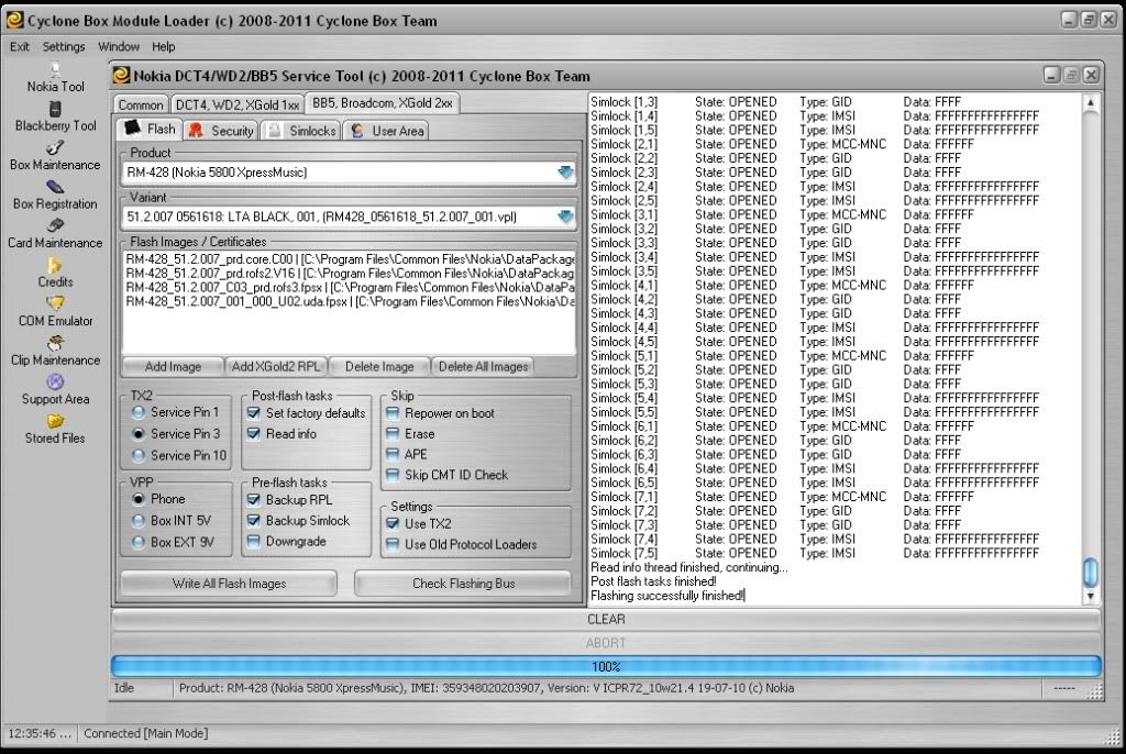

PROBLEM:
no power...
TOOLS:
cyclone box, ufc 4 cable...
PROCEDURE:
Code:
open cyclone,click read info tpos automatic na cya magselect ng flash files nka install sa drive C....then click write all images wait until finish...
Click here to view the original image of 769x515px.

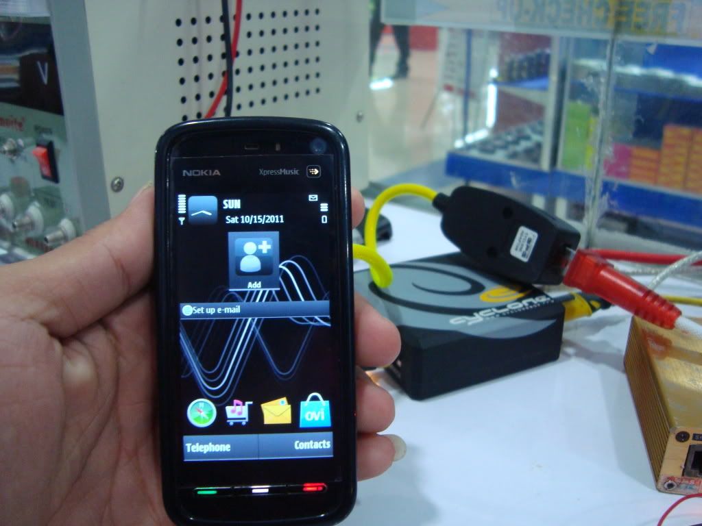

RESULT:
Click here to view the original image of 769x577px.
