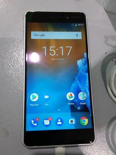

Nokia 6 (TA-1033) Google Account/FRP Lock Remove Done

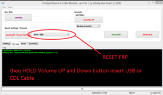

Procedure :
make sure install usb drivers sa folder ng CM2 QLM
* select RESET FRP
* then HOLD Volume UP and Down button then insert USB Cable or EDL Cable
* wait until Done
unit before
Finish na..
Done thanks God bless to all
