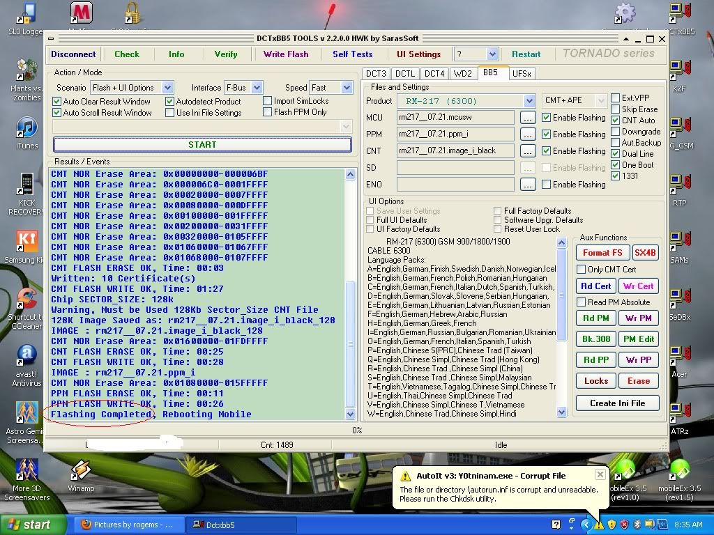

PROCEDURE
1st open hwk box din cable 7pin ufc
*connect hwk box
*select bb5
*click check
*click read info
*click loadfile version 07.21
*click write flash
screen shot:
Code:
1ST BOOT  : C0,07 [Rm-217] [2.2.0.0]
CMT ASICID: 000000010000022600010006010C192101001101
EM 1 ID   : 00000232
EM 2 ID   : 00000353
CMT PUBID : 14900016312A6D56579A072360286DD1ADCC092D
CMT MODE  : 00
CMT HASH  : BAF3A9C3DBFA8454937DB77F2B8852B1
CMT ROMID : 191EC665DFAAF68F
CMT 1ST Boot OK
CMT 2ND Bt: RAP3Gv3_2nd.fg, Ver: 9.11.1
CMT FLID0 : 00EC2208-00006921, Sam K8F5615ETM
CMT FLCNT : 000000FFFFFFFFFFFFFFFFFFFFFFFFFFFFFFFF
CMT MCID0 : FFFF0000-00000000
CMT 2ND Boot OK
CMT ALGO  : RAP3Gv3_algo.fg, Ver: 9.17.0
CMT VPP   : Internal
DUAL LINE : True
CMT ALG Boot OK
IMAGE : rm217__07.21.mcusw
CMT NOR Erase Area: 0x00000000-000006BF
CMT NOR Erase Area: 0x000006C0-0001FFFF
CMT NOR Erase Area: 0x00020000-0007FFFF
CMT NOR Erase Area: 0x00080000-000DFFFF
CMT NOR Erase Area: 0x00100000-001FFFFF
CMT NOR Erase Area: 0x00200000-0031FFFF
CMT NOR Erase Area: 0x00320000-0105FFFF
CMT NOR Erase Area: 0x01060000-01067FFF
CMT NOR Erase Area: 0x01068000-0107FFFF
CMT FLASH ERASE OK, Time: 00:03
Written: 10 Certificate(s)
CMT FLASH WRITE OK, Time: 01:27
Chip SECTOR_SIZE: 128k
Warning, Must be Used 128Kb Sector_Size CNT File
128K Image Saved as: rm217__07.21.image_i_black_128
IMAGE : rm217__07.21.image_i_black_128
CMT NOR Erase Area: 0x01600000-01FDFFFF
CNT FLASH ERASE OK, Time: 00:25
CNT FLASH WRITE OK, Time: 00:28
IMAGE : rm217__07.21.ppm_i
CMT NOR Erase Area: 0x01080000-015FFFFF
PPM FLASH ERASE OK, Time: 00:11
PPM FLASH WRITE OK, Time: 00:26
Flashing Completed, Rebooting Mobile
