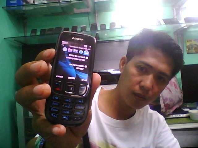

NOKIA 6303i BLUESCREEN SA FREESOFT

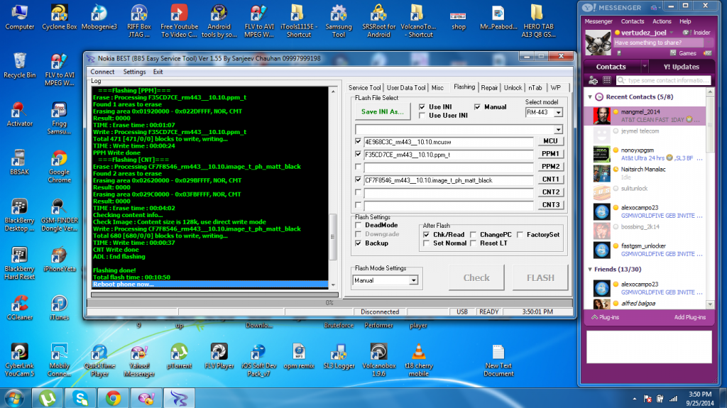

Tools:
micro usb
INFINITY BB5 CRACK
Procedure:
open infinity bb5 crack
load mcu,ppm,cnt
check dead mode
click flash insert usb wait done!
logs,
screen shot:
done,
prize ref, 250 pesos
Tools:
micro usb
INFINITY BB5 CRACK
Procedure:
load mcu,ppm,cnt
check dead mode
logs,
Code:
card found: A1B5CCE8
registered to: CycloneBox
Connect phone on selected interface...
Core : v1.51 , FlashEngine : v1.8
Selected FlashSettings : Manual
Check FlashFiles, Please, wait...
Files Set for Flashing :
MCU : 4E968C3C_rm443__10.10.mcusw
PPM : F35CD7CE_rm443__10.10.ppm_t
CNT : CF7F8546_rm443__10.10.image_t_ph_matt_black
Flashing phone now...
Check files done...
-> SWversion check skipped : Dead mode selected
Getting product info...
Dead Mode is Selected
Waiting for USB device...
--- Press phone's power button or insert cable & charger! ---
Connection opened successfully
Waiting for communication response.
ASIC ID: 000000010000022600010006030C192101033000
CPU ID : RAP3Gv3 , Features : No any extended features
RAP_PUB: 1410000BC23E7F56B4A09CBB5922304ABE7A74A7
CMT_ROOT: 9DDBFCFE6E73CED7D8C6268C8EB85723
PatchRAWLoader: Patched OK
Processing RAWLOADER...
Processing UPDAPP...
Processing PASUBTOC...
TIME : Boot time : 00:00:08
Reopening the connection...
Waiting for response: 30
ADL -> [2nd] changing...
ADL Server confirm flashmode!
ADL : Check data
ADL : Data accepted
ADL : ASIC CMT select Ok
===Flashing [MCU]===
Erase : Processing 4E968C3C_rm443__10.10.mcusw
Found 8 areas to erase
Erasing area 0x00000000 - 0x0001FFFF, NOR, CMT
Result: 0000
Erasing area 0x00040000 - 0x0005FFFF, NOR, CMT
Result: 0000
Erasing area 0x00060000 - 0x0007FFFF, NOR, CMT
Result: 0000
Erasing area 0x00080000 - 0x0015FFFF, NOR, CMT
Result: 0000
Erasing area 0x00160000 - 0x0023FFFF, NOR, CMT
Result: 0000
Erasing area 0x01740000 - 0x0191FFFF, NOR, CMT
Result: 0000
Erasing area 0x00240000 - 0x0173FFFF, NOR, CMT
Result: 0000
Erasing area 0x022E0000 - 0x0261FFFF, NOR, CMT
Result: 0000
TIME : Erase time : 00:03:14
Write : Processing 4E968C3C_rm443__10.10.mcusw
Total 1597 [1597/0/0] blocks to write, writing...
CMT : Writing Hash CERT [NOLO]
CMT : Writing Hash CERT [KEYS]
CMT : Writing Hash CERT [PRIMAPP]
CMT : Writing Hash CERT [PASUBTOC]
CMT : Writing Hash CERT [PAPUBKEYS]
CMT : Writing Hash CERT [UPDAPP]
CMT : Writing Hash CERT [DSP0]
CMT : Writing Hash CERT [MCUSW]
CMT : Writing Hash CERT [ISA+DYNSW]
TIME : Write time : 00:01:23
MCU Write done
===Flashing [PPM]===
Erase : Processing F35CD7CE_rm443__10.10.ppm_t
Found 1 areas to erase
Erasing area 0x01920000 - 0x022DFFFF, NOR, CMT
Result: 0000
TIME : Erase time : 00:01:07
Write : Processing F35CD7CE_rm443__10.10.ppm_t
Total 471 [471/0/0] blocks to write, writing...
TIME : Write time : 00:00:24
PPM Write done
===Flashing [CNT]===
Erase : Processing CF7F8546_rm443__10.10.image_t_ph_matt_black
Found 2 areas to erase
Erasing area 0x02620000 - 0x029BFFFF, NOR, CMT
Result: 0000
Erasing area 0x029C0000 - 0x03FBFFFF, NOR, CMT
Result: 0000
TIME : Erase time : 00:04:02
Checking content info...
Check Image : Content size is 128k, use direct write mode
Write : Processing CF7F8546_rm443__10.10.image_t_ph_matt_black
Total 680 [680/0/0] blocks to write, writing...
TIME : Write time : 00:00:37
CNT Write done
ADL : End flashing
Flashing done!
Total flash time : 00:10:50
Reboot phone now...
done,
