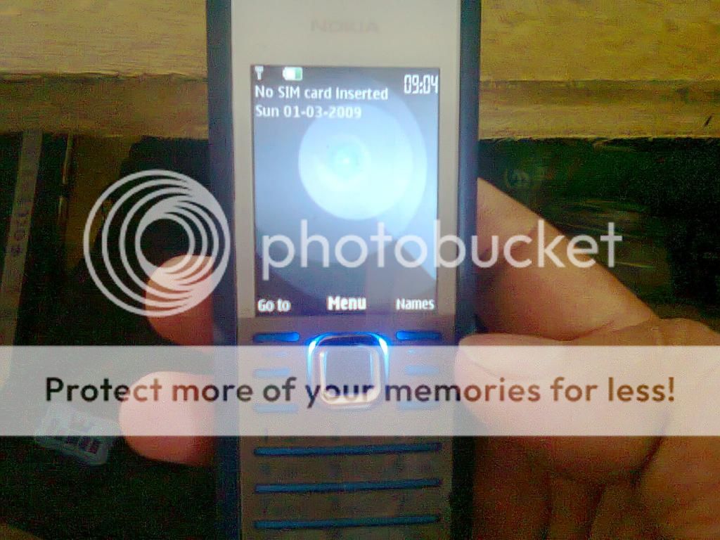

Unit/Model:
- Nokia 7210C
Problem:
- Contact Service
History:
- Bigla lang daw sabi ng may-ari.
Action Taken:
- Check sa cyclone ganito cya:
Phone have failed SIMLOCK Test, that means Simlock Area is DAMAGED!
To repair simlock area, Select Unlock method : "RPL CALCULATION",
And then click DIRECT UNLOCK. SL Area will be re-formatted
- so ginawa ka lang ung tips na binigay ng cyclone.
1. go to bb5 tab
2. click simlock tab
3. choose RPL calculation
4. hit Direct unlock and problem solve.

Unlock finished! Time taken 5.804s
Finish product:
tanx for viewing..
