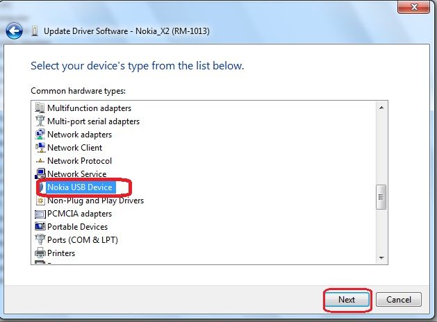

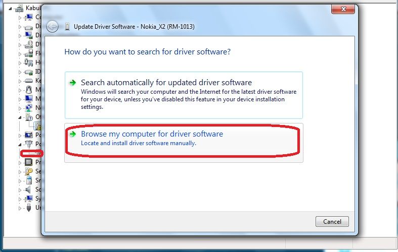

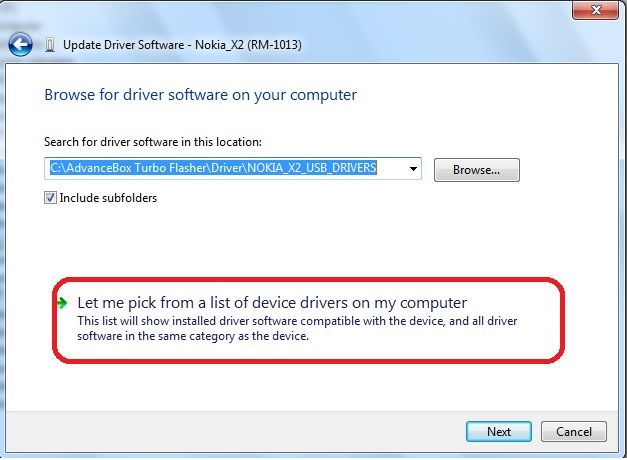

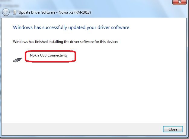

Install EmergencyDownloadDriver located at C-ADVANCE FOLDER-DRIVER-NOKIA X2 USB DRIVER

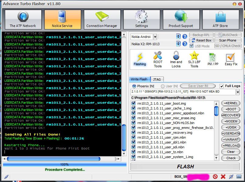

RUN Advance box exe
Select NOKIA ANDROID TAB (make sure you have firmware) or download here
Click FLASH
HOLD VOLUME DOWN and connect USB to PHONE /PC
NOTE: Kung ayaw mag-connect kahit na-install na ang driver, Uninstall mo ulit ang ZEAUS DRIVER at QHSUSB_BULK
Follow pictures below

boss help po nito, nag flash ako
sa V11 ganto
hanggang jan lang talaga siya
pag v13 naman
hanggang sa system user 6, kahit extract ko ulit yung firmware same parin.
status deads na pero still detected dati hang lang.
