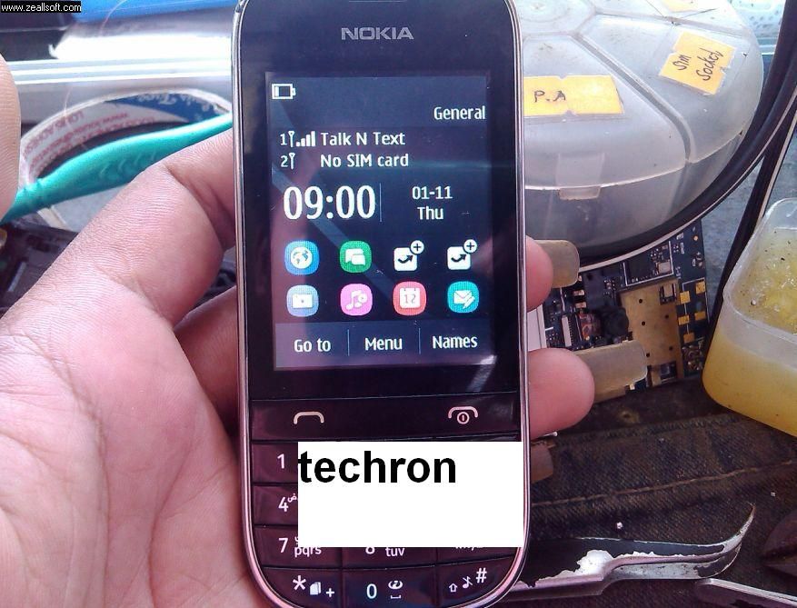

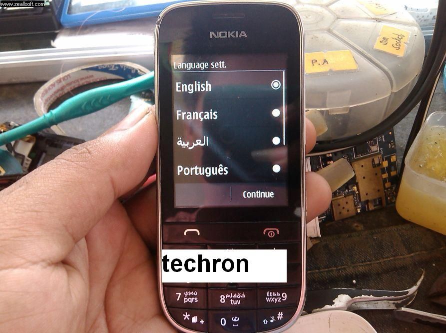

Auto Off Problem Done by mxkey Dongle
History: (common) Bigla lang daw
Tools: Mxkey Dongle & Micro USB (5310 USB)

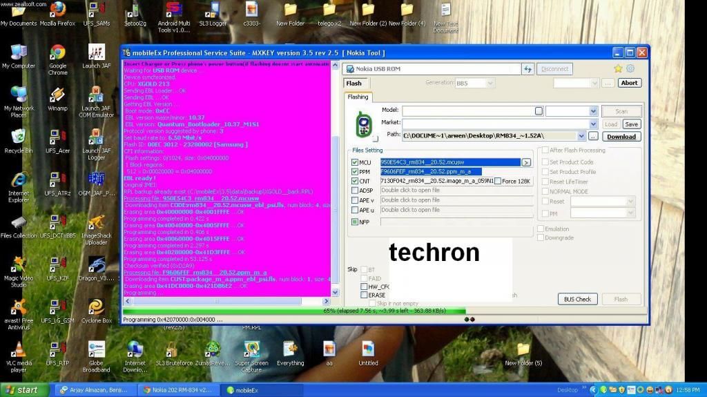

Action Taken: Write Full flash Done
Code:
Waiting for USB ROM device ...
Device synchronized.
CPU: XGOLD 213
Sending EBL Loader...OK
Sending EBL ...OK
Getting EBL Version ...
 Boot mode: 0xCC
 EBL version major/minor: 10.37
 EBL version: Quantum_Bootloader_10.37_M1S1
Protocol version suggested by phone: 3
Set baud rate to: 6.50 Mbit/s
Flash ID: 00EC 3012 - 23280002 [Samsung ]
CFI information:
 Flash settings: 0/1024, size: 0x04000000
 1 Block regions:
  512 x 0x00020000 = 0x04000000
EBL ready !
Original IMEI:
RPL backup already exist (C:\mobileEx\3.5\data\backup\XGOLD__back.RPL)
Processing file: 950E54C3_rm834__20.52.mcusw
 Downloading item CODE:rm834__20.52.mcusw_ebl_psi.fls, num block: 4, size: 28 MB
Erasing area 0x40000000-0x4001FFFE ...OK
Programming completed in 0.422 s
Erasing area 0x40040000-0x4005FFFE ...OK
Programming completed in 0.406 s
Erasing area 0x40060000-0x4015FFFE ...OK
Programming completed in 2.297 s
Erasing area 0x40280000-0x41D3FFFE ...OK
Programming completed in 53.125 s
Checksum verified (0xD2A9)
Processing file: F9606FEF_rm834__20.52.ppm_m_a
 Downloading item CUST:package_m_a.ppm_ebl_psi.fls, num block: 1, size: 4.11 MB
Erasing area 0x41DC0000-0x421DB6E2 ...OK
Programming completed in 11.282 s
Checksum verified (0xBBFE)
Processing file: 7130F042_rm834__20.52.image_m_a_059N1K4
 Downloading item CUST:package_m_a_059N1K4.image.fls, num block: 1, size: 12.75 MB
Erasing area 0x424C0000-0x43E1FFFE ...OK
Programming completed in 30.062 s
Checksum verified (0x0A6E)
Total time for flashing process(boot+erase+write) was 5 min 10.234 s

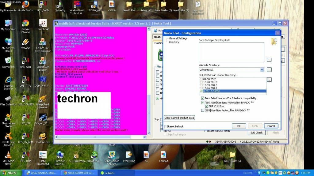

Waiting for USB device removal ...
Waiting for device boot up ...
Device connected: nmwcdc\Nokia USB Phonet, PORT_ID: 307326B9
Verifying communication to device OK.
Phone type: RM-834 (202)
SW version: V 20.52 27-09-12 RM-834 (c) Nokia
Imei plain: 35457105873504-6
Product code: 059M694
Language Pack:
- not available.
SLPA ver[4]: PA_SL3/PA_SIMLOC30 (15 digit NCK)
warning: avoid SW Downgrade & manual erase to this phone !
Camera config: 115B6002004020, ver:
SIMLOCK seems to be valid
SUPERDONGLE_KEY invalid!
- WD timer enabled, phone will reboot itself after 3 min.
SIMLOCK_TEST passed
SECURITY_TEST passed
Imei net: 35457105873504
Version: SIMLOCK SERVER
Provider: GSM Test Operator
Counter: 0/3, 0/10
CONFIG_DATA: 0010100000000000
PROFILE_BITS: 800000000003000B
BLOCK1: 1=OPEN, 2=OPEN, 3=OPEN, 4=OPEN, 5=OPEN
BLOCK2: 1=OPEN, 2=OPEN, 3=OPEN, 4=OPEN, 5=OPEN
BLOCK3: 1=OPEN, 2=OPEN, 3=OPEN, 4=OPEN, 5=OPEN
BLOCK4: 1=OPEN, 2=OPEN, 3=OPEN, 4=OPEN, 5=OPEN
BLOCK5: 1=OPEN, 2=OPEN, 3=OPEN, 4=OPEN, 5=OPEN
BLOCK6: 1=OPEN, 2=OPEN, 3=OPEN, 4=OPEN, 5=OPEN
BLOCK7: 1=OPEN, 2=OPEN, 3=OPEN, 4=OPEN, 5=OPEN
Market items is empty, please select the correct products path !
done
