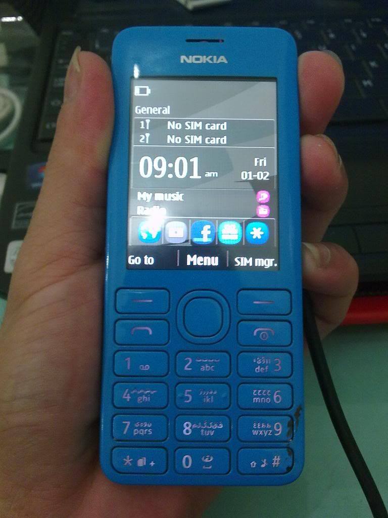

Nokia asha 206 rm-872 No power / vibrate only Done..by cyclone....

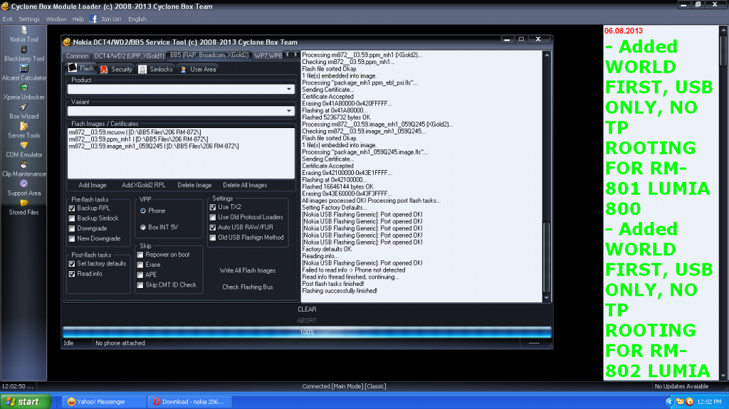

ACTION TAKEN: Flash unit Using cyclone...
procedure:
Open cyclone select Nokia USB ROM
Click the star select Nokia Service Tool
Input flash file MCU, PPM, & CNT
* Tick Flash
* wait until Finish........
Modifying USB / Pin out.....
after flash done,ito po logs...
