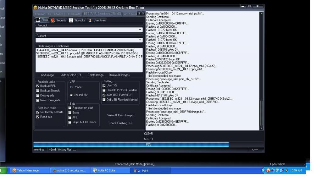

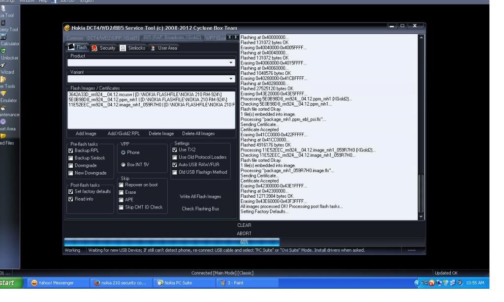

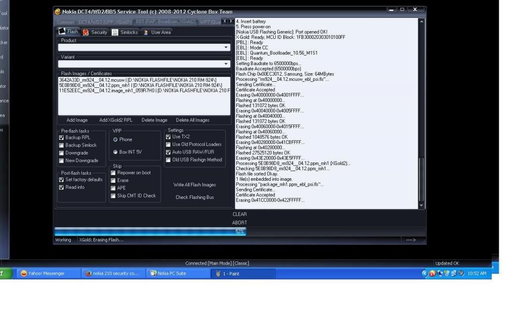

PROCEDURE

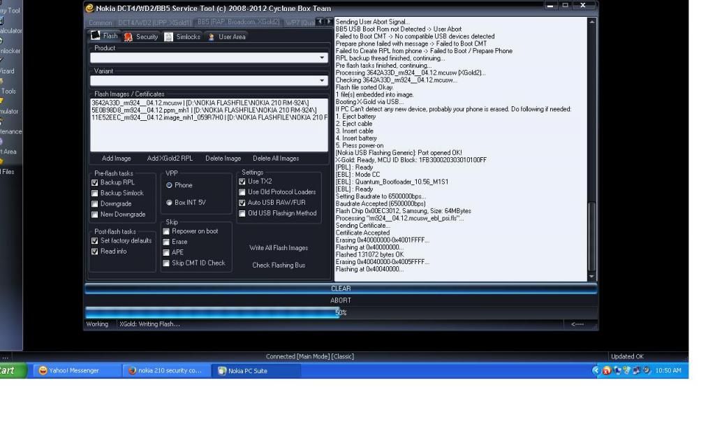

1. Open Cyclone
2. Click Nokia Tool
3. Click Connection and select USB
4. Click BB5 (RAP, Broadcom, XGold2)
5. Click Add image....(mcu ppm cnt) and click Write All Flash Images

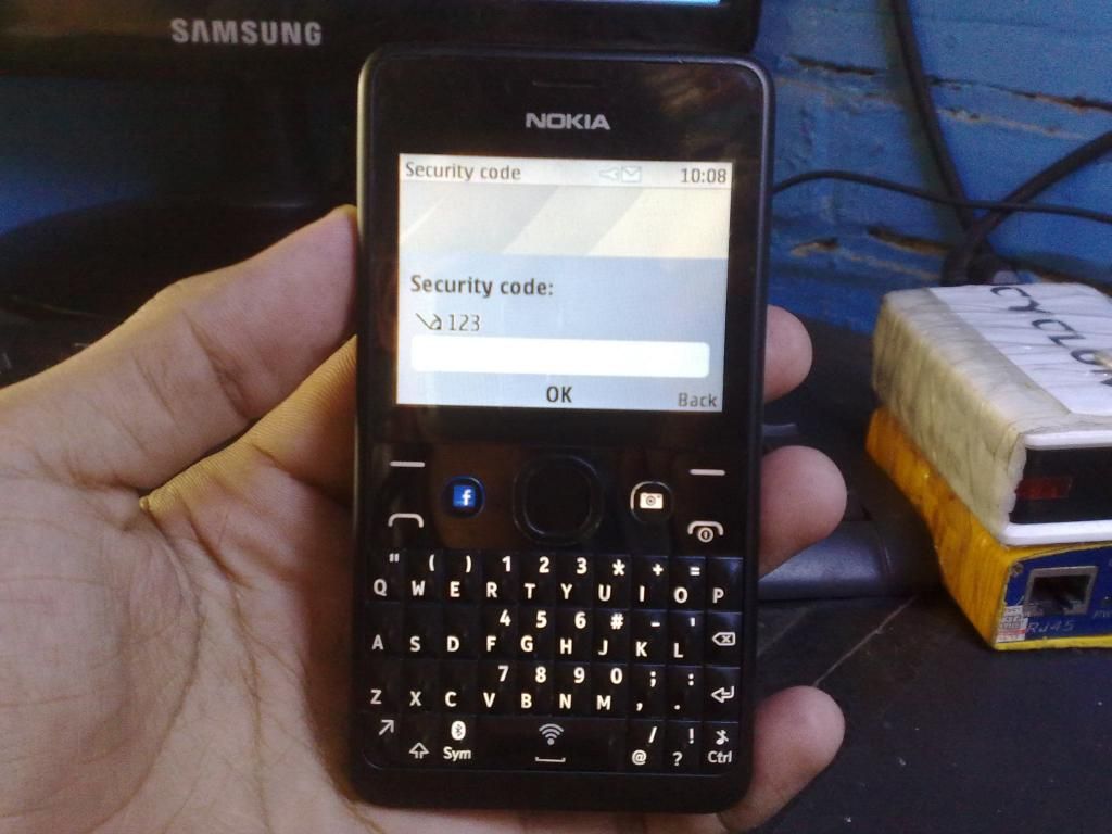

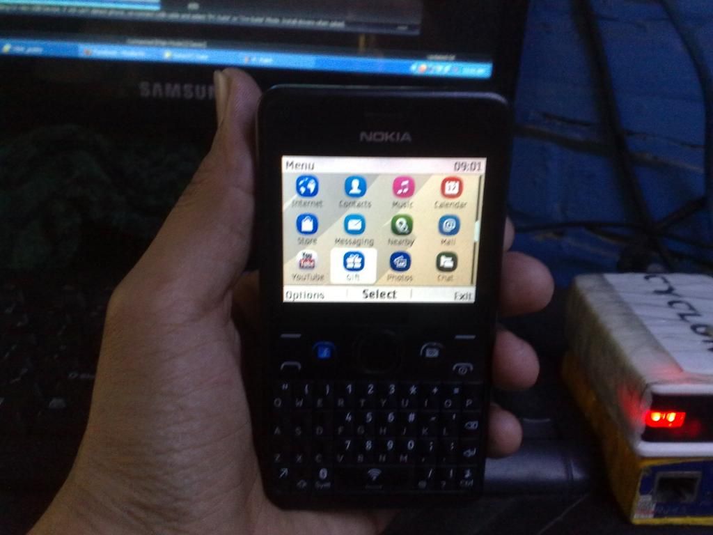

SCREENSHOTS:

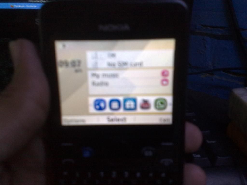

TM Sim po yan..pasensya na malabo kuha:D

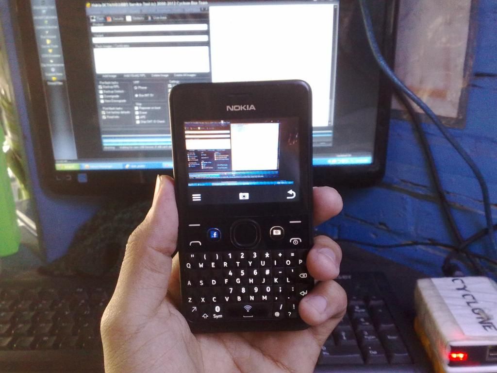

Camera Test
