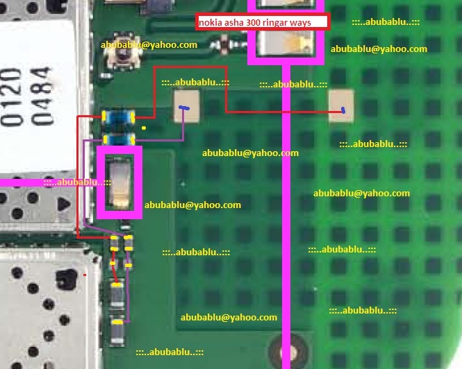

Problem:Nokia Asha 300 Ringer Problem,Nokia Asha 300 Buzzer Not Working Problem.
[FONT=&quot] Solution: To solve buzzer problem in nokia Asha 300 first check on screen that handsfree not appear, then disassemble the mobile and change ringer with new one.If problem not solved then check ringer points if there is zero continuity then observe diagram carefully and do jumpers like diagram as shown below.[/FONT]
